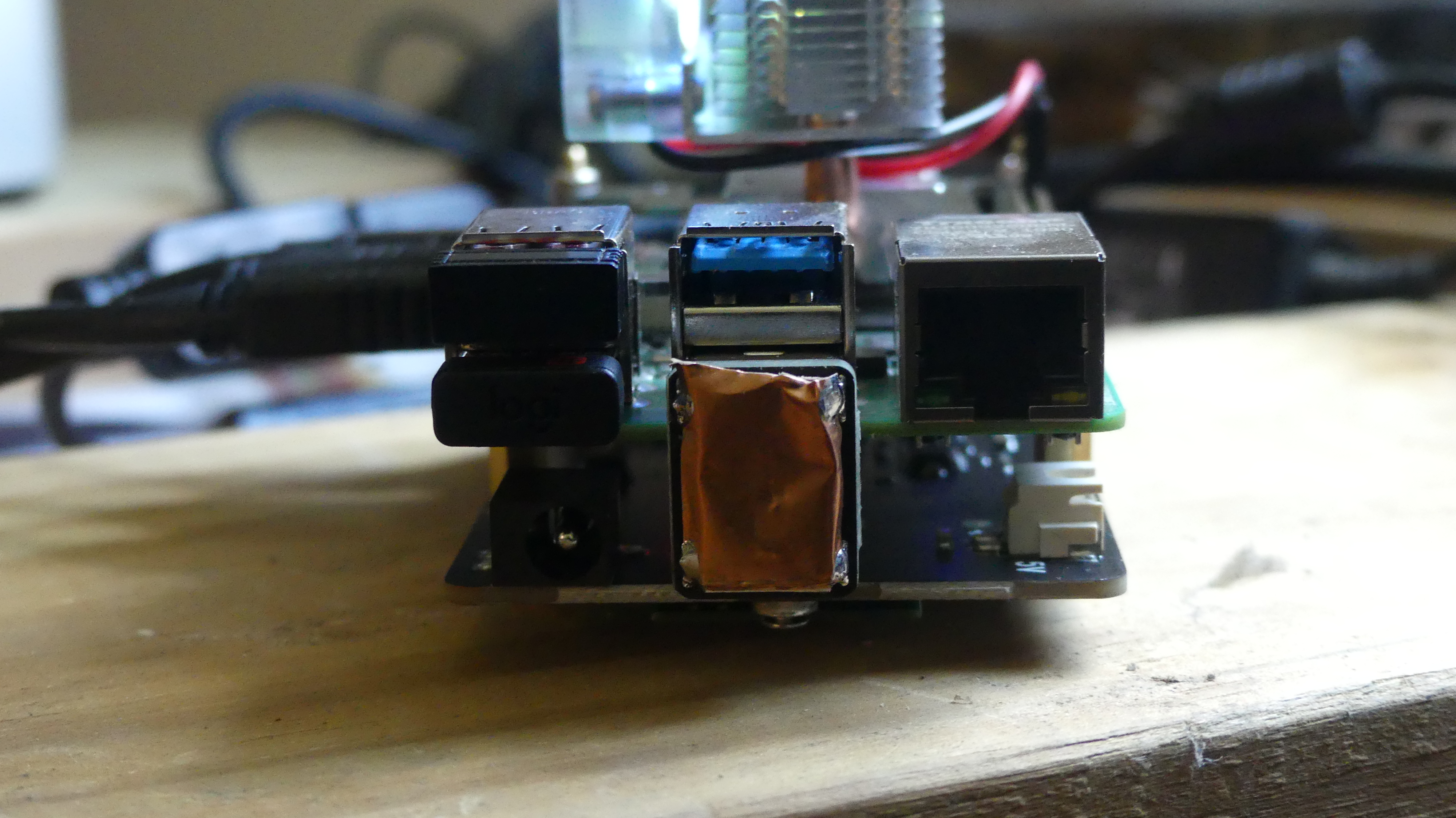

I'd add a pic of it, and might later on, but it's pretty much like the one at amazon link above for the cooler, and it's not running just now. Here's another video on the SSD adapter. It's very neat mechanically. I think that unshielded trick USB U-turn adapter is the source of the RFI, and I'm going to shield mine (and I'll report if that works, or what it takes - this is not the first time something USB3 has jammed up 2.4 ghz stuff).

Posting from that pi. Shielding that USB kludge was no good. Creating a conductive bottm plate (because it was easy) also no good - made things worse. Did some short grounding from the tops of those standoffs to USB and Ethernet jacks at the front - worst of all. Super high frequencies are .. always interesting, and I didn't want to spend the time to do it "right" with "tiny fractions of a wavelength grounding" and so on, with no incidental "slot antennas" if that's even possible.
Seemed like a good idea at the time - you can also do it "wrong" and get lucky with cancelling radiations from different parts of a thing, and I just want this to work, not picky about how I get there.
Here's what I did for that connector - there's a bit of cardboard from a beer carton under the copper tape. This pointed up the fact I haven't transferred all my nifty tricks to here yet - like new file templates that do most of the boilerplate for various things, and a nice script for the file manager that shrinks jpegs down to size for this, hence the ridiculous unneeded res here. I'll get there. I did have to add exfat stuff via synaptic to eat my camera output. No biggie.
Oops. I don't have my auto-compressor script here yet.
As with other radiation, though, inverse square law is your friend. A little USB hub on a 6" lead danging from the mess with the wireless dongles in it solves all, better than ever. Ugly. Sigh.

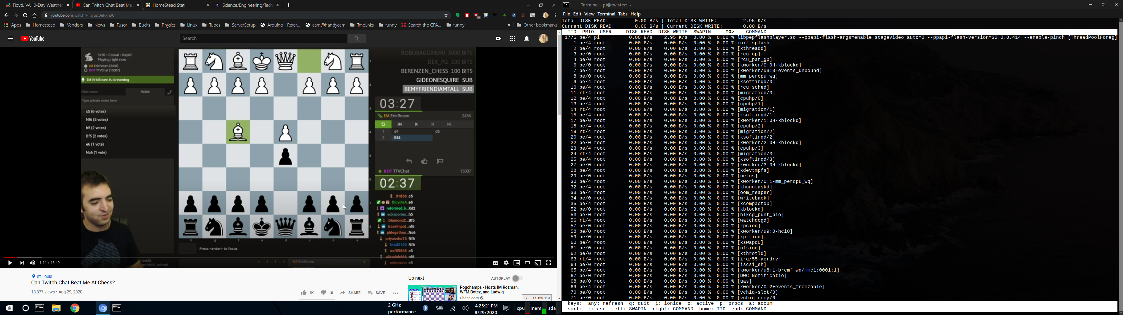

For fun, EricR plays against the twitch hive while I watch chrome destroy the SSD via iotop.
I didn't really catch it in the act, but even when paused, there are around 4 lines popping up of some chrome subprocess writing in the 150kb/sec range apiece. WTF? No wonder pies kill SD cards.
