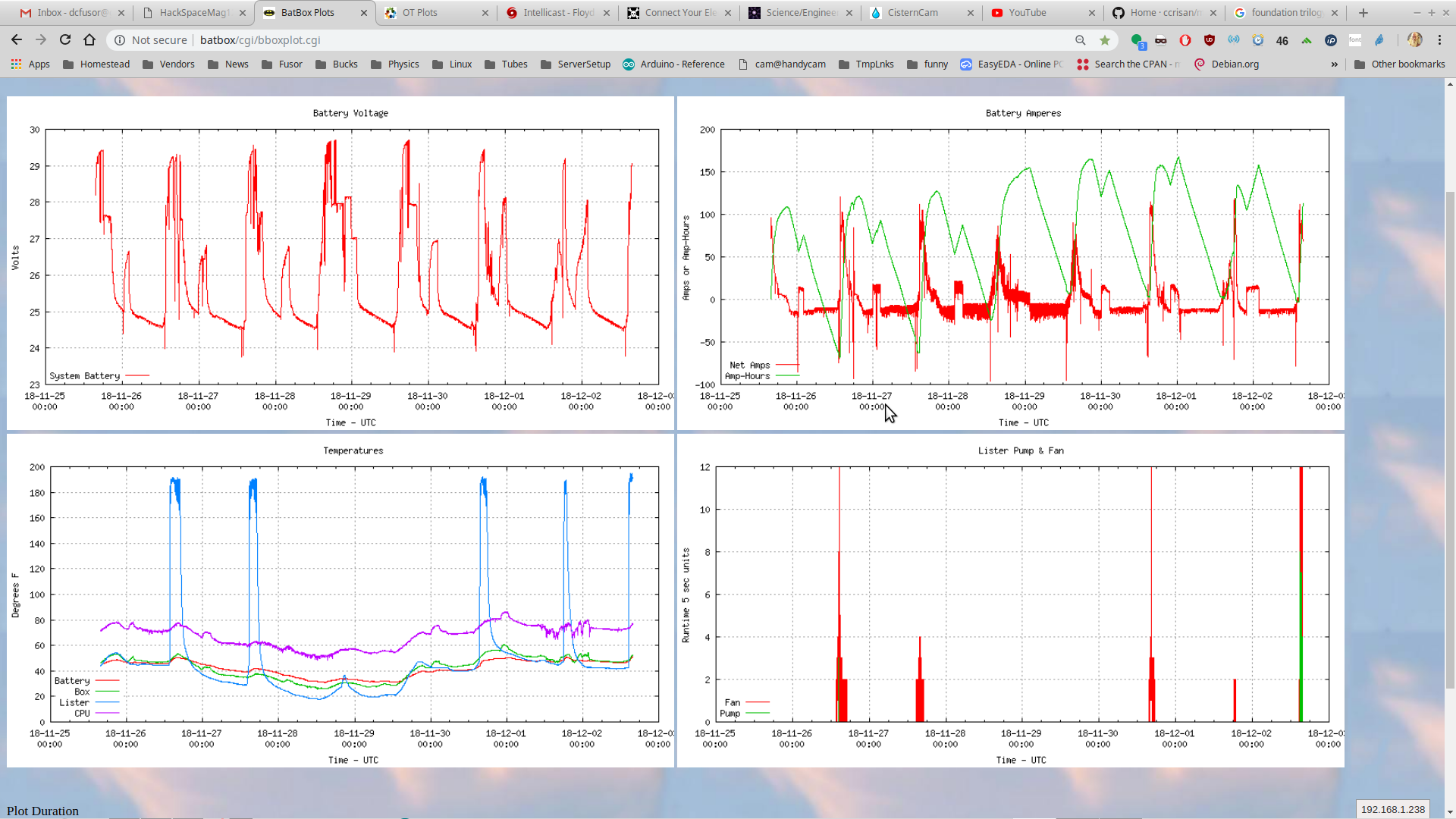

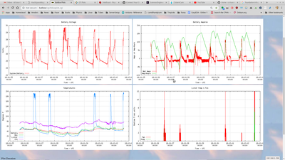

Here's a pic of last week's data - on a couple of cold nights, the noise on the ampere plot is larger than the actual power usage, which makes it kind of hard to find the odd thing I left turned on by accident and so on - I depend on this stuff to help me manage the system.

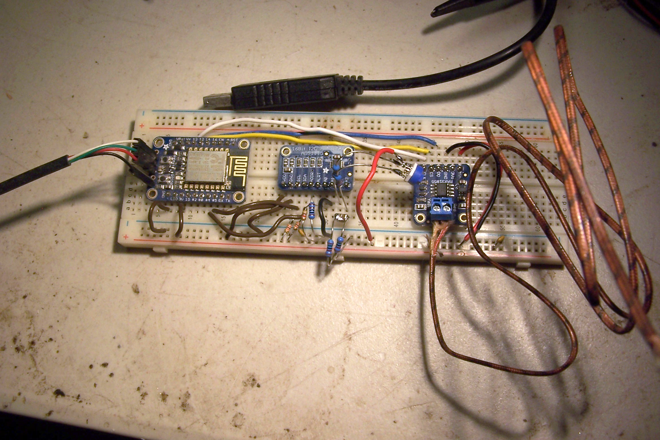

Step one - really the easy one - is to make the battery monitor replacement described here. I had bought a bunch of Adafruit Huzzah ESP8266 modules, which are kind of stripped down from - no USB interface for example, and there they are sitting in in the toy box. Would be easy to replace if needed with just a bare module and a 3.3v regulator...but I have plenty of these. Doggone early adopter habits. This can make the basis of a remote volt and ampere monitoring device, so here it is. While at it, I also measure two temperatures, roughly that of the box itself, and the batteries.
I'm trying to avoid the situation that made the old one start to fail...I have a shunt of one milli-ohm in the negative battery lead. The A/D I was using did have some below ground common mode range, and some inbuilt DSP filtering for noise on the differential input I was using. However, as it turns out, with some huge ampere peaks (a 24v system that can have 50kw or more peaks...) things get out of that common mode range...and when it gets cold - as now - it turns out that clock drift can move the DSP filter notch away from where the noise is (60hz nominal). So while it hasn't yet failed, the plots are starting to look pretty nasty and it's time to do this.
The new setup uses this ESP8266-12 module, an ADS1115 16 bit 2 channel differential a/d converter (on I2C), and a MAX 81355 thermocouple breakout (on SPI). This time I put a real analog filter on the current inputs, and some divider R's to get things up closer to the middle of the common mode range...which of course leads me to a yet unsolved problem of how to encapsulate that set of components to keep them temperature equalized and dry, since even a 10 meg ohm leakage in the wrong place is enough to upset this reading. (any advice gladly accepted there - encapsulation can be a black art with tempcos and leakages and...).
Here's a pic of the prototype - you almost don't need a schiz with what I've said and pictured here, but I'll get one up at some point. Some pinout info is in the software itself. I like to put things like
that in the comments up front for my later use - I'm the poor slob who has to make it work again later...
This will go on some perfboard along with one of those inexpensive simple switchers and an on off switch connected to the main battery bank - one of the world's better UPS systems.

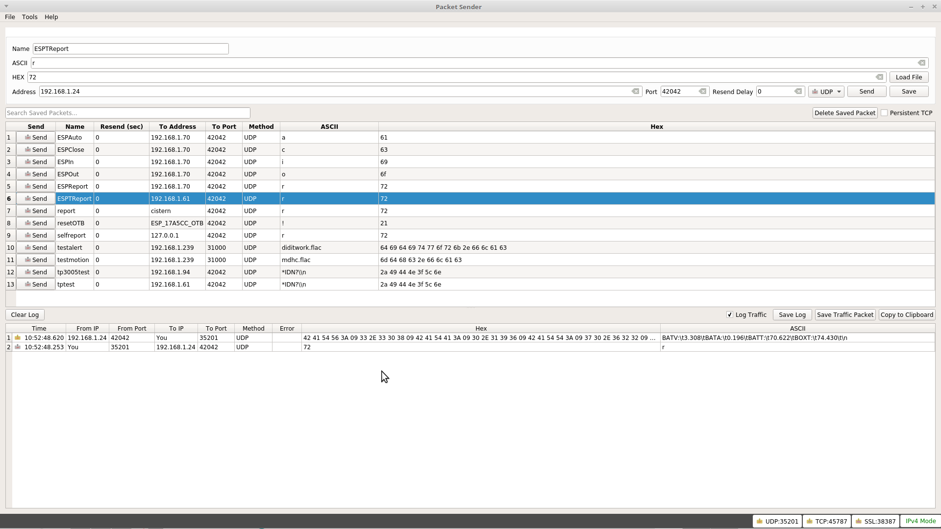

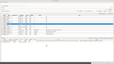

For grins, I just powered the thing up on my living room floor and sent it an 'r' using a nice (free) tool called PacketSender. The sent r and the received data are shown in this screenshot.
Packet Sender is a super nice free tool for this work.
Right now it's just measuring its own power supply...and I didn't let the amp filter settle before doing this or it'd look nicer. Units are Volts, Amps, degrees Fahrenheit, as well, 'Merica. Even so, a hundred ma error doesn't kill me - nighttime draw here is ~~ 14 amps if I'm careful (that turbo pump and all these other always on things like file shares). Amp sized errors, or in the case shown - 10's of amps, even if they average out ok, are a problem for finding that I left something turned on at night that I shouldn't have, some generation system is having an issue and so on, hence the need for this.
So here we have what might be the simplest possible example of what seems to be a real good way to get things like this done. I do have to generate a name for "tellem" in the slave unit code, and due to how the ESP library code works, I don't have a ton of choice if I want it to not be too confusing when the "official" stuff also happens to work (rarely) - they generate a hostname that is ESP_XXXXXX - which X's are the last hex of the MAC address. I will regenerate that and add an underscore and unit name (in this case _BAT) to go into the hosts file.
