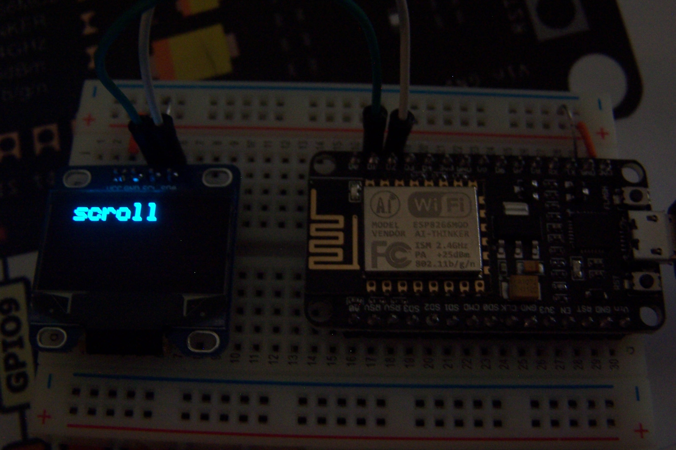

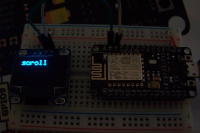

Here it is running part of the Adafruit demo stuff on a NodeMcu ESP 8266-12e board (my current favorite for low effort development vs price).

The SSD1306 header file needs to be edited to make the 128x64 device the defined one - you have to comment out the smaller one and remove the // from this size.
The example file needs the I2C address changed to 0x3C (it's 3D by default).
If you're going to use this on an ESP 8266 (barely works on an uno anyway - it works but there's not much memory left to do your thing) - you need to change the OLED reset (which isn't actually needed at all with this part) #define from pin 4 to pin 16. If you don't do that, it's not gonna work as the pin4 seems to generate a stream of resets to the CPU itself on the ESP boards....You can chase your tail awhile on that one, the other changes are on Amazon and elsewhere.
I suppose you could edit the library to just not need that reset action at all. But then it wouldn't work with a bunch of other things Ada sells, for example.

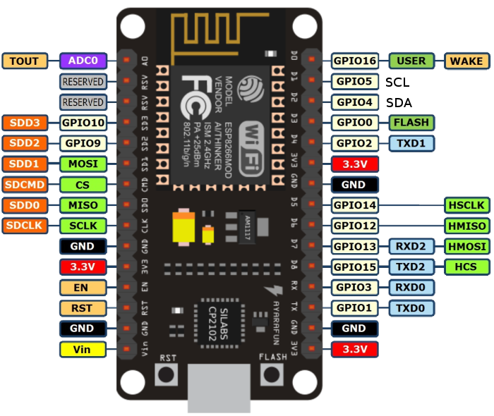

Might find this helpful...NodeMCU 12e pinouts, including the default SCL and SDA for I2C added by me. When that pin 4 (circular reset?) bug was showing, a lot of pins were toggling, so it was hard to be sure which were supposed to be the I2C pins...I used "the gimp" to add that to an image I found on the web.
In theory you can change these. However, due to the design of the driver libraries, it has to be done inside them - as they call Wire.begin themselves - with no parameters...sigh.
Some of this stuff is OK for simple breakouts, but it's obvious as time goes on that this doesn't represent the pinnacle of reusable software design. The neckbeards do it better especially if they don't have the time pressure. This all would have been a lot simpler had someone thought to use #defines or just constructor parameters in the user sketch or some similar mechanism. Editing libraries is not a good thing to do, especially when they depend on one another. How are you going to keep track of that in a complex dev environment that might use more than one display hardware type?
Notice that just to be extra confusing, where the arduino uno uses A4 and A5, this uses GPIO4 and 5 (digital). The board silkscreen maybe is the pins for the tensilica? The nice external labels here are what works with your arduino IDE stuff.
