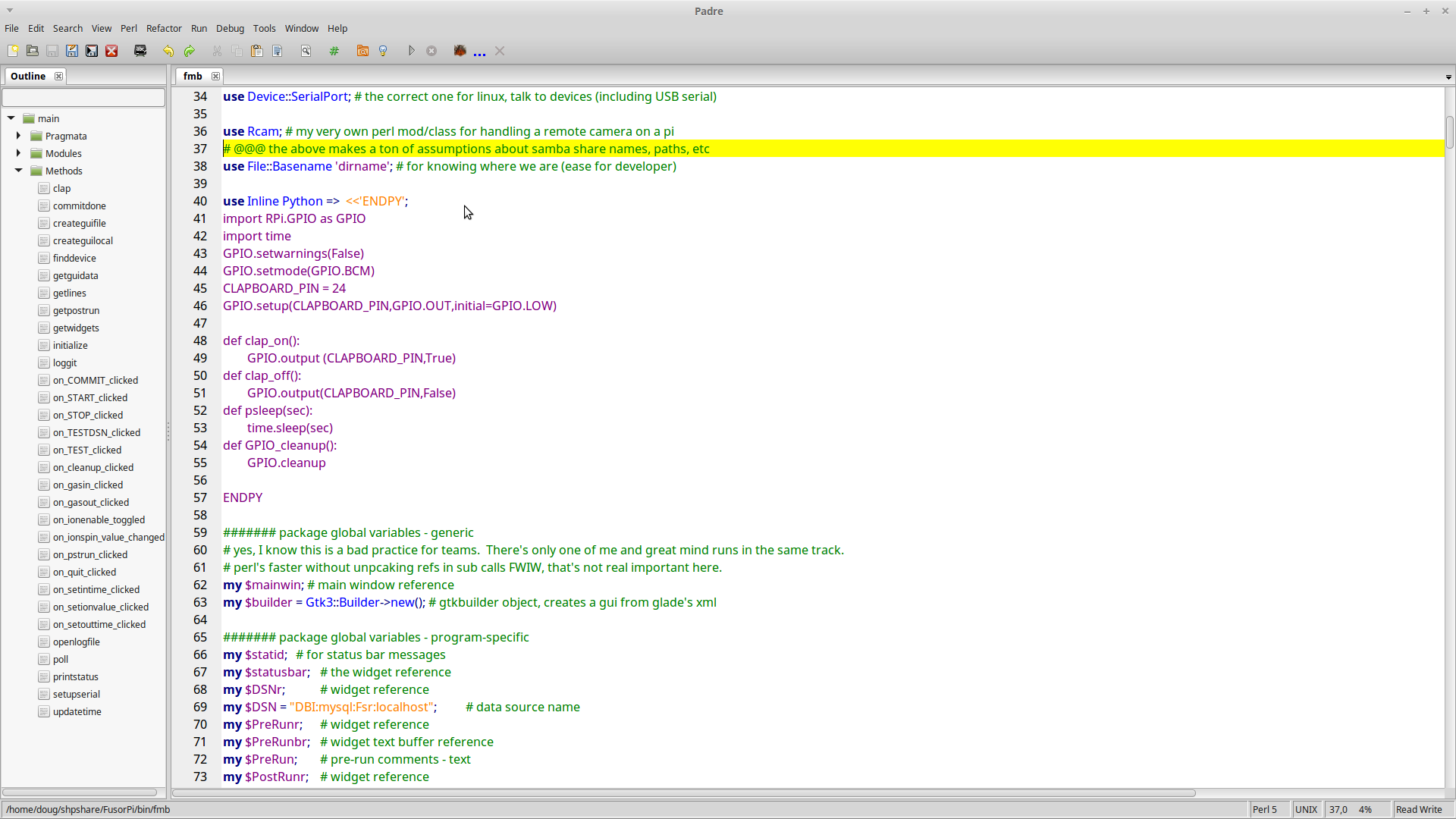

I'm so dumb I even used some python inline (from Adafruit) as the perl lib for i/o, used here to create the clapboard signal mentioned elsewhere, was a pain to get working right, so...punt.
Here's some gratuitous screenshot action from padre:
So, the above is my master control panel, so to speak, for the raspberry pi nearest the fusor (there are a couple more that are used as video cameras). Fast enough, and cheap enough not to care too much if I happen to fry one.
