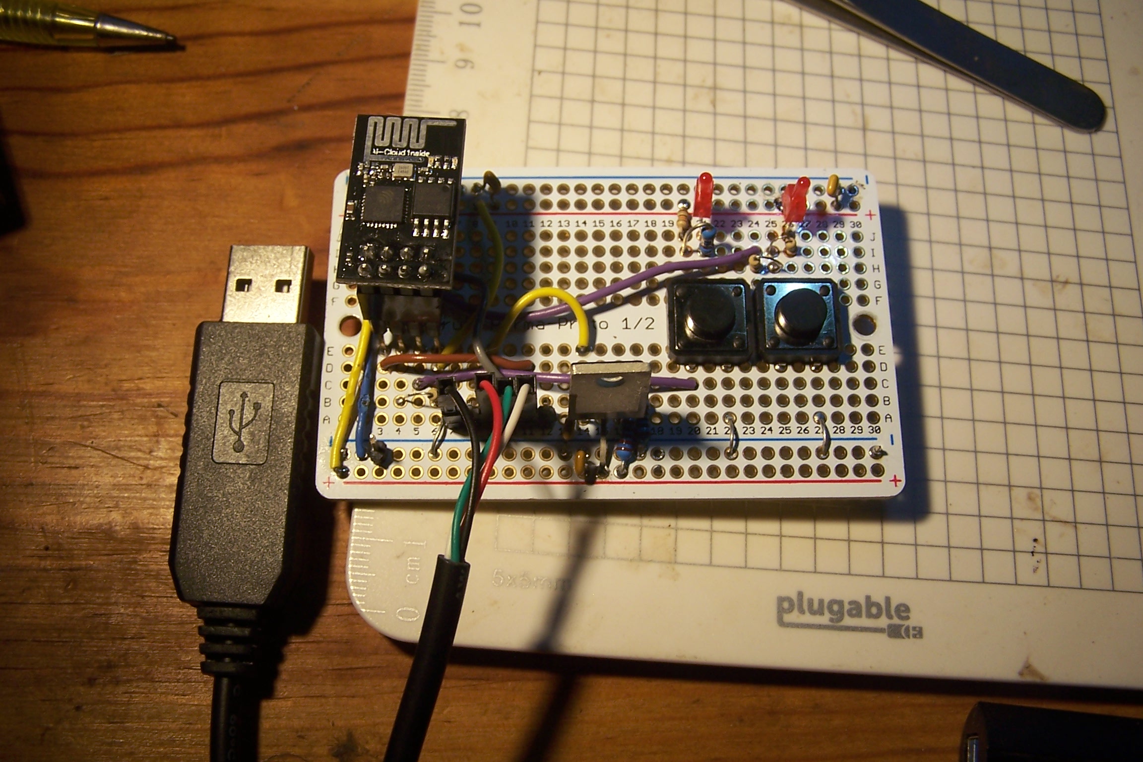

I built a programmerloosely based on this guy's post - which turns out to work nicely, though I added a couple features to make it more like Adafruit's Huzzah - the two button thing is nicer than moving parts on and off a proto board (I despise those anyway and use them up so I won't have them in the way when I want to do something actually-serious, weird, I know). To make my programmer work with one of these perma-proto boards that are like the push-in type but with solder, I used my bandsaw to cut the end off an old raspi stacking header (extra long leads) and bent them to go onto opposite sides of the strip board.
I wired up 6 pins worth of stakes to accept either an FTDI cable or a console cable (either one is 3.3v compatible).
Having to offset things to avoid those strips makes this a lot bigger than it needed to be, but I gor rid of one of those nasty boards...

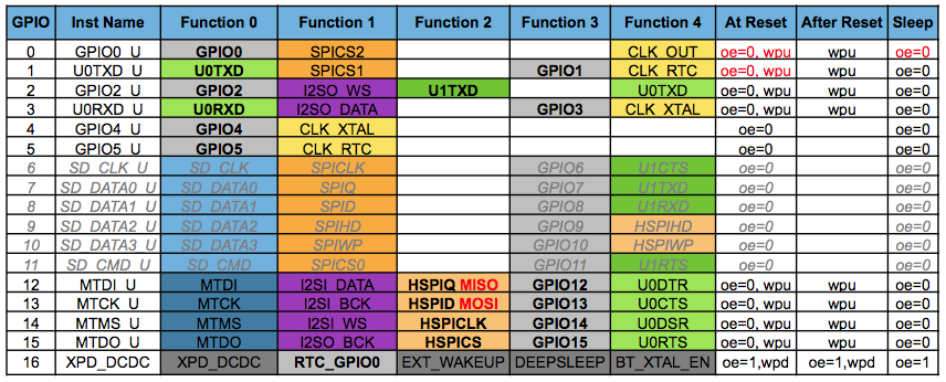

If you're getting medium tricky, this link is helpful. You can change the uart pins to gpio's when your sketch is running, and still be able to reprogram the thing when it's in upload mode. 4 IOs instead of the usual two. http://www.esp8266.com/wiki/doku.php?id ... llocations
The only thing that could be called a "trick" here is how I did the button for gpio-0. It is a button to ground. The other pin of the button goes through a 330 ohm resistor to the actual gpio pin, just in case you have a sketch in there that was forcing that pin high and you forgot to hit the reset button first. I didn't really want to use two red leds - I wanted different colors, but I always use red for reset (a mnemonic thing), and the gpio-0 pin has an interesting property - when things are "Ready for upload" it pulses that pin low at a low duty cycle. For the life of me I couldn't get a yellow or green LED to light up enough with that 330 ohm (and another one in series with V+ because the button DOES short to ground) to see in that mode.

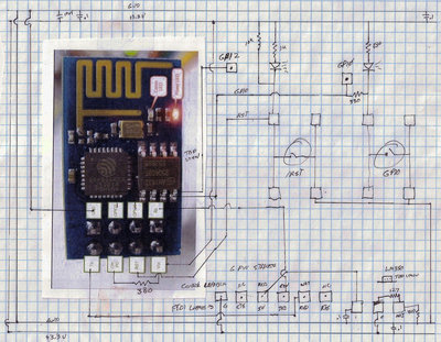

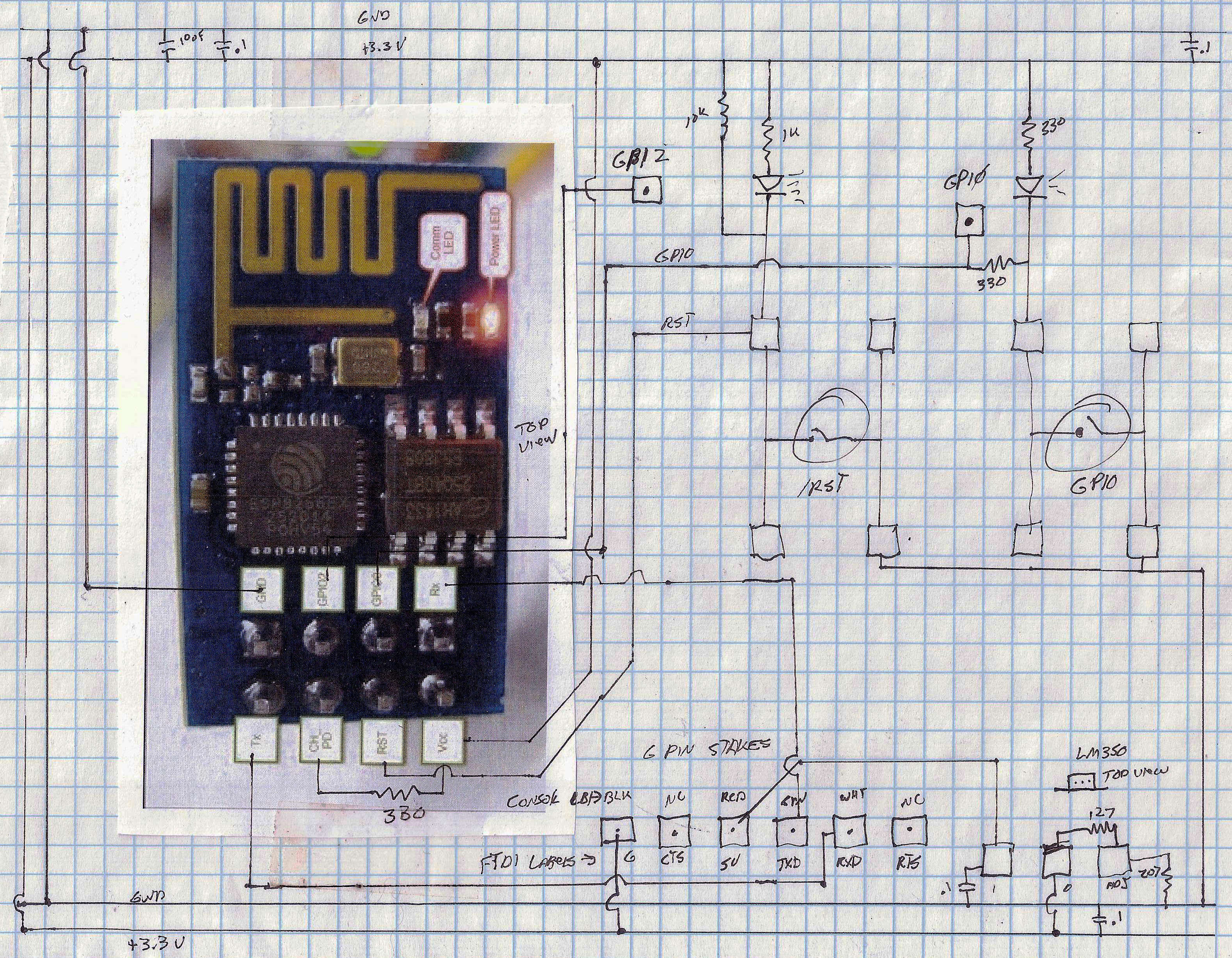

As promised, here is a kind-of schematic I drew. Not in the pure old form, but as close to the physical reality of what I built as I could while not cheating too much. I used the truly old-skool cut and tape (I ate all my library paste decades ago) of an image of the ESP board - this is all just as you'd see it if it were sitting on your desk, built. I also added stakes to 3.3v power, ground, and both of the "GPIOs" in case I'd want to try something right here, or put a scope on something.
Note that I used an adjustable 3 terminal regulator from the 5v on the serial cable (this works with either type as long as the data signals are 3.3v compatible), and it's a bit of overkill, also not producing exactly 3.3v but closer to 3.39v. If I were just ordering all the parts instead of building this out of my junkbox and stuff left over from spurious "uP Starter kits" - I'd have used a proper low dropout and probably lower current fixed regulator instead. You run whatcha brung as we said in drag racing.
Note, most sketches won't run while in this jig. For one thing, the pin GPIO2 toggles like crazy during downloads, and that's likely to confuse an SPI or I2C device to the point of needing a power cycle to actually work. I did get a sketch using the DHT-22 temp/humidity sensor to kind of work, but this particular sensor is a little flakey - it's been wired to power backwards and got quite hot before I realized it. Though, it seems all DHT-22's are a little flakey, and many of the libraries that drive them have provisions for when they return something "NAN" or not a number. Which this one does now and then, but I will try with one I haven't half-fried soon.
Some trickery mentioned in one of the links above will let you also use the RX and TX pins as GPIO 1 and 3. They will revert duing programming to RX and TX just fine, but things will be a little confusing till you unplug this from the jig and put it in your real hardware setup. This is from the link above:
Pins can be re-mapped according to this
(but I haven't tried this yet - YMMV)
So, here's the jig schematic. I used all the "safety resistors". To use this, one holds down the GPIO0 button and then presses the reset button, and only after releasing the reset button, release the GPIO0 button. EG, if it sees GPIO0 low coming out of reset, it goes into "boot load" mode. You do this button press cycle just before pushing the on-screen "upload sketch" button in the arudino IDE. This is the same as the Adafruit Huzzah board without the fancy Feather add-ons.
In dim enough light you can see the GPIO0 led light up a little when it's in the "waiting for sketch" mode...I can barely see it here with the room lights on...a little tweaking here and there might help (or just a more-efficient led).
Schematic for the ESP programming/test jig

Note this build is between what I call "research grade" - only has to work a few times, and production grade - works forever and is effortless. That's engineering for ya. You try and hit the sweet spot for total hours spent on it - too fussy wastes man-hours as R Heinlein said. So does not fussy enough. The big "trick" if any is that I cut up some stacking header to make a socket for this so it isn't hanging loose on a bunch of kludge wires, easy to miswire on every use. I just added buttons while at it. While not mentioned in the link above that I more or less copied, power cycling, depending on how you do it, drives most PC's a little nuts - they don't like USB serial ports coming and going, and assuming the unplug might have been a glitch, tend to assign a new port ID ( at leas in linux and windows) when you replug the thing...which in turn your arduino IDE will be confused by. That was the main driving force behind adding the buttons like in the Adafruit Huzzah. At any rate, the thing works, and for reasonable length runs, it'll be "production grade" enough. I'll do most of my dev work on a fancier board, and test with that - then program these for cases where up to 4 pins of IO is all I'll need...
