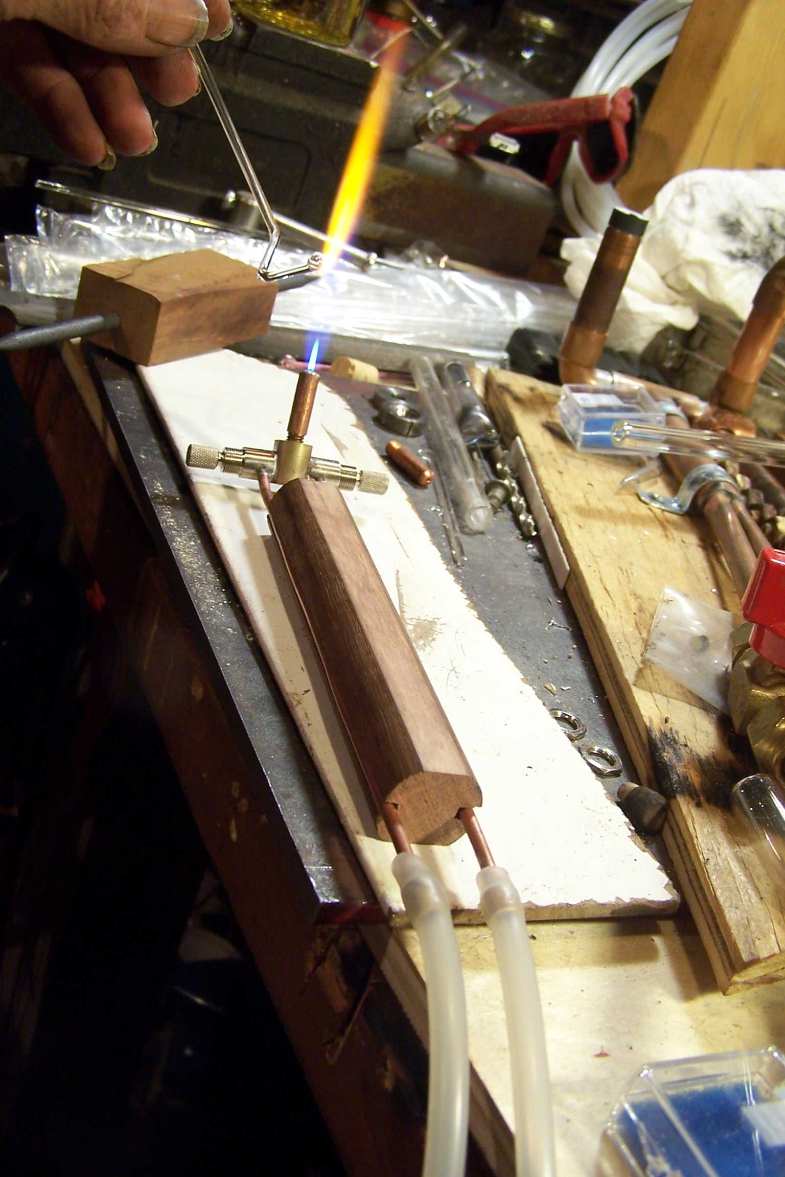

I'll have to fire up the miniature torch I built that I mostly use here and get a picture -- I used a MIG tip for it, and miniature needle valves. I use MAPP gas in normal
propane torches for bulk preheating, and that to work the details. I rarely reach for the oxy-acetylene unless it's quartz. The MIG tip torch is just right for things up
to about an inch, and doesn't eat so much gas or oxygen. Very tiny point flame.
- Homebrew torch for glass work
Found an old pic. If I were making another one, I'd put the valves back on the handle instead of where they are -- they get hot there. I was a little concerned about having any amount of mixed gas volume...the thing on the right of the pic is a set of crossfires I made. Believe me, at that diameter a flashback is all too exciting, that one's air-gas only, can't do oxygen. In this picture, the torch is at full snot -- I usually don't do that for real work. The pic also demos why you want the fancy glasses that kill just the yellow sodium lines (which is what I was doing when I took it, I was showing a visitor how cool they are).
