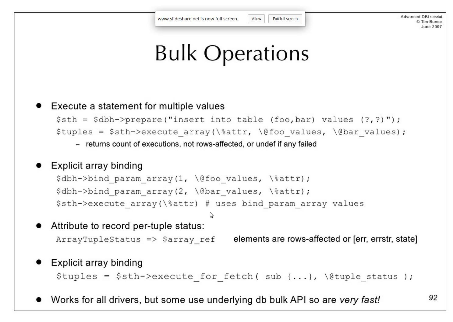

Yes, perl's DBI module totally rocks. It will even allow things to be done in bulk, and most of the code is actually C(++) in there to be as fast as possible. I use it extensively in the "Lan of Things" project, and plan to keep using it as I install more units.
The SQL database (I use mySQL here) need not be on the same machine - which makes that "bulk" feature more worthwhile, due to lan overhead etc.
Here's some code that uses it: http://www.coultersmithing.com/forums/v ... t=20#p5576
This is the code in the office trailer pi that gets data from an arduino, and an internal sensor (that's the ugly part...I tried to rewrite someone else's unbelievably bad code, but it's still ugly for that sensor - partly because the sensor needs your code to even come up with useful numbers, temperature compensate and so on) and puts it in a local mysql database. CGI programs (also perl) on that machine serve up the data to anyone on the LAN by querying the same database. I'm using NGINX (and FastCGI) and phpmyadmin for the other major pieces. All this barely loads a pi-b2 - and would probably run on the older single-core version just fine - I'll know soon as I have one in the battery box getting data from there and controlling the cooling system on the backup generator - may as well find uses for the old model pi's I've got already.
Here's a slide from a presentation I'm going to have to find the link to the rest of. And I got lucky and found the link: http://www.slideshare.net/Tim.Bunce/dbi ... orial-2007
Of course, none of this absolves you from having to learn SQL and other things like how to design databases to 3rd normal form and so on. This is just how we talk to them.
