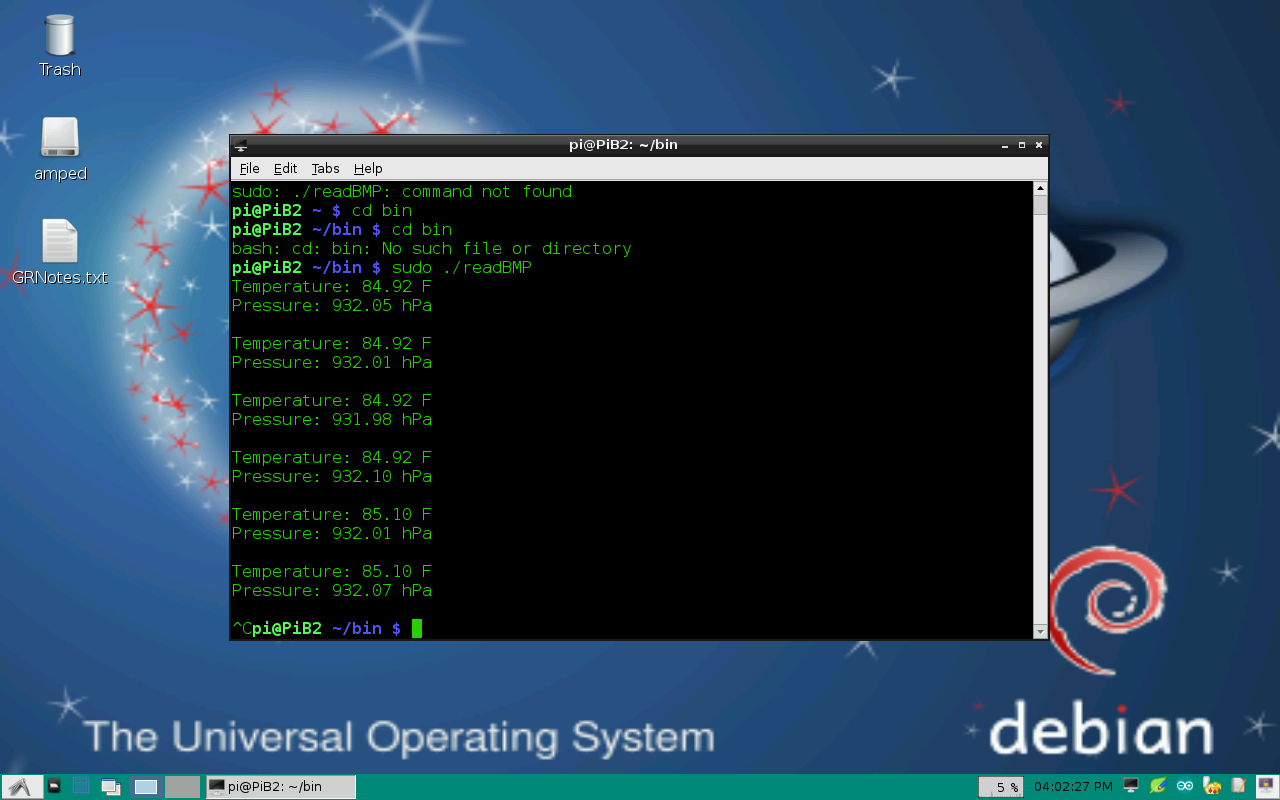

I found an example program in perl, but it used the aforementioned Device::SMBus, which took hours to put in, needed root anyway, and is a waste of space on the pi for what I'm doing, so it's going out of there. I modified it to use the much lighter weight HiPi::Device::I2C module instead, and will likely modify it somewhat further as it's bulkier and more general purpose, as well as "politically correct" than I actually require here - I'll do the "tighten it up" at some point before putting it in service, but it works fine as is. Example, every subroutine in this uses my declarations for variables it already has, wasting CPU and ram when it doesn't change them anyway, so it's safe to use the ones as passed in - or globals for even better speed, since most of us will only ever have one BMP180 - the barometric pressure had better be more or less the same anywhere on your campus as it is on mine...we are not using this as a differential wind detector, there are better things for that, anyway.
So, here's the code, and also what it looks like running...

And it looks like this running:
screenshot from Pi, made with "Scrot" program

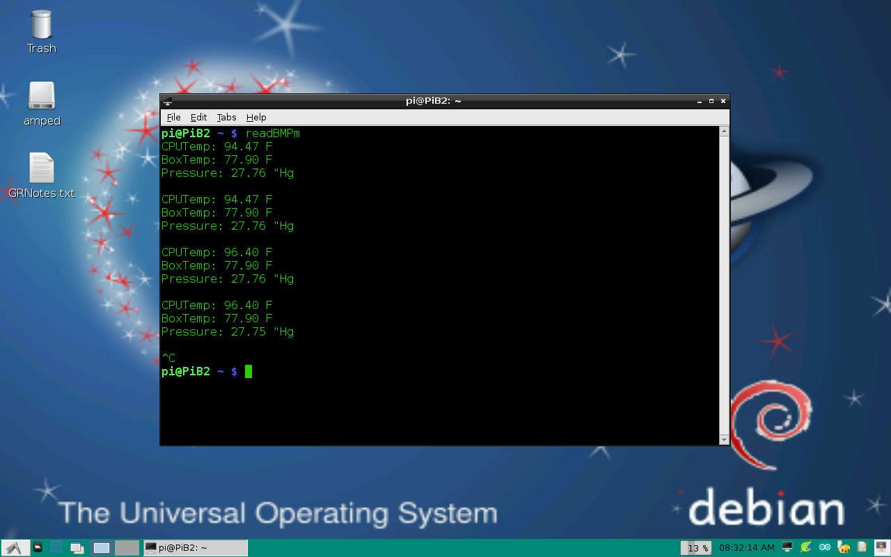

What I was doing was optimizing the code above, for a smaller memory footprint and general efficiency. The original authors had made some serious beginner mistakes, from originally pulling in "perl for mainframes" modules for a mere Raspberry Pi (I already fixed that one in the previous version), to over-generalizing the code. For example, there can be only one BMP180 on an I2C bus (fixed address), yet they passed an object to every subroutine rather than just accepting the global nature of it.
Which was doubly-silly as they used the same name, expecting you to understand that this wasn't necessarily the global one in each routine in some la-la land. Further, they used an excess of "my" variable declarations in subroutines, and evidently didn't understand you don't have to create a return variable, or even a my variable if you're only going to read it. All this spurious parameter passing and allocation adds up, and it simply didn't make any sense, or make anything actually clearer in the code. They also imported tons of unused functions from Time::HiRes, which is often a bad idea on several counts. It's not like you can't add them back later if you should need them.
While I was in there, I added the code to get the pi's actual CPU temperature, from it's internal sensor, and made some conversions to English units (because it's not metric land where I live). The result has a much smaller memory footprint, and more importantly, starts up a lot faster as there's less for the perl runtime to look over at start. That's important as this will be put in a module (and I might make more global variables once I have a namespace for them to make that safer), and along with other code for database stuffing - it will become part of the boot process to load and daemonize the resulting code. Speeding it up by a factor of around 3 as I did (for startup time, runtime was probably better yet) - will matter down the road.
After it's time to build a railroad, it's time to build a beautiful, efficient railroad, eh? I tend to do this even for much more capable hardware, I love producing the reaction "I didn't know my computer could DO that!".
So, a short course on optimizing perl (really, coding in general), some slick tricks etc, can be had by comparing the version above (which works fine) with this one. I named it a little different so you can have them both open easily in a syntax highlighting editor.

I will be combining this with some other data aq code for data from arduinos, and making that all a linux daemon run from the boot stuff. It will just run and stuff data into a homestead database in the background. It's important that this be efficient, and it's nice that it starts quicker now. (3-4 seconds became 1-2). And not only is it faster, it's smaller, and it does more at the same time.
Screenshot - no longer need sudo as well.

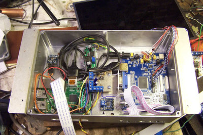

Back on topic (mostly). Here's the Pi box with some peripherals in it. I haven't yet drilled and tapped the holes for the thermocouple breakout board, but will, and get that working right off the Pi as well, also using HiPi modules. The barometer/temp board is in the upper left, the Pi is below that. To the right is the switcher which creates 5.1v for the Pi (most of the issues with Pi have to do with crummy power, I skipped the inadequate micro-USB connector here for that reason) - the box itself run on ~12v, the HDMI DVI display driver is on the right and will take the usual "car battery" range of voltages, so that's what we input from a temperature compensated deep cycle 60 Ah UPS system I built already, which will run this for a few days in the event of a power down situation - I'm likely to want that data even more than when things are normal, after all. In the center is the serial line driver on perfboard to adapt the Pi TX output to 5v - with drive up to 2 amps(!). I could even power the slaves from it, but I won't. It actually does that now, via the protection diodes in the arduinos. That's not a good thing, they could get fried if there are other big loads on them.
The Pi chassis, to be mounted in a wall in my remote location - I'm moving from this man-cave to there.
The white cable is for the Pi camera - this unit can stream HD video with lower latency and higher rez than even a normal desktop computer/tower and a webcam - it's about twice the rez, and half the latency of typcial PC streaming tools. And I can get a camera (have one) that also sees in IR and does motion detection...(this will be a link to that part of the project at some point).
