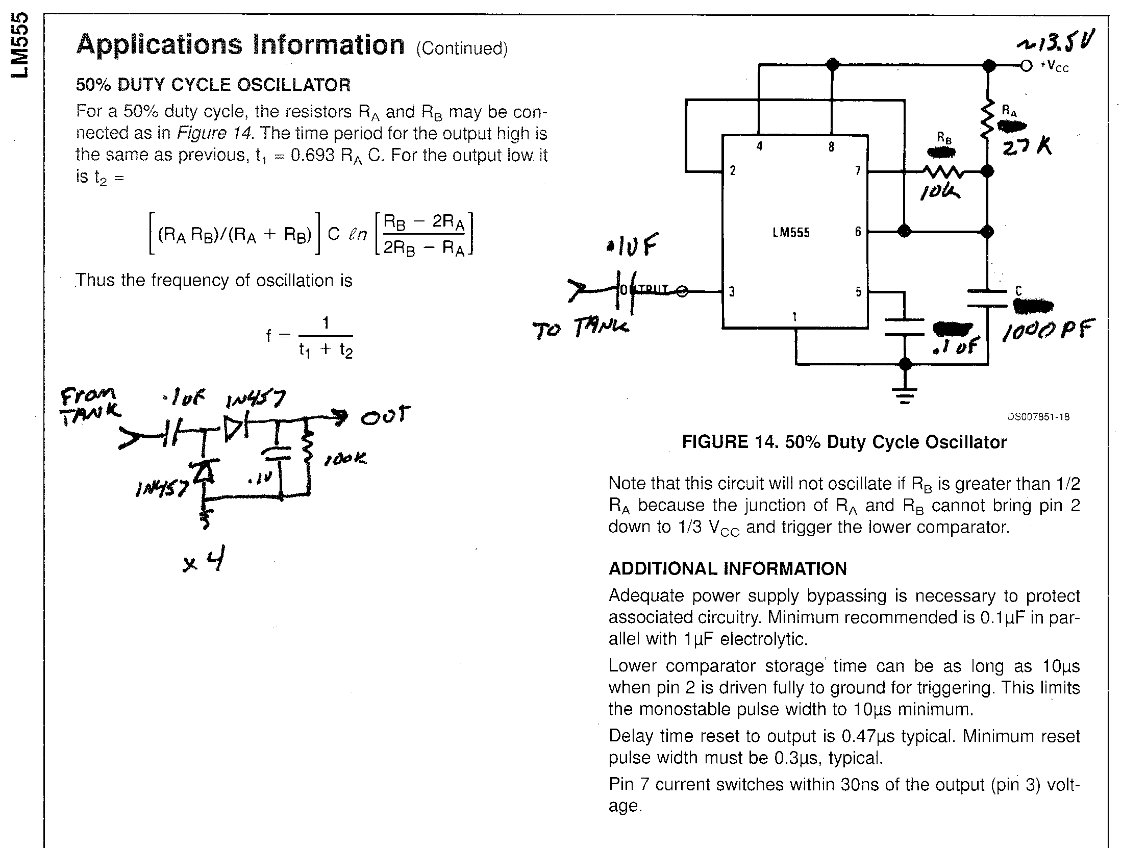

The circuit I designed (well, kinda a design, more of a copy) looks like this:
Totally old-skool. I even used a 555 for the oscillator, as I had a few new-old-stock laying around, and they seem like being available for another decade or more when I might need a spare. Also, I can run a fairly high voltage on these, off my 13.5v gel cell UPS system associated with my water pumping stuff - I use a 12v spot sprayer pump to pressurize plumbing. Other than being noisy, it's ideal (and I may add a reservoir designed to cut the noise). When you are dependent on rain, or going and hauling water, you want to know when the pump's going - you don't waste one drop on leaky plumbing/faucets and toilet ball-cocks. A drip can fill (or in this case, empty) an ocean. So the noisy pump is kind of useful for knowing if there's an issue, for now. I'm using all qest/pex these days - it can freeze and not break...nice. And it never, ever leaks, along with Kohler fixtures in the sinks etc. For the loo, I get whatever the hardware store guy says is best, and wind up putting in a new one about every two years. Life!
I did add some power supply bypassing to this circuit that isn't shown. .1 uF and 220uF at 25v.
The plan is to hook up a drive electrode, which will be some feet of Ti (fat) wire going to the bottom of the cistern, then horizontally most of the tank length. Then there will be 4 level sensor wires driving those volt doublers (for ac coupling...) at various critical tank levels for that end of things (I will be building a similar system for the rain barrel, with additional turbidity sensor and valves). I need to know - hey, it's full, turn off the intake valve. Hey, it's got enough room for one full rain barrel (the only time you want that water at all, since it has overflowed and is now free of floating junk), water low - conserve, and water almost out - boy, you'd better be getting a backup soon.
This will be wired to an Arudino Uno (hey, they're cheeap) along with some DHT22 temperature/humidity sensors for the basement, the bedroom, the kitchen (opposite ends of the building) and outdoors, just to have something else cool to log from it.
Logging will initially be done with a Raspberry Pi, but since it draws almost the same power as an intel NUC, I may go there when I have the spare change for it - in either case, the display draws more than the computer does - progress!
I used 1n457 diodes. They are what was laying around and are super low leakage. I looked at germanium, as less forward drop might be better, but it looks like the odd 1n34a's I have are too leaky. Schottky might be fine or better. At 100k load resistance, I doubt forward drop is a really big deal anyway...

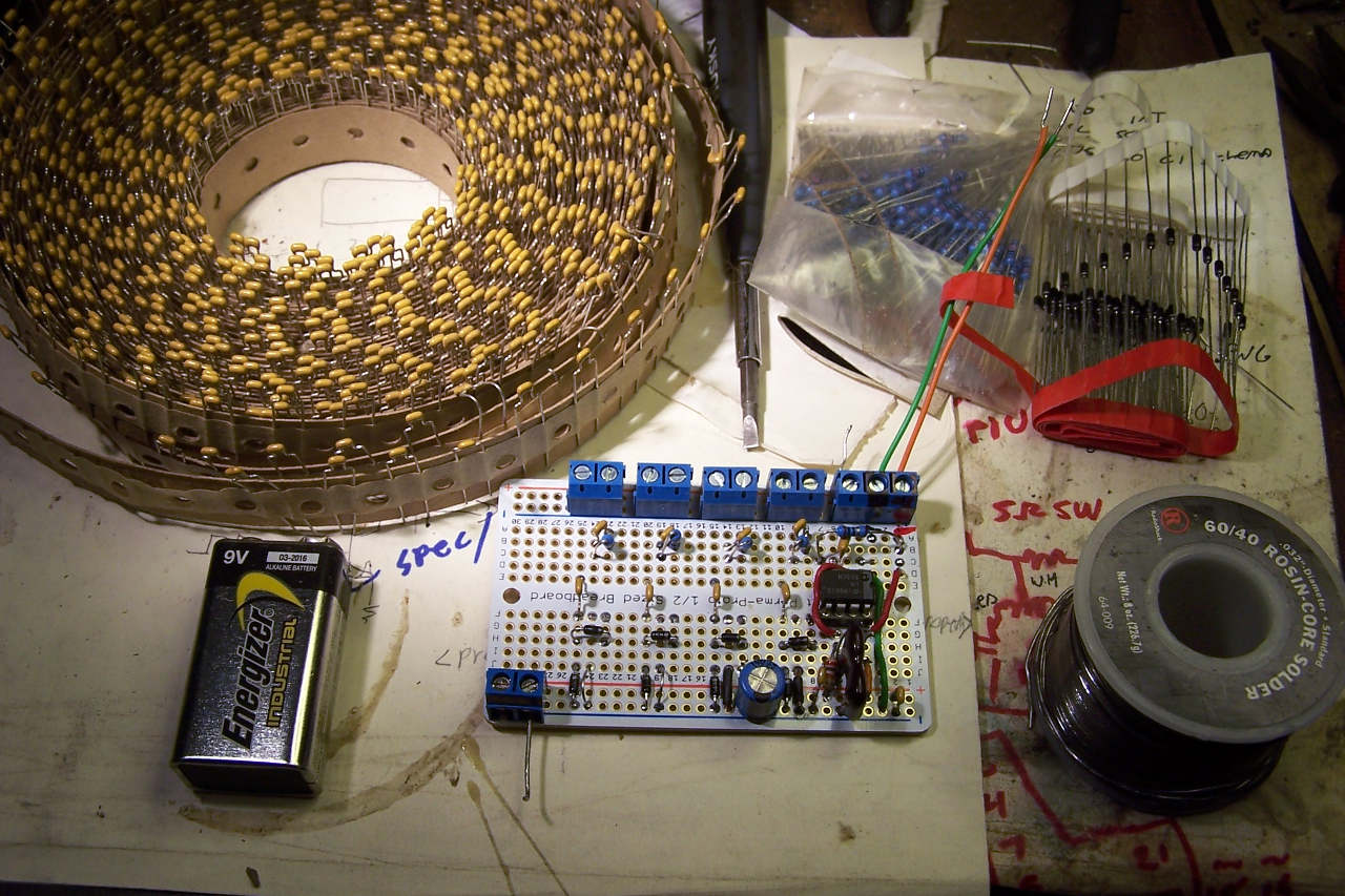

The built board looks like this.
It bench tests, less than 1/4" of the drive and sense electrodes make this put out cmos logic levels in a test basin on the bench - as in 5+ volts output. In the real application, since I want the other arduino pins for the DHT22's and driving valve solenoids and such - I'm using the a/d inputs for this, which will allow tuning the software vs having to fiddle too much with changing the actual wire lengths and positioning. There will of course be a lot more on this project...homesteading ain't for old guys and I'm getting there. It's like a race with time to see how much I can automate before I get too old to do things by hand.
