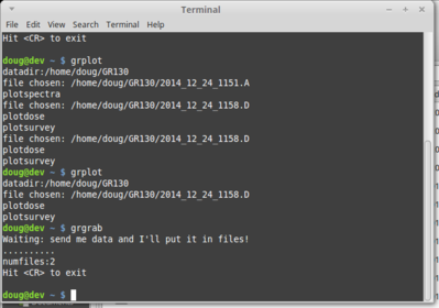

grgrab is a command line program. You just say that to a terminal, and it finds the serial port (reports that) and goes into wait mode for you to tell the unit to dump its data memory. When done, it will ask you to hit <CR> to exit. No harm is done if you download the same things twice, other than to date stamps in the filesystem. It uses the unit time/date as a filename regardless, and always puts them in your "home" directory under a directory it will create called /GR130 if it's not already there.
This of course, makes it really easy for grplot (which does have a minimal gui for file picking) to find them for plotting. The unit can make three types of files, which get one letter extensions depending on what type they are, so the code knows what type of plot to do on them - the rest is completely automatic, autoscaled and so on, and with real units. This code depends on your having set up the unit for 1 second time resolution in survey mode, and 5 seconds and Sievert units in dose mode,

Here are some screenshots:
Once you invoke grplot, you get this for a GUI - just enough to leverage the system file chooser button to get to the files. While you can navigate that anywhere, it already knows to look where grbrab puts things.
