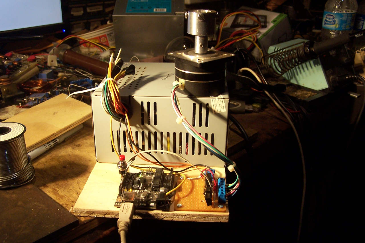

A little progress on this. After scrounging around, I didn't find a good power supply that would fit in one of my die-cast project boxes, not waste a ton of power/hear and so forth, but I did remember I have a ton of old AT and ATX power supplies, mostly good, from old computers or upgrades. Bingo, efficient switcher, and since the motor ran fine at around 1.8v (rated at 4v, the engineers must have been thinking darlington drive transistor and a 5v supply with losses), I figured the 3.3v output would do fine - the drop in the drive fets may as well be zero (look up specs on IRL 1104 - utter overkill but I had them in stock, so they're free).
Some folks may say this sloppy build - not even a box but a good ole board - shows lack of pride in workmanship. Some will say it's overkill. I suggest either one look at Pareto optimization and then get back to me. Or as Robert Heinlein said "too fussy wastes man-hours". I had all this stuff laying around. No, it's not optimal if one were going to build thousands, or if one wanted to program it for different angles at the job - I'll actually have to fire it up hooked to a computer and take, dunno, 30 seconds or so to change that. Whoop. de. do. Mounting, wiring up and writing code for an at least 2 digit thumbwheel switch would probably take longer than I will ever spend just changing the number in the code and re-uploading it.
Not done yet is extension cords for the motor windings and the pushbutton to make it move. I'll get that done tonight, and later, show the whole mess leaning on or laying on the lathe ways with the motor/jig in the chuck and the toolpost drill in action.
That is, when I have something to drill. Since we moved to 3/4" grid OD, I decided to quit wasting my 1" stock and just buy some 3/4 from McMaster, which will happen real soon now, since I've finally got enough other stuff I need from them to make shipping worth it. Early next week - they ship fast.
But here's what it looks like now. Just screwed to a board so it'll lay on the lathe ways, or lean on them. The entire mess draws 12 watts from the wall, about 7 of which go into the motor, the rest is power supply "tare" and the arduino uno.
For which this is the code, folder and all, for your sketchbook: Note, I always just go ahead and move the serial speed to 115,200 baud...on just about every project. You rarely run into a "real" serial port that might barf due to buffer overflow anymore, it's all USB dongles, and they have plenty of buffer for most any project, and this one doesn't push it, it just types one short line when it moves the motor (debug). You don't need a computer present for this to work, once built.

I'll look into those, Jerry. I'm not a huge fan of arduinos generally, it's just that I had some 10 uno (seeduinos) I got from yes, China, for something like $50 - including shipping, laying around. I've been using them for data aq too - via oversampling and sigma-delta math, I'm getting ~14 bits of "goodness" out of even those 10 bit a/d's. I vastly prefer the chipkit (PIC based) stuff, probably as much from habit as anything, since I've been doing pics for decades now, and like the IO.
Even with the arduino, it's the PC tools that limit the baud rate, actually, most terminal emulators will only go 115,200, even though my perl code can go lots faster, and I generally use human-readable ascii and a terminal emulator as part of the debug process. At any rate, that's all the arduino/chipkit ide's will let you have as well. Hasn't been an issue yet for what I'm doing with these guys. I was just warning potential users of my code that they'd have to set the default up to 115200 instead of the 9600 it (the IDE) comes with. Java...don't get me started. This dev environment is about the lowest thing you could possibly call an IDE, at least running in linux with the open java runtime, but probably even if you use Oracle's. Click on an error in the compile window and go to the error? Nope. Add multiple files for better organization? Possible but difficult. Adjustable syntax highlighting so it looks like my other C tools? Haven't found a way yet. Easy for noobs, very lame to an experienced coder.
I had a bit of a setback last night...I discovered it's a bad idea to knock over a beer onto the lashup, and found that old PC power supplies don't like beer (though the rest was fine with immersion in it). The next old one I pulled form the junkbox didn't like loads on the 3.3v supply (and yes, I had the sense wire properly hooked in) so I had to go to 5v on the stepper, which makes it pretty hot (everything else is ice cold - and the drop across a turned-on driver fet measures zero - it's something under 5mV).
So, today I get to make the extension cord for the motor, and one for the pushbutton that will have some magnets so I can stick it to some handy place on the lathe. I'll simply use really high gauge wire for the motor and accept (want) some voltage loss there where any resulting heat is spread over 6' or so of wire, rather than concentrated on a diode drop or resistor.
I'm kind of in a hurry to finish this and get my desktop cleared so I can get going on Philipp's MCA design - he sent me one, without other distractions. Part of the optimization...and maybe it'd be worth the time to put a beer holder that wouldn't allow bottles to tip over on my bench somewhere...that little oops wasted a lot of my time. I couldn't find out what was wrong with the beer drinking supply - nothing burnt, no bad fuses - it just quit working after a nice fat arc showed through the holes in the case. I'll maybe scrounge some of the ferrites out of it. At least they are cheap (free in my case, I have a large box of these computer supplies that I'd like to be able to close the lid on). Sometimes my local computer store even gives them away.
