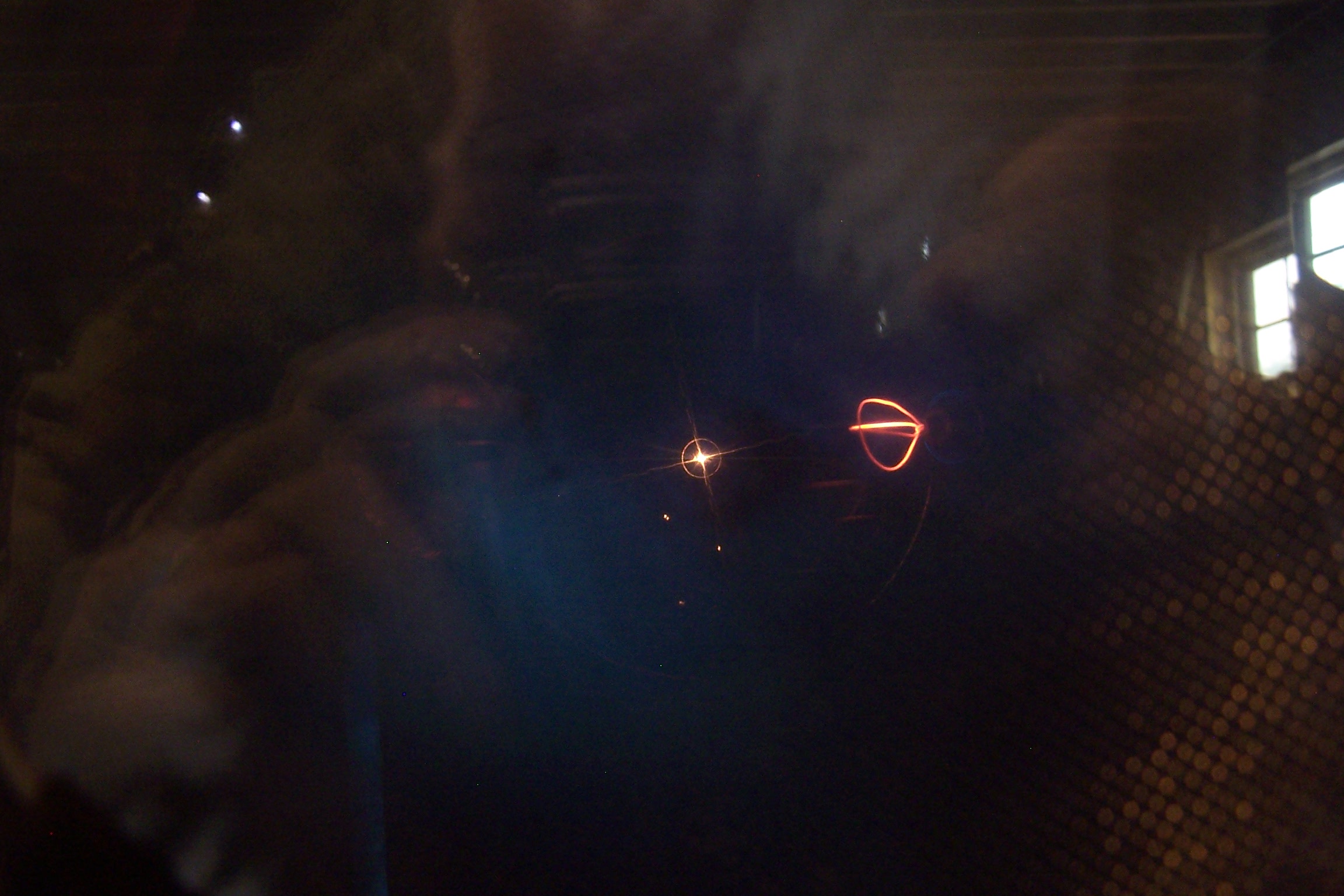

So, Pix and such. Here's one of it all going at once:
Purty by some definition - the look of success
For once it really does look like a star in a jar - not the usual recombining D spectra.

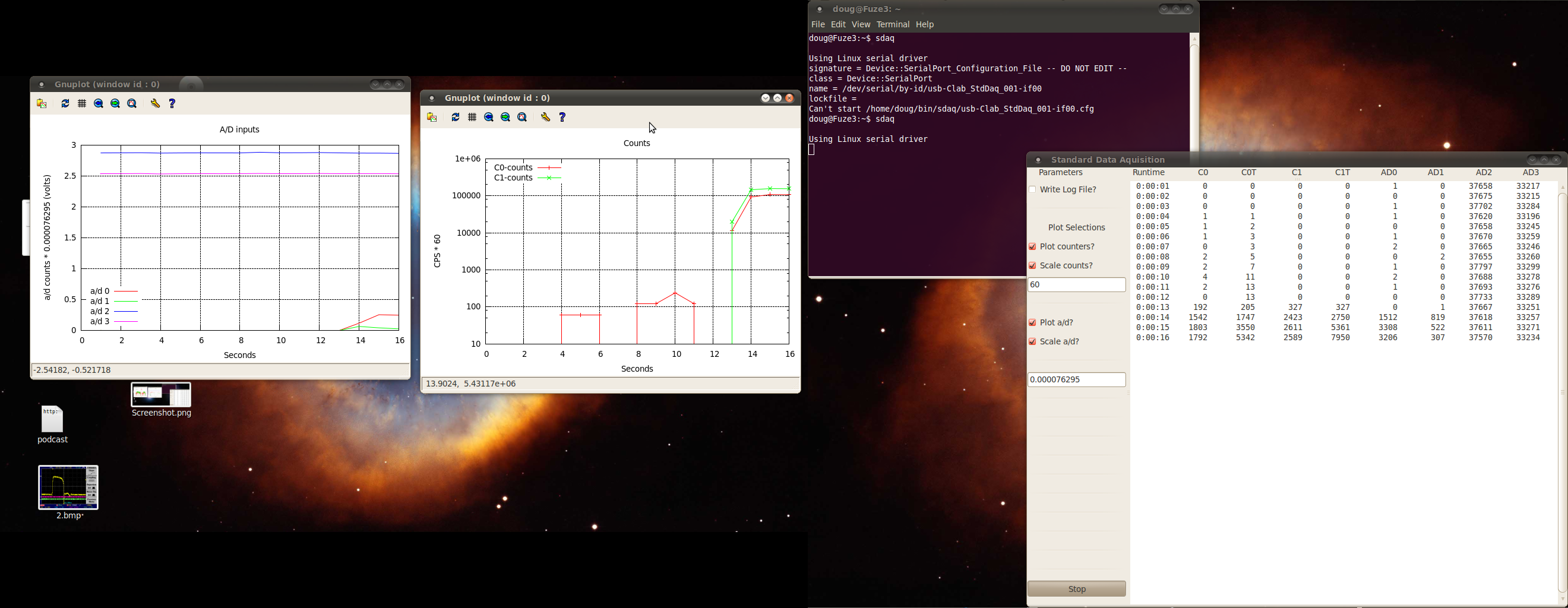

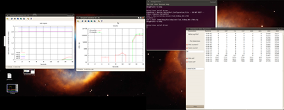

First shot with new 2nd grid wiring:
First shot with new setup.  Note main power is tiny - it's barely at idle but it crashed the world anyway.

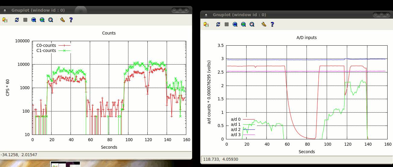

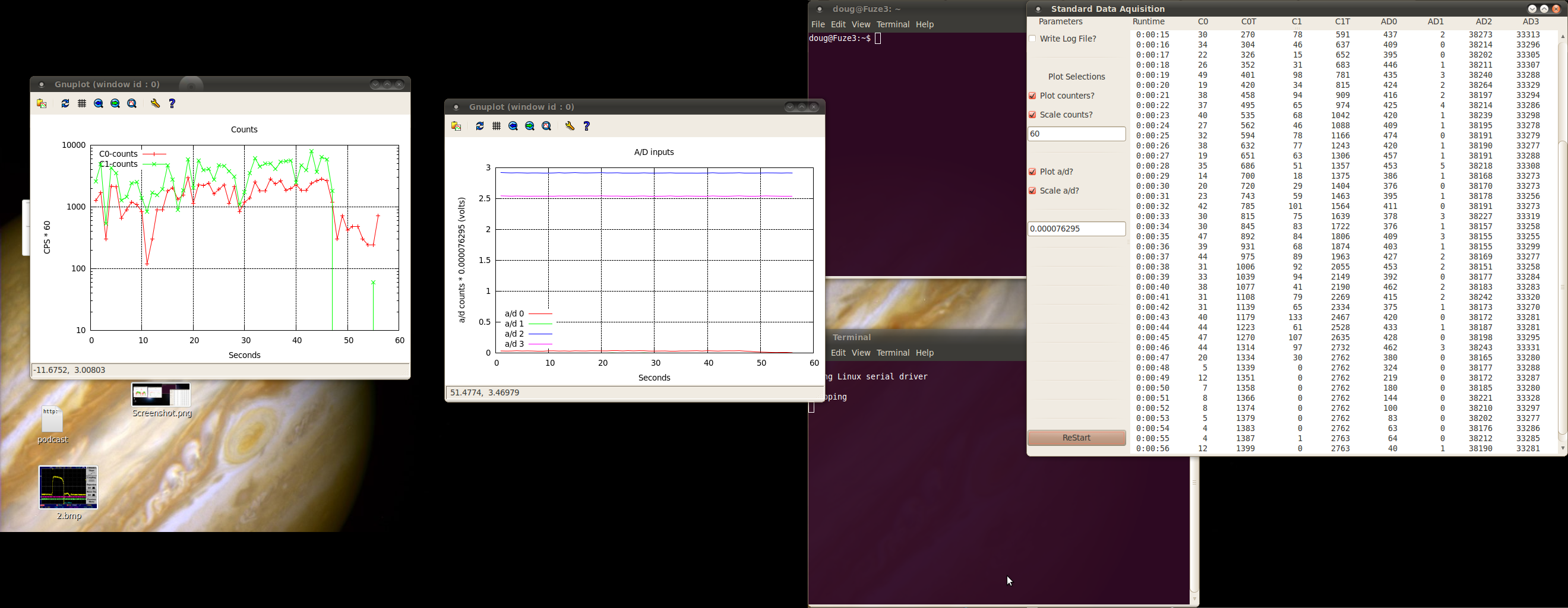

Here's another with just the 2nd grid going - you can see where I turned off its DC supply - the X rays and neutrons (from a far away detector!) go down then.
Only ran a few seconds before the crash...of the PC USB driver, not my own hardware.

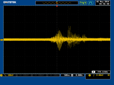

Sadly, once I kicked on the main supply there was no data take-able. Even my multimeter with the HV probe on it went blink and all the digit bars on....must have been a LOT of RF. In fact, I put on the scope and picked some up from across the room. I couldn't even standard-count my silver, but next time I'll have a backup at hand...could be tomorrow. If that shows the numbers I expect, well then....this was the right trick, and did I say I haven't even hooked up a tuning cap yet? Nor tried the other polarity of the transformer (it's in the polarity now that ought to be negative feedback if not for transit times).

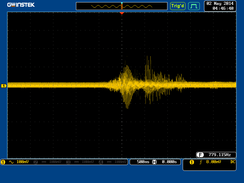

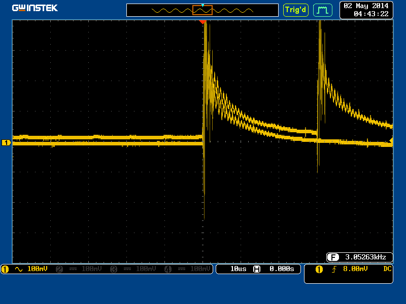

But the nice new scope was safely 15 feet away, and caught some of what was going on with nothing but a probe tip floating in midair a long way from the fusor.
Here's a little of what it saw.
Some scope data - at least 2 frequencies are present here.  Probably relaxation or squeqqing along with the real, higher, frequency
Mostly the higher stuff on this one.
