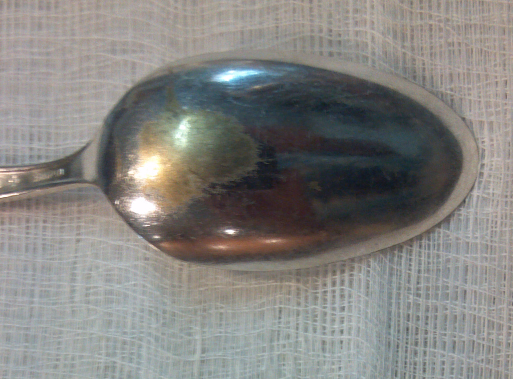

To restore worn spots on silver-plated flatware & other small areas
of base metal that have been brought to a high polish with tripoli &
rouge, I have found that, for my purposes, it is sufficient to just wash
with detergent, scrub once with the likes of "SoftScrub", then go to
step 1 under "PLATING", below.
While this cleaning method works well on small areas, plating a large
flat area is likely to require more thorough cleaning!
C - PLATING:
1 - rub briskly for 30 seconds with a cotton ball wet with a drop or
two of (well shaken) Caswell's "Silverplater". This will put down a
thin layer of silver sufficient to make the (bronze) color of the base
metal almost indistinguishable from the surrounding silver plate.

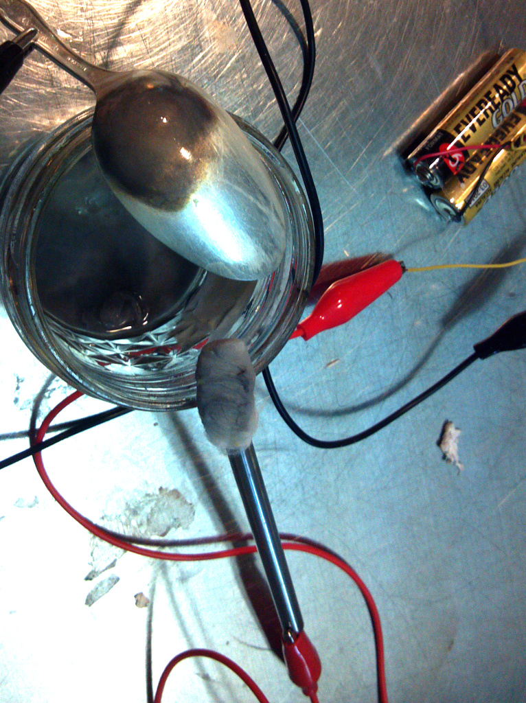

2 - to increase the thickness of the Ag layer, attach battery (-)
to workpiece (cathode), and the battery (+) to the stainless wand
(anode) the flattened end wrapped with 1/2 a cotton ball & thoroughly
wet with the 0.6 M AgNO3 solution and slowly, but firmly, rub the
prepared area in a circular pattern or brush-strokes for about 60 to
90 seconds. The workpiece color will progress from yellowish, to tan,
brown, milky gray, and darker gray.

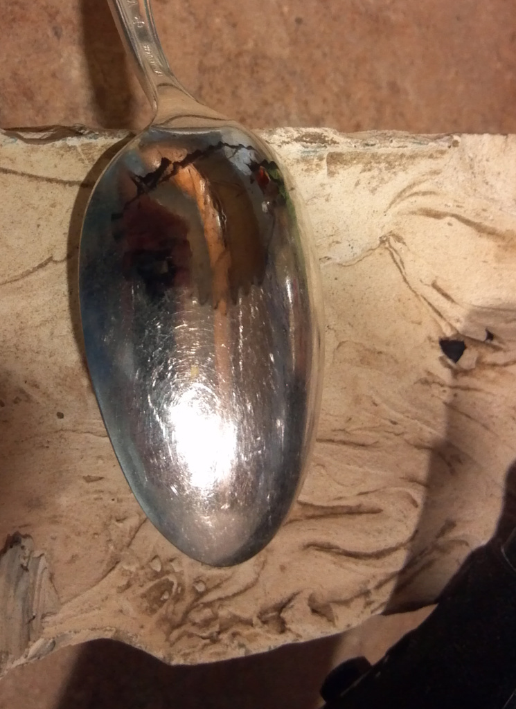

3 - disconnect workpiece from battery and polish with Wright's
Silver Cream.

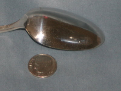

I have no idea what the thickness is of the resulting silver plating.
All I can say is that the pieces I have plated in two passes with
freshly-made 0.6M AgNO3 survived being polished with a soft
buffing wheel & jeweler's rouge.
Silver Cream.
NOTES:
If you are working on a metal work surface, be sure the battery leads
do not short out on the work surface, and drain the battery.
If the color progression in step 2 above is very slow or does not occur
it may be that the battery is dead or wired backwards, or the AgNO3
solution is depleted.
CAVEAT EMPTOR:
