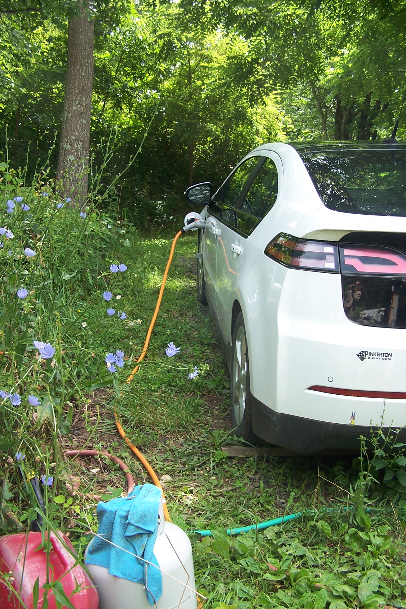

And here's what the result looks like. I don't back the car all the way in, as there's a path for my tractor that has to be between it and the house, so I needed a long cable. I always back in, as it's fairly dangerous to have to back out of my driveway - both steep and blind at the end, with a drop off on one side. This puts the connector on the car pretty far away from the house.

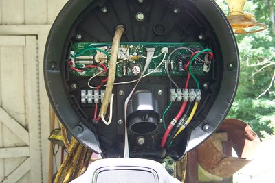

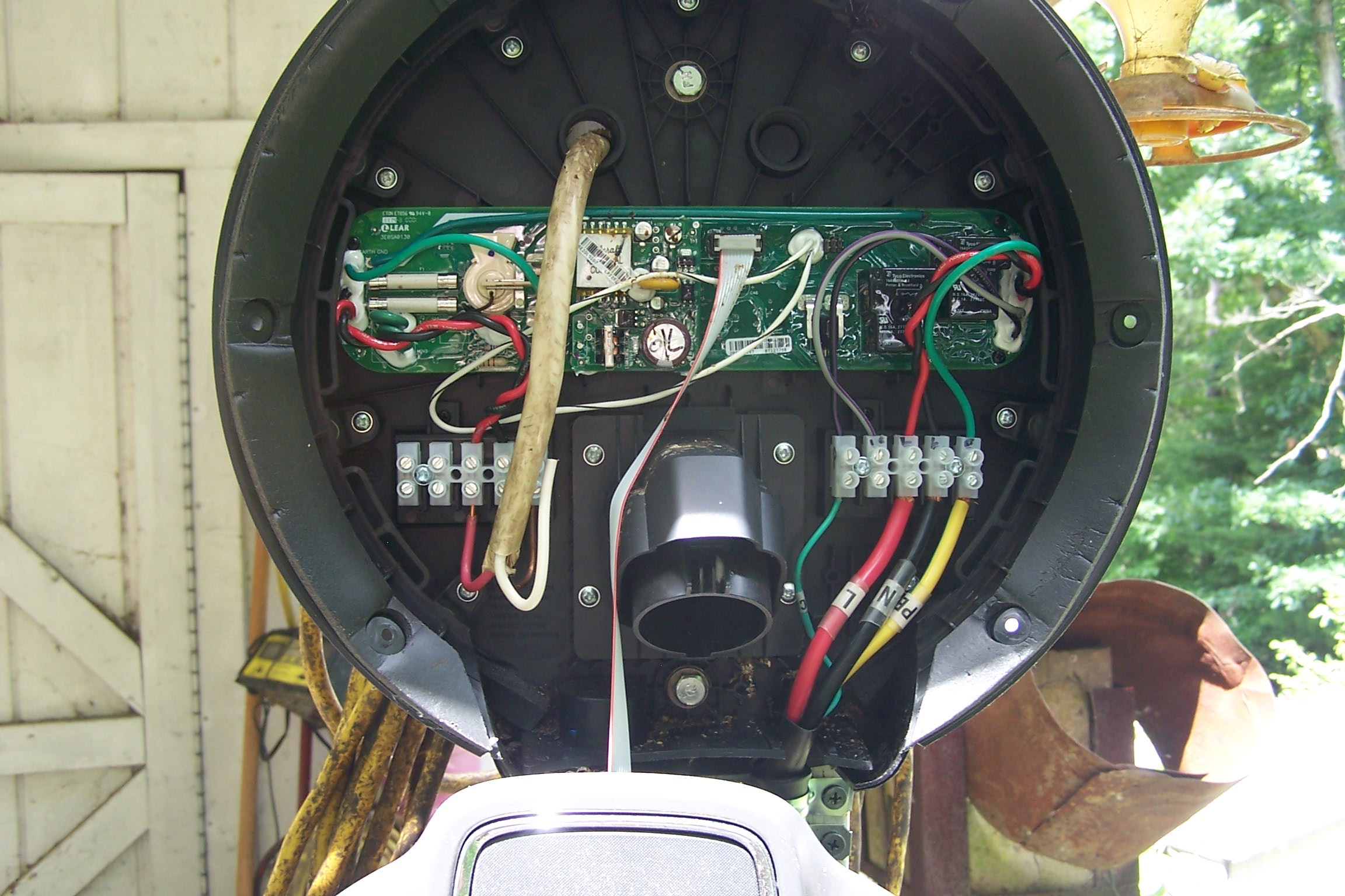

The output is on the right - and from left to right, the terminals are - pilot signal, 15v (for the led flashlight), L2, L1,, GND - just in case you ever have to do this one. The new cable doesn't have the useless dim led flashlight, I won't miss it.

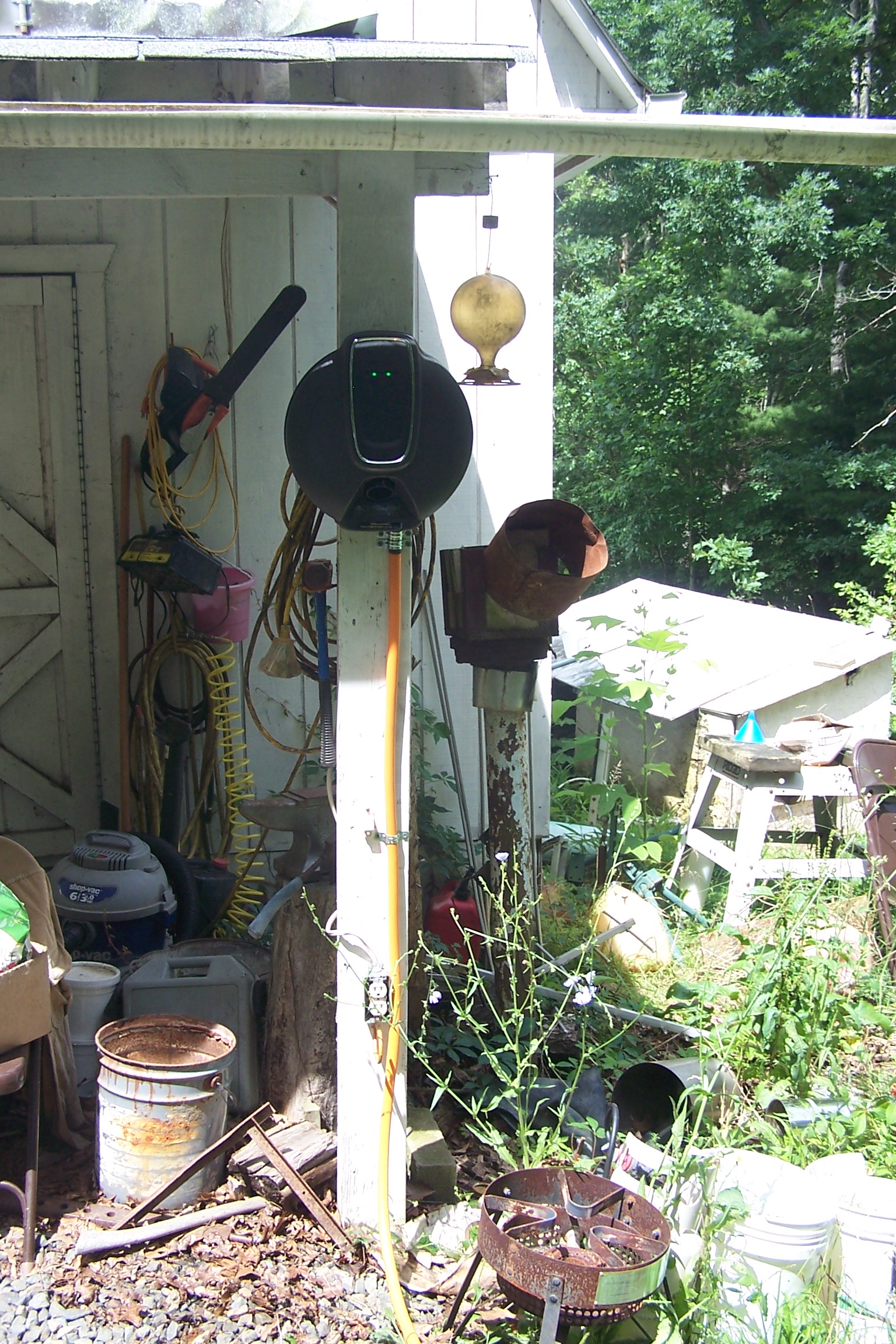

Here's the perspective looking from the car:
I used a few conduit clamps on the wire as strain relief, screwed to the post. They fit nicely, as it worked out - nice and tight where the manufacturer terminated the fat outer insulation and covered that termination with THICK heat shrink tubing..
And from the yard:
Kind of a distraction from the series I'm writing (and starting to get help with) on reloading ammo, but it will save me more time than it took to do, this thing is just better - seems rock solid compared to the original. And I can drive the tractor over it, without catching it, or having to lift it over my head each time. I'm pretty sure, that while my tractor doesn't put down all that many PSI, it would have quickly ruined that cheezy coiled cord with butter-soft insulation on its conductors.

On my first, they refused to just ship me a cord, or believe I knew that's what I needed - they just shipped a whole new unit, which was identical to the previous one that had failed in the first month. I don't think the side-stress it got in my app had a bit to do with this, but it was enough that I didn't like it, and the coily, tangly cord was a nuisance from day one. Every time I had to take it out of the path so I wouldn't drive a tractor over it it tangled up. It quickly got to the point (about a week) where it didn't really retract anymore anyway. So every time, pull, untangle, connect (ouch, 5 or more lbs of side force levering on the car connector) and then fiddle the button to make the thing actually charge. I'm not sure why it really needed that latch at all, unless your situation was trying to pull the cord straight out.
I had to unscrew that terminal strip to put in the new fat wires. Couldn't force those fine strands into the holes at an angle without bending them out of the hole - danger! Then I put it back. It was easier to get a good tight clamp with it out, where I could hold it while tightening the screws - the nylon they used there isn't really thick enough to stand good screw clamp torque.
The board and all are well potted, the top is sealed with a good gasket, and there are little vent slots on the bottom that let water (condensation) out, and sadly, wasps in. It's not a really bad design for outdoors, at least if protected from rain right on it - and this is, a little. It looked pretty good in there (other than the wasp-waste) after almost two years. Well, it looked original. I wouldn't have designed this that way myself, but the basic thing seems to work fine.

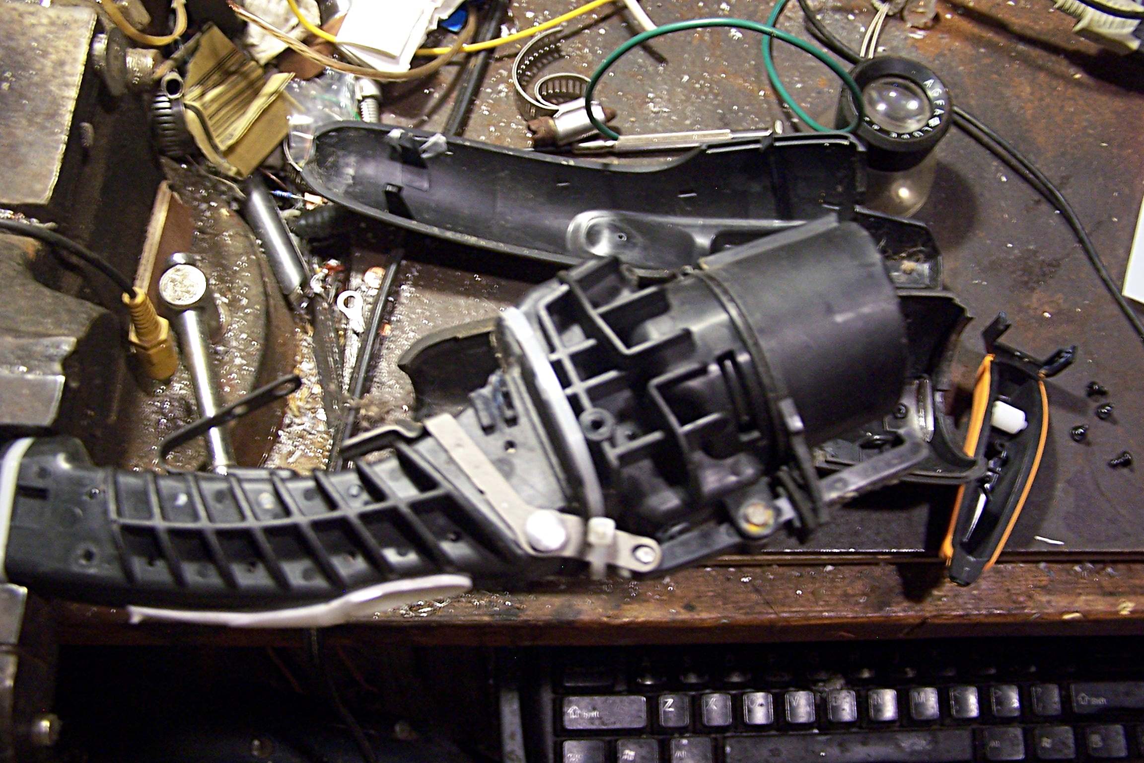

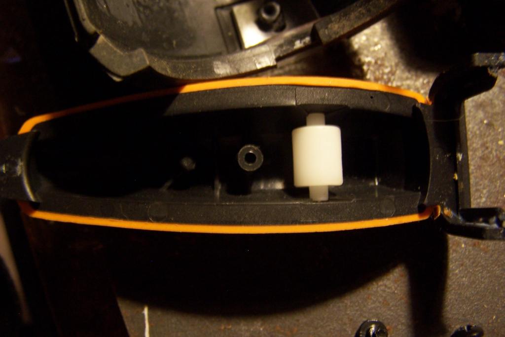

In the interest of making this thread a leetle more informative than just bitching about something we all know stinks and will never be fixed, I thought I'd go ahead and actually repair the old connector - around here, one keeps one's backups hot and ready.
As well as show the world how they messed up. Here's the picture of all the parts (sorry, it's not a great pic).

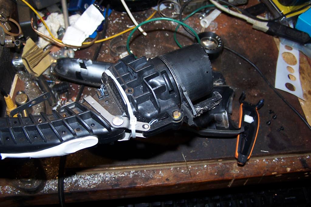

Yes, they actually DID use cable ties as structural members, which as we know, will embrittle and break in a few years anyway in an outdoor situation. But this time (and evidently, also last time) that wasn't the problem.
The lower half-shell holds the "guts" via 4 tiny fast pitch screws for plastic. I took that off to get to the "issue". The issue was, that little white roller in the orange rubber coated actuator had come loose and was sitting in there sideways from the (correct) way it's shown here. That handle is located on the U spring shown at the top (in the picture, in use it's the bottom) of the main connector, via two holes/posts in normal use, and held in place essentially by the hole in the lower outer shell. Here's a closeup of the squeeze handle with the nylon roller placed correctly again - note they only used some very shallow and Vee shaped notches to locate it across the handle - it had popped out of these, having plenty of room to do so, since they used an insane (over 1/4") clearance between that and the metal flap/lever it actuates when you squeeze the handle. So basically, you can make one of these fail by doing little more than holding it upside down and shaking a bit. I could/should have bent that metal down (in the first pick, out) some to prevent this happening again, but it's rippled metal so they could use even cheaper stuff (thinner)...sigh. It's not like they don't charge real money for this charger, the most expensive single part of is...the wire, which is maybe 10 bucks worth for a $400 thing.
Gheesh! The bad parts of the old GM moved to Schneider/Voltec? Bad implications for Xantrex, now owned by Schneider? We'll be watching, guys.
Here's another pic with the flash - different type of autofocus failure, I'm sad to say. BTW, the top just snaps on. They'd also used some of that whjite silicone glue they uses around the wires in the main unit, they seem to like it. It had zero indication that it had ever stuck to the upper cover - I guess they forgot entirely about a magic substance called "mold release agent" it still had on it...C'mon boys, this is beginner grade stuff for engineers - if I want to be kind about it.
And oh, I added some lube to the rusted metal pivot pins in there and now it works smoother than new. There appears to be no way to just replace the wire - it seems to be molded right into the main body of the thing.
