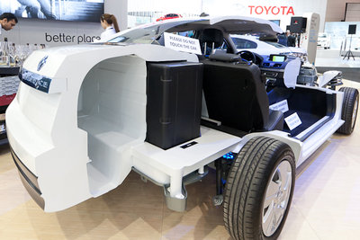

Interestingly, so far as I have heard, with the motor/inverter stuff in the front and batteries in the back, the Fluence has been designed to give an even 50/50 weight distribution front-back axle. Not that this will necessarily make it 'agile', but it should be good for general comfort and stability dynamics. It is a significantly longer car than the Volt or Leaf, with bigger overhangs, - not that this necessarily means more space (the battery takes up some of that length, rather than being 'under' the occupant space) but it would mean a slower and 'bigger car' type of suspension experience. That suits me down to the ground, because I just like quiet, gentle plodding. My high-speed antics are a good and over part of my youth (now I recognise how much that actually costs, both financially and safety)! The Fluence is the heaviest EV I know of - of course the Volt is heavier because it is carrying around an extra engine, but likewise it can put down both the motor and the engine's power. So overall, the Fluence will be slowest!
Remarkably, for such a large car, I'm lead to believe the Fluence's aerodynamics are actually better than the Volt and Leaf. It has a CDx figure of 0.67m^2, which appears to translate into a Cd of 0.26 (cf. Leaf 0.29, Volt 0.28, Prius 0.25). The smaller Renault Zoe EV, just released, has a CDx of 0.75m^2!
So, aerodynamically, it seems fairly clear that putting the battery within the length of the vehicle, rather than underneath it (thus raising the height of the vehicle), is a good thing. But overall, for relative weight it makes the car heavier (if simply because of the extra length of the chassis), which is generally a bigger disadvantage overall than the aerodynamics are a benefit.

Here's how the battery sits:
