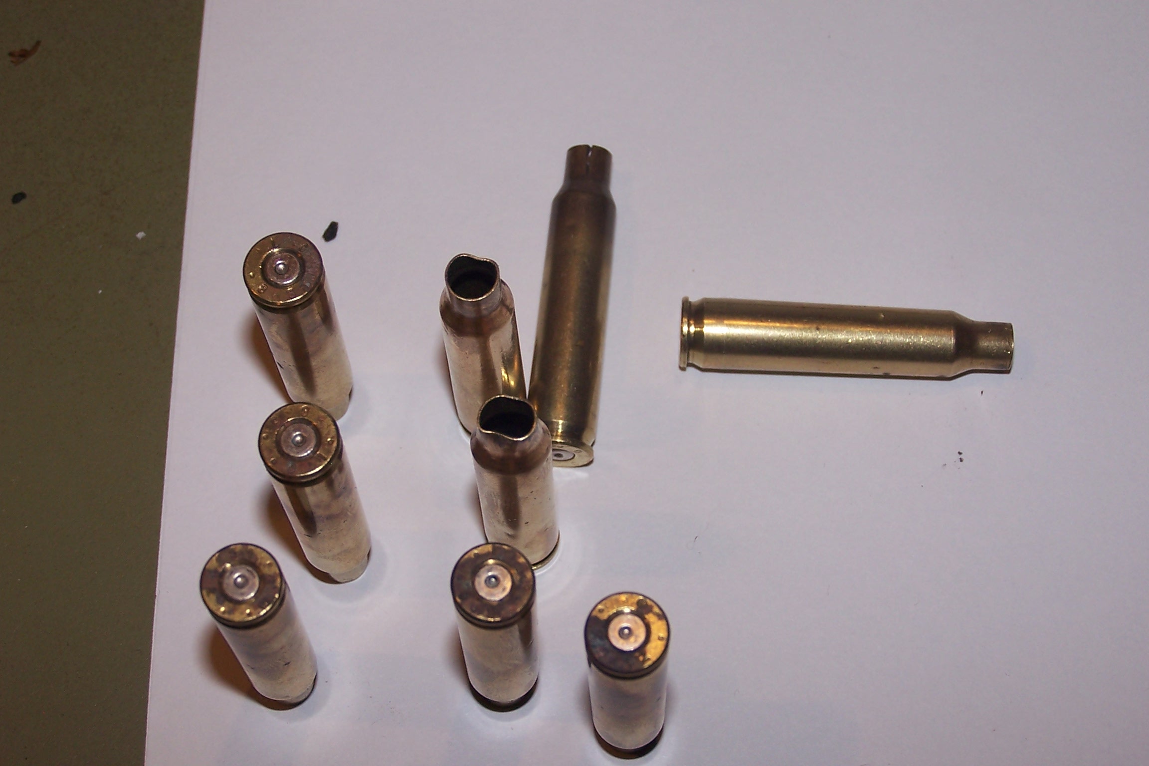

During this process, I did get a few to cull, and here is a picture of those - I actually found a few more baddies in further processing as well. I hope you can guess most of the reasons I culled these, but these don't show every reason you'd cull out a shell, not hardly. Dents in the body - big ones - cull - they'll have reduced capacity. If you're really desparate to save those, fire form them with a light load, and put them back into the process, but I don't. Super bent in any way - after you form them they might look alright, but they will have been work-hardened and may split on the next firing - ditch them. Corrosion that tumbling didn't remove and that doesn't scrape off easy with a fingernail - ditch. Now the one on its side vertical had a split neck - obvious ditch. The one laying horizontally - look closely near the case head. See that sharp step up in size? It's an indication this brass is on its last legs and getting thin there - or fired with a hot load in an oversize chamber - that's getting risky - ditch it. I found a few more heavily dented or corroded ones later in the process. Use every time you touch brass to look for issues with it, and act accordingly, or don't blame me for your accidents. This is really the main safety issue with reloading - don't use bad parts! Simple as it sounds...it bears repeating over and over. The trashcan is a reloaders best friend.

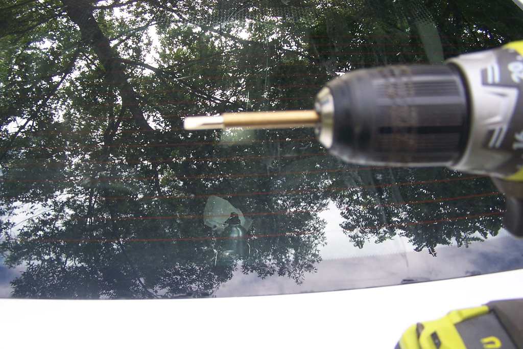

The next step here is to clean the primer pockets. I want this ammo as reliable and safe as I can make it, since it's going to be shot by noob journalists on camera, for one thing, and out of several different guns. While not strictly required, for either safety or any but hyper-accuracy, I just do this, it's simple and worth doing. Primers have three little legs that seat against the bottom of the pocket and a precise amount of crush is required there to get uniform primer behavior. If there's junk in there - no way the next primer will be seated at the same place the last one was - all 3 legs won't be set the same, leading to inaccuracy and worst case a misfire. So we do this here on all rifle rounds.
To do this, I made a special tool - makes it easy and quick. The tool is just a piece of 1/4" brass rod turned down to .170" (about the size of a small rifle primer) and ground with a screwdriver tip to spin in the pocket. You don't have to use a drill or drill press - this stuff is crusty, brittle, and comes right out easily even if you just hand hold the tool. But doing a few hundred rounds, heck, I use the drill. There are other tools sold for this, but this is so simple to make, why? You could also file down a small normal screwdriver, but you want to be careful then to not scrape brass off the bottom of the primer pocket. Sadly, this is out of focus, but it gives you the idea - nothing fancy here. Here's what the process looks like in action - I find it good to learn from how someone good at it "holds their mouth" - this communicates about how hard to push, how long to spin and so forth better than mere words.
