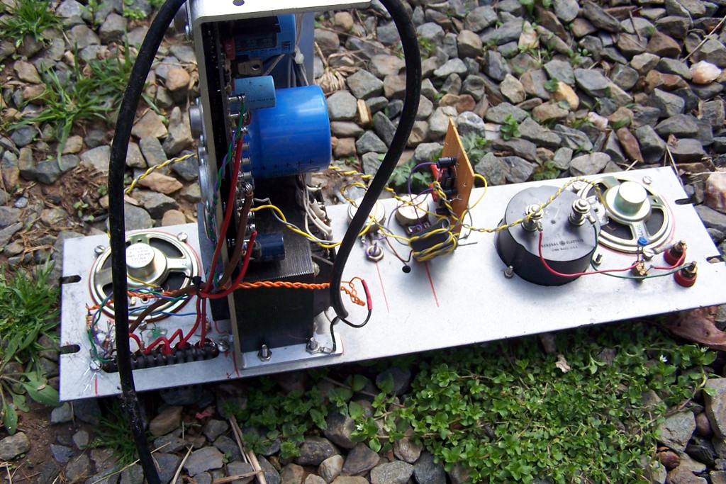

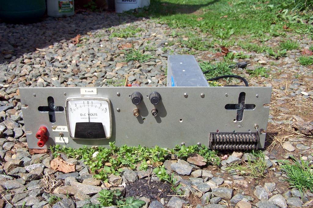

Edit: Here's what my new one looks like. The panel had the meter in it when I got it, but I added a lab analog supply (+5, +/-12v) and the little lm386 kludge and speakers from something out of a dumpster. I have some large ferrite beads here. I use them with several turns of both power wires through them to isolate HF ground loops. This way I only need the one power supply to run a bunch of things on the rig.
