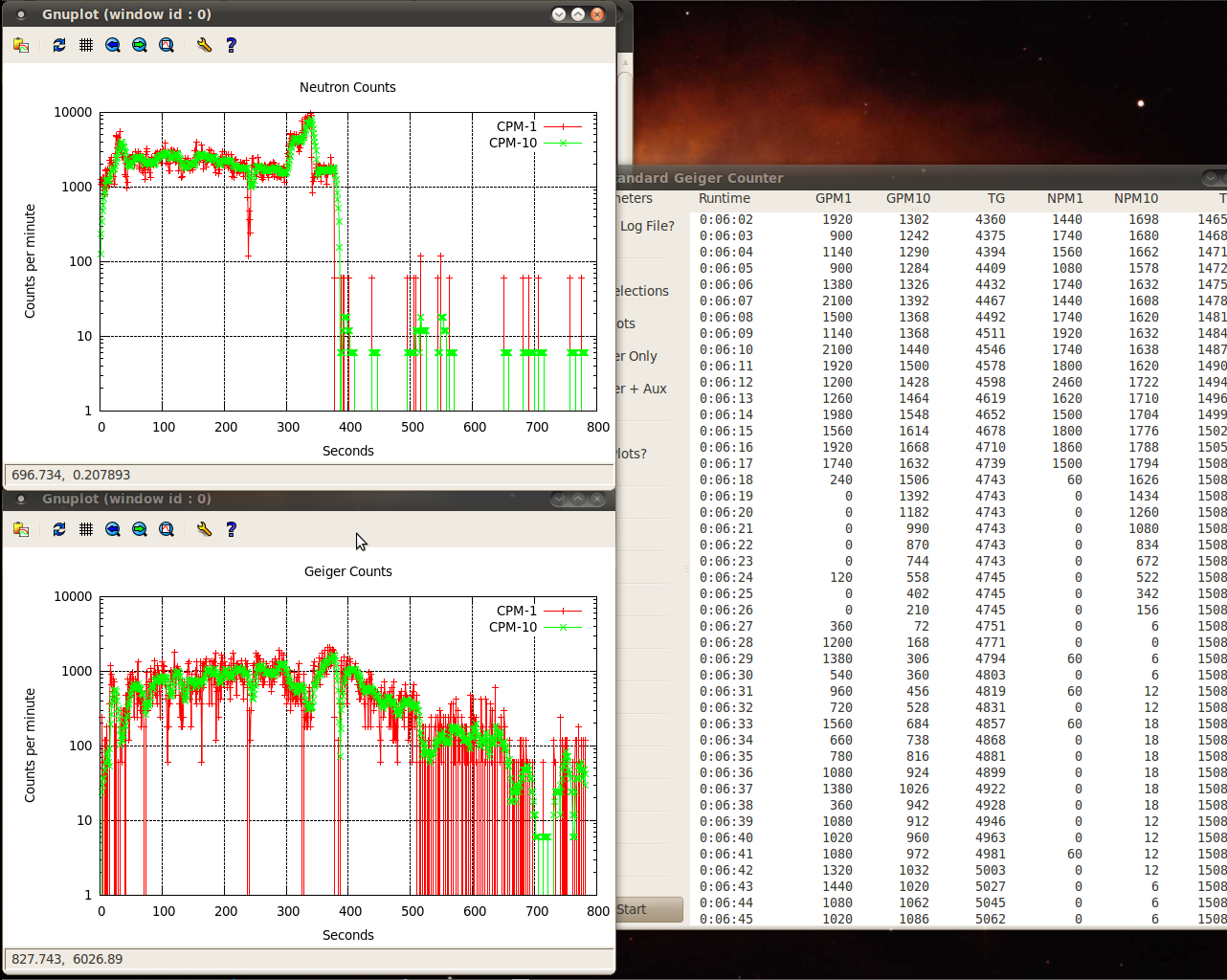

Matching action to words, I just went down to the lab and made another run. Looks like my vacuum gage got flakey - but a reset seems to have fixed that...
At any rate, here's the results:
Std counter output screen.
You can see where I killed fusor power at about 06:17 or so, then put the activated silver on the counter. I scrolled the text log to that point in time so you could see that.
I let the silver decay until about 500 seconds (or slightly after). I let the counter count background for 10-12 seconds, then put on the indium, which isn't activated a ton out of my lab background today, which you can see at the end - after 700 seconds or thereabouts - but it was definitely above background a little and decays slower than the silver. Extrapolating the straight line silver decay (on the log plot) back to the instant of fusor turnoff gives us something like 1200 cpm at that instant through the glory of data averaging -- even at 1k cpm, the data is a little noisy due to randomness of silver decay.
Before that, you can see a place in the run where the neutron counter was reading very high for a little. That was me pulling out gas trying to get that mode again, and may account for the slightly higher than my average silver activation, though this time (despite pulsing and presumed some emi) the geiger counts didn't rise with it. This is not what I saw the other day at all, at that time everything went together, and this time the view into the tank didn't look the same either - looks like I *didn't* replicate "the mode" in actuality. Now I will have to try again, perhaps after letting in some air...which had to be the main contaminant last time. This time, it'd been sitting at e-8 mbar for a couple of days, so it had to be pretty clean in there. That's my normal situation, I leave the pump running all the time, as with the forepump only coming on as needed, it only averages about 30 watts out of my mains - my solar system can handle that pretty well, and it seems worth it for repeatability (except perhaps in this case - it would explain why I hadn't seen that before, though).
The neutron detector used in this plot is the one we calibrated up at Richard Hull's, the Hornyak detector that sees high-energy neutrons only. I have it propped up in a fixed position on some of the side ports on that side of the tank - it's about 1.5" from the outside shell of the fusor part. It seemed to be working just fine, and to agree with the 3He and B10 tubes I had on the stereo monitor. Obviously we need a many-input counter hardware device...someday.
You can also tell on this plot that I had it go "out" a few times - that's shown by the geiger counts having red bars to zero. I was playing with the gas in and out and overshot a time or a few.
Nice to have this going to help operate the things, real good feedback - remember that since these plots autoscale in both X and Y in realtime, during the beginning of the run you see a lot more detail of what little data you have so far.
I did see some neutrons from the secondary grid this time (and last time). I'm guessing that with all the other noises pretty well taken care of, I can now see a little lower neutron count rate from that (it's still pretty near the floor, but definitely there).
So - I refute EMI thus -- see above. That's real neutrons most certainly, and this verifies that all the measuring gear I've so painstakingly built and refined over the last couple years works just fine - still, again, every time.
