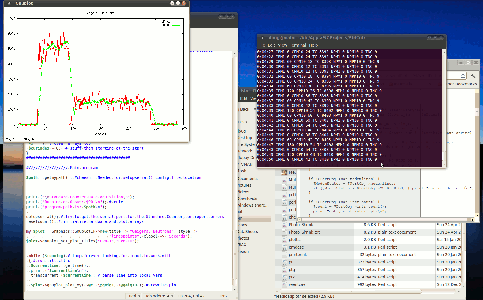

Is coming along, for linux first, then windows if there's demand for it from people who don't mind installing perl, cygwin, gnuplot etc on windows. Right now, I'm just doing the basics of getting the Standard Counter discovered (out of all possible USB devices) automatically, set up, and data brought to the PC for a rather simple plot (at the moment). I will be adding a GUI to handle things like what to log in a logfile, plot scalings, and optional things to plot, like smoothed data, the aux input for neutron counters, and so on. Lots yet to do, but this is what things look like now.
This shows background, a lamp mantle, then a CS-137 spark gap, then background again. This just starts plotting at time zero and compresses the X axis as required during a long count. Obviously there should be some other options, but I'm just getting the functionality chunked right now.
I'll add log scaling for the Y axis and some other stuff of course. From here, it's quite trivial to also shove this into log files (named by time etc) or a SQL database, though the database would have to be created with a known table definition and so forth first (so other programs can all be putting stuff in the same database, different tables, all timestamped together and all that happy crap).
