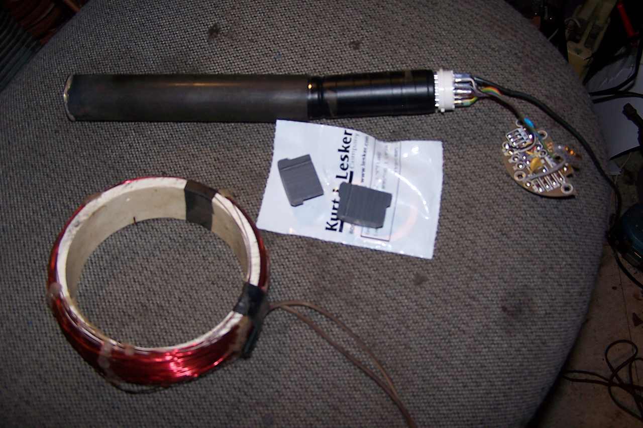

Quite awhile back, we bought some things from Eljen, among them was a "professional" hornyak button for detecting fast neutrons. I had put it on a dual cathode super sensitive phototube from a PET scanner and tried it with marginal results, primarily having trouble with EMI in the setup I had then, along with (then) a poorly performing fusor as a test source. Well, the EMI issues have been fixed at their source, and the fusor is kicking butt and taking names, so I resurrected that project to see how it does now. Being zinc sulfide based, now that I've exposed it to light for these pix, I can't use it for about a day, but that's fine - glue needs to dry anyway. The phototube is an interesting super-linear one I got out of a super research grade mass spectrometer BillF scrounged somewhere that I don't plan to bring back up in its current form anyway. Not a photon counter, this tube, but a decent one I believe. I plan to put it in an old CD ion-chamber detector I tore all the original parts out of, since those are "as deaf as a post" and I don't have any need for it in the original form. But, nice box, nice meter.
Here are the parts: That's a steel tube I welded a thin (.010") steel end onto to let the neutrons in. the tube wrapped with black tape with the Hornyak button on the end, coupled with silicone optical grease. I made a PVC plug for the back end to let the wires out without letting light in. It's glued with Permatex high temperature silicone goop, which I've found is nicely light tight to the wavelengths these tubes are sensitive to. The big coil you see is for degaussing the whole affair -- phototubes don't like even weak magnetic fields. And here it is assembled. I'll get in a test next fusor run.
I plan to make a logarithmic converter to drive the meter, and to add a speaker for any pulses this produces, and have a nice portable neutron detector - probably won't be real super sensitive, but we'll see when I test it.

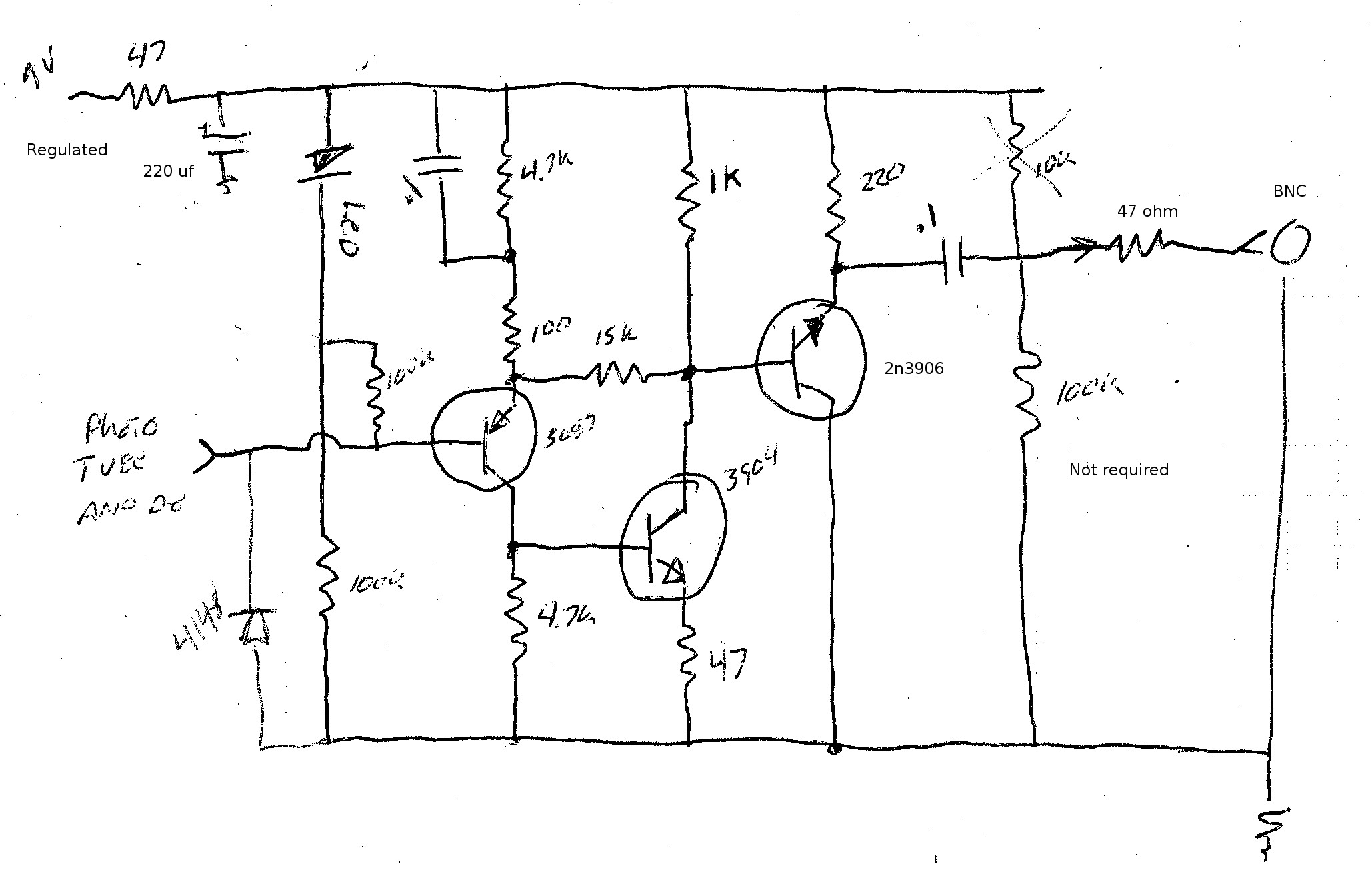

Re: Hornyak -- preamp
I've been fooling with preamp designs lately, and so I made one just for this, as it was desirable to have more gain, along with the ability to drive longer cables. A little more speed is nice, but in this case I actually sort of slowed the preamp down a little to better match the long decay signal from the hornyak phosphor. Here is the schematic.
I'm really getting nice results with that LED bias scheme, so I'm using it again. You may need to hunt a bit to find a low enough forward voltage led for this, I found the yellow one we used on the standard counter was just right, so I'm using that (1.641v with the 100k bias resistor, or about 100ua). Note I didn't need a coupling cap on the input - I connected straight to the phototube anode and used the tube with a negative supply. I only needed one protection diode (if I even needed any) as it can only pull negative of ground.
I used our regular CCFL, and no doubling for this, so it would need 9 volts to get to the 8xx volt output voltage, leaving me a nice supply to also run the preamp off. I wanted fairly high preamp volts to be sure to be able to make full 5v CMOS levels (it makes about 8v peak). Due to burning some more current in the input xistor, as well as the cable driver, this isn't a real good one for batteries as is, though it does perform well over wide power supply voltages due to the led trick. Probably 5-6 ma.
I wanted more gain as this isn't a high output thing, and the goal was to direct drive a cmos counter input on the standard counter (which is a schmitt-trigger input, tightly defined levels). Threshold such as it is, is set by the gain. This almost completely ignores some pretty fierce X rays, and also misses marginal neutron collision events, making it kind of numb, but on my fusor at roughly 1 m neuts/second, it counts at right about 1k cpm -- easy conversion to do in your head, so I like it as is, and it's way out of the cosmic background also.

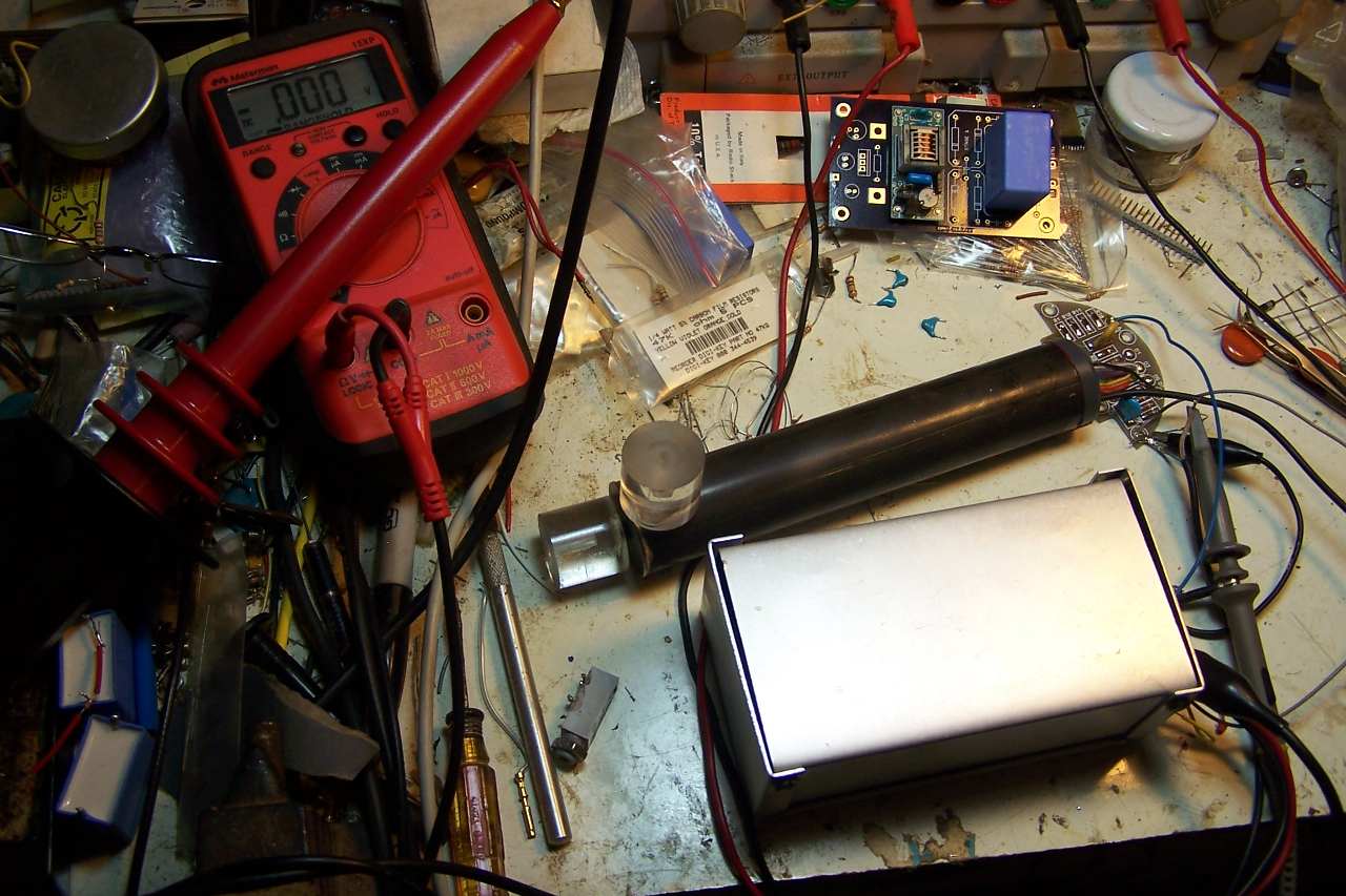

I built this, the detector head, and a regulated 9v supple and 880v HV supply into an old yellow CD-715 box. Now I'll have to come up with a trick to drive the meter -- the plan is to take this setup up to HEAS and put it on Richard's fusor while he runs and kinda get a demo done, and a cross calibration with his lab out of it, if he's willing to let us do that.
I'll get some more pix up of the "finished" thing soon. I applied what I call optimal effort to this. I didn't bother with "pretty" or even "rugged" or "slick" - I didn't know it was going to work for sure, so I did the minimal kludge to prove that first. If I make more (and that's looking likely now) they'll be nicer on the eyes and better other ways. But until you know it's going to be worth the effort, a good engineer won't waste man hours on it.
While not as sensitive as the Russian tubes, this is completely free from spurious counts -- they aren't -- has a super low background - they don't, doesn't temperature drift (they do), and by far the most important - I can get phototubes (ones better than the one I used are cheap) and make hornyak buttons in any quantity at any time, forever, where we are dependent on luck to get those Russian tubes...
Reliable neutron detectors, cheap, for all -- it's finally in reach! This setup is even portable, though I am running it off a wall wart at present.

Re: Hornyak detector build - guts
This is using the preamp shown above, our usual CCFL and lm317 HV power supply, this time not doubled, but filtered with a series 10k and a .47 uf cap (lots of filter), and the Hornyak head. Here's what the guts look like. I'll see if I can figure a trick to make the meter read in the bargain -- it's a nice meter they used (but I haven't found out the full scale current, I'd bet it's pretty low). This is running off a 12v DC wall wart for now. That phototube really eats some power in the resistors -- a 100ma one wasn't quite enough to hold up at full DC HV output.
As I said above, this wasn't a high-effort build. It was more like "can this work?". I knew that with the sensitivity of the preamp (a few mv to get a full scale output) I'd have to at least take care of EMI issues -- the fusor makes some, and the CCFL does too. So I folded up some Cu flashing to shield the power supply (and heatsink the regulator) inside the old CD box. I made a clamp for the sensor with another piece of the same steel tubing. As you can see, the preamp is just held in there with one screw for now -- I'll be fooling with that more to get a meter output and so on, so no point in super-mounting it up yet. Obviously, a quality build would use terminals, some more heat shrink tubing etc - but this is just a prototype, not even an "alpha" much less a beta. A real one such as we might make for sale later would of course be a lot nicer (see standard counter for example). By making our own hornyak head, using very thin plexiglass sheets laminated with ZnS:Ag and epoxy, we should be able to about double or triple the sensitivity per square of this, and by making it bigger, get another double or so sensitivity. That would be in a real comfortable range for fusor type things. In a low output, pretty stable run on my fusor at around 1 million neuts per second, this counted about 16.7 cps, or about 1000 cpm -- way way above its cosmic background. But that was with a working fusor (even if not running at its peak), and right up against the tank wall almost. A beginner might want just a little more sensitivity, dunno. This will be just fine for fusor tuning with the standard counter as the data aquisition and logging for me, and that frees up our more sensitive, but also bulkier and more delicate (not to mention expensive) other neutron detectors for other uses -- this is fine for what I need here. Since I'm going for ever higher fusor output, the numbness of this is actually an advantage, along with the log plot feature of the std counter software - I want to see movements on that, not piddly few-percent improvements!
Of course, I kept the goodies out of the original CD box, especially the electrometer tube, high value resistors, and ion chamber. The rest might wind up as junk my wife recycles. Nice box though.
