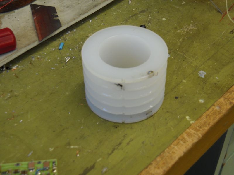

While testing our home made PSU block I slipped with the scope probe on the control electronics sending full audio power ie clipping severly to the multiplier stack transformer. The DMMs monitoring showed just over 240kV when there was an awful thump from the tank and the positive supply fell to 125 volts while the neg supply was at the correct 65kV. and now the audio amp is frying itself so out of the oil it came.
Closer inspection showed all caps and diodes OK but a very small dark spec on a part of the positive supply transformer secondary
The winding should be around 40H but it shows a few mH --a shorted turn or two
so now I have to rewind this secondary

So the secondary coil for the positive supply seems to be the only casualty.
the coil former had some nasty black bits on it that I cut off

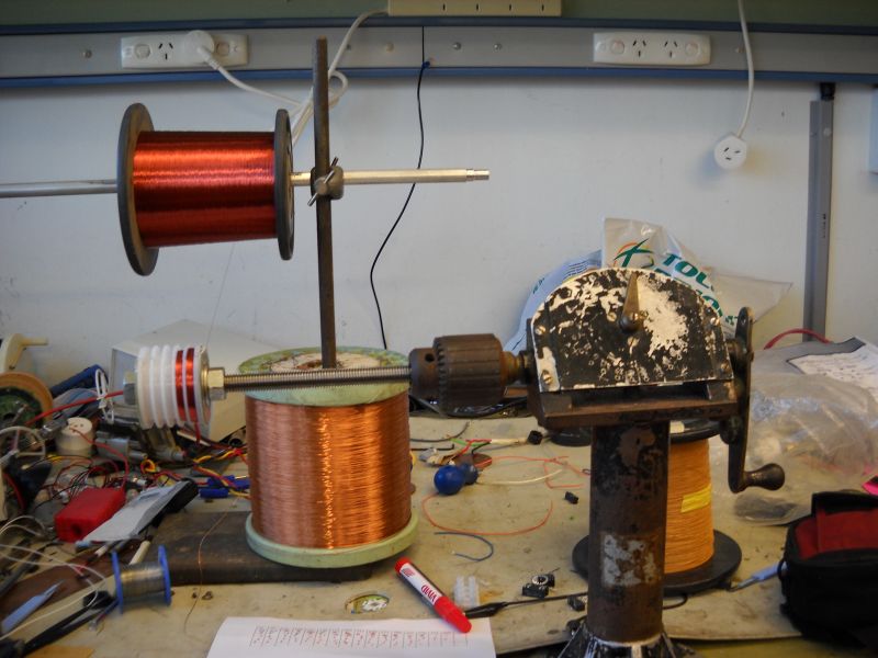

then of course 2 couple of hours of hand winding
two transformers on the one set of :U: cores one each for the negative and positive X-ray tube supplies. each transformer feeds the centre of a 18 stage multiplier ie 9 each way from the tramsformer input.
Max output volts from transformer is supposed to be 7kV giving each psu 126kV minus a bit for diode drops etc.
PS cores are gapped to 0.7H on the secondary side with the primary having 29uH which at 31kHz = approx 5 ohms

Cute little coil winder. I have a version of that with a motor and a footpedal I sometimes use, but I also built a jig for my lathe I use a lot more (running slow, of course).
Someday I plan to make the cam jig for the lathe so I can do that "universal" winding thing for lower stray capacity. I use the lathe all the way down to #40 wire, with my hand on the
wire feed to avoid sudden tugs on the wire that would break it --kind of like the arm on an old RR tape deck to help with constant tension, same idea. In low gear, the lathe starts and stops slowly, making it easy, and when I goof, I can make it go backwards to unwind the goof part and do over. Of course, for single layers, it's nice to use the lathe threading settings to get "just so" wire spacing -- pretty much whatever you want there. As long as you keep a little tension on the wire, it will hold till whatever glue/wax/shellac/glyptal you use to keep it right gets hard.
Very nice for RF kinds of things.
Question -- how does that system handle getting from one "pie" to the next without having an insulation problem like you have if you just come off the top of the first one to the bottom of the second (which means a wire alongside the whole second pi to be arced to from the top of the second pie). That one has been an issue here...with the HF stuff having so many volts/turn.
Nice to know there's someone else here who winds their own coils...not common, but a very useful skill :) I've been lucky to collect a large amount of magnet wire in nearly all sizes there are, so I go for it. With the price of copper these days -- it's an investment!
