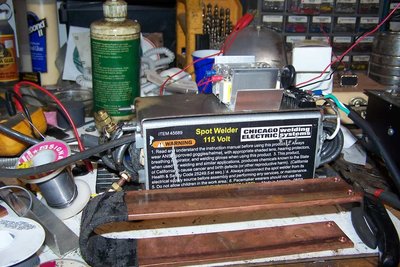

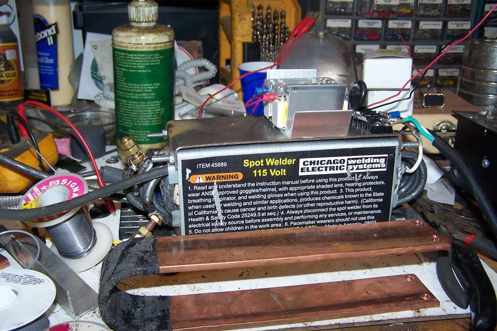

As I'm just staring out with this, I made a fairly kludgy power supply for it, which is nevertheless complete overkill for this job. What I did was to re-wind the secondary of a spot welder from Harbor freight with about 7 turns of # 6 wire, and have enough taps so that I can have from .5 turn to 7 turns in 1/2 turn increments. I am using about 3 turns for the Al job, which is a bit over 3 volts on the heater, and have just a very simple control - solid state relay and pushbutton (and a lot of MOV type kickback protection on that). In use, it takes a few seconds to melt the Al, and another couple to reach fast evaporation temperature. I do pre-melt the Al before doing the deposition run. letting it flow into the spaces between the 3 wires that make up the heater. This seems to give the best results, and since I make more than one run per loading, it's what all the subsequent runs are anyway, so this is a little more uniform way to go about things. I would bet that a smaller transformer (like a rewound MOT) and some better control than bang-bang on/off would do better for this and be smaller too.

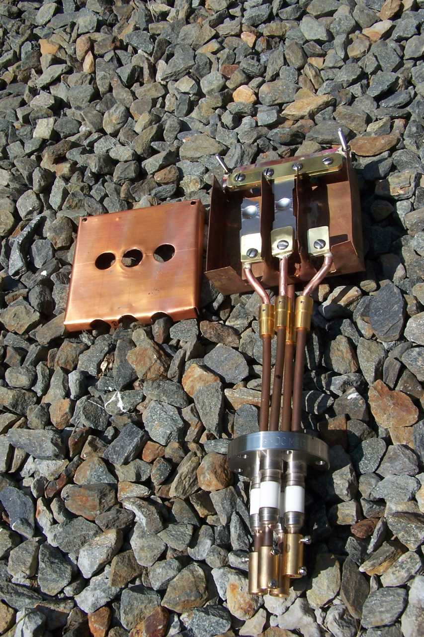

I built a thing that holds three boats and has a shutter in a Cu flashing box to keep most of the heat and excess vapor, but it hasn't made it into the tank yet, as I'm doing mostly fusion in there at the moment....Picture later when I have a clue if it even works -- "looks good on paper" but who knows. The idea behind that one was to use the shutter to control preheat and so on, and get more accurate deposition, as the shutter can be closed fast with a small solenoid (I have some very small ones that seem not to mind intermittent use in vacuum and don't outgass much, as long as you don't get them hot).

Evap source under construction
Here is the new boat source in the process of being built. Yes, a kitty cat stepped on the boat on the left and broke it. I later fitted the top with a shutter. Provision is made
to spot weld a type C thermocouple to each boat to have some closed loop temp control and ramping. Work in progress, not tested much yet.
Rewound spot welder transformer for evap
Here's the spot welding transformer I rewound for this work. Overkill by a lot, but it works. MOT rewound in a similar fashion is about right. Low resistance is key, as if you just
try to use a too weak source overdriven, the volts are held low till the heater starts getting hot, then rise too fast as the resistance goes up in the heater faster than you can turn
the input down.

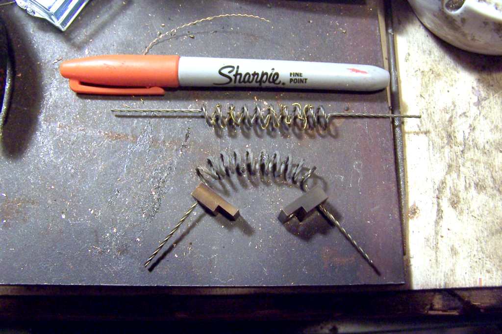

Wire evap sources
Wire evap sources
This is what I'm using now, when I do this. The lower heater has the clamps that screw to the feedthrough rods on it, and is loaded with pure Al (or it was pure when I removed it from the tank, now it looks a bit dirty). This one has made maybe 10 or 12 runs and been loaded 2 or 3 times. Above that is one wound with gold ready to go when I have the guts. I will pre melt the gold with a dummy glass target and do one evap on that target before "going for the gold" on something more real.
