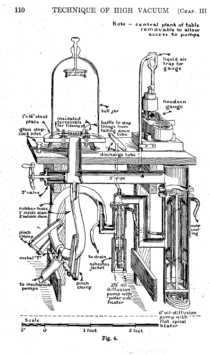

Last I really like Doug's slick idea of including a discharge tube in the foreline, this could be very handy for tracking down leaks etc. You should also be able to find a copy of the pump manual on the net, reading this helps a lot.

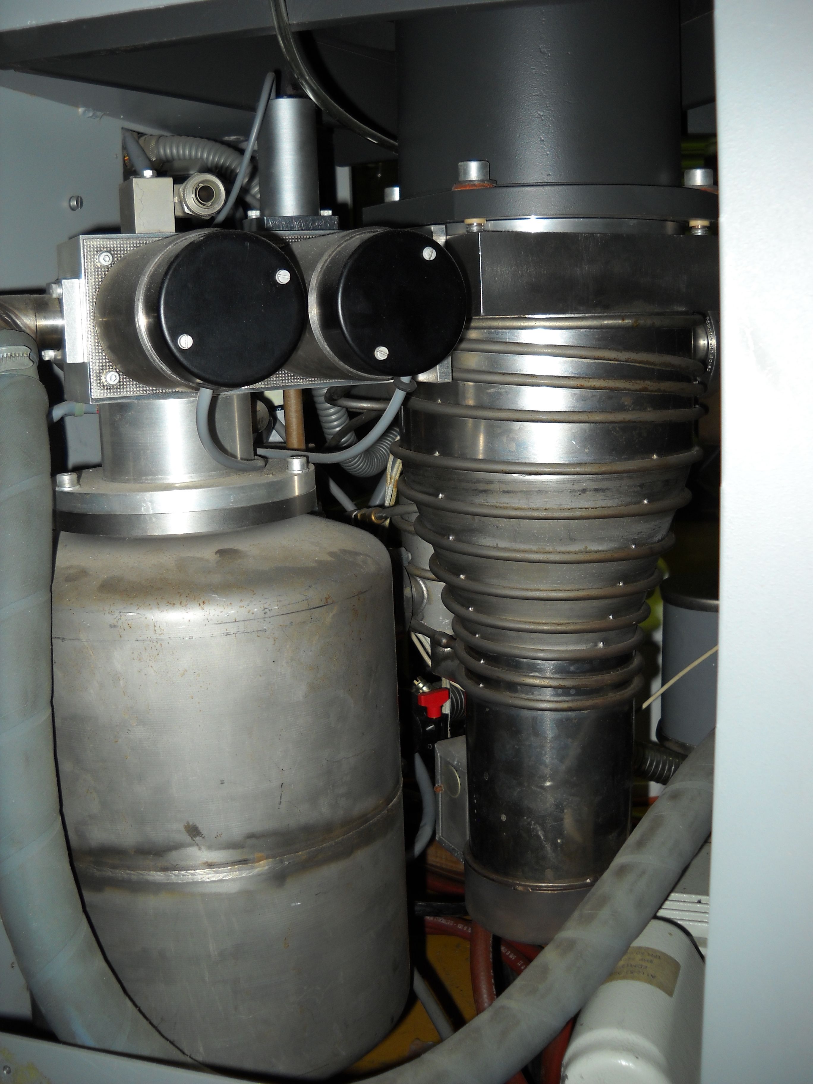

My SEM cycles the forepump as you cant get a pic around the 1um level with the fore pump running. there are three valves in the pump line one isolates the backing bufferspace about the size of the reciever in Jerrys quite pump project. the buffer spce is pumped down to 3 by ten to the minus 2 millibar and the isolation valve is closed. The pressure is allowed to rise to 2by ten to the minus 1 millibar when the backing pum is started and the pump vacuum is measured and the isolation valve is only opened again to the bufferspace when the mechanical pump has got down to the 3 by ten to the minus 2 millibar level. ( I presume Philips did it this way to stop mechanical pump oil backstreaming into the bufferspace). With this arrangement the backing pump is on for around 5 minutes every half hour. The third valve is to allow the mech pump to rough out the sample space with the gate valve above the diff pump shut and the ioslation valve shut so the bufferspace is backing the diffstack
Note the buffer tank on the left of pic

MY SEM has around 40 viton gaskets to deal with, so the leak rate is right up there ( the Backing pup is an Edwards 12).
We have noticed the reduced power load @ work as we replace diffstacks with turbos. Every pump has its own backing pump
I'd love to put in buffer spaces on all and use one or two backing pumps for the whole lot, and another system the same for roughing chambers
one day I'll get my way, the power savings would be immense as any type of high vac system (except ion pumps) the backing pump draws the most power
