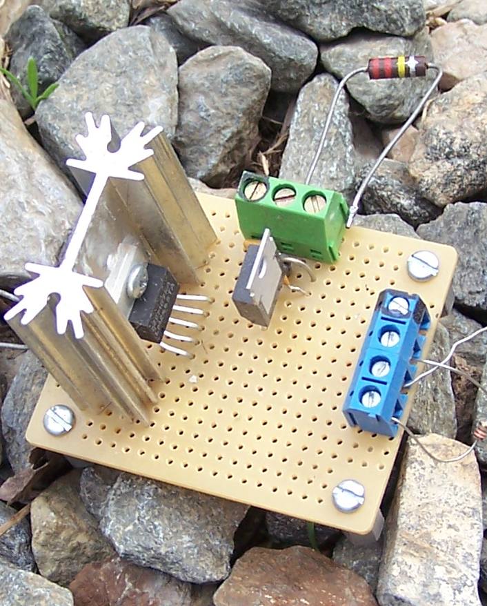

Here I will be attempting to use them as beam power pentodes, a different story altogether, and controlling the amount of grid drive volts I need by controlling the screen volts. More power gain since the driver will be this little TO-220 chip from VGA monitors and really can't put out much power (about 1 watt). I've built and tested the driver -- it's phat to 75 mhz or so, and so suits the driving signal source, an arbitrary waveform generator, a DDS-3X25, which by the way is a pretty nifty toy itself.
In windows (or an emulator) you can just draw waveforms on the screen and have them output at any frequency, all in realtime. Neat!
Like all things CRT related (yeah, I know I've put out this rant before) the drive chips are going the way of the dodo -- so I bought 100 of them for future needs. Lm-2445 is the number, and here's what a 3 ch DC-75 mhz driver looks like. Takes about 3v in for 80 or so volts pk-pk out.
Vid Driver prototype
