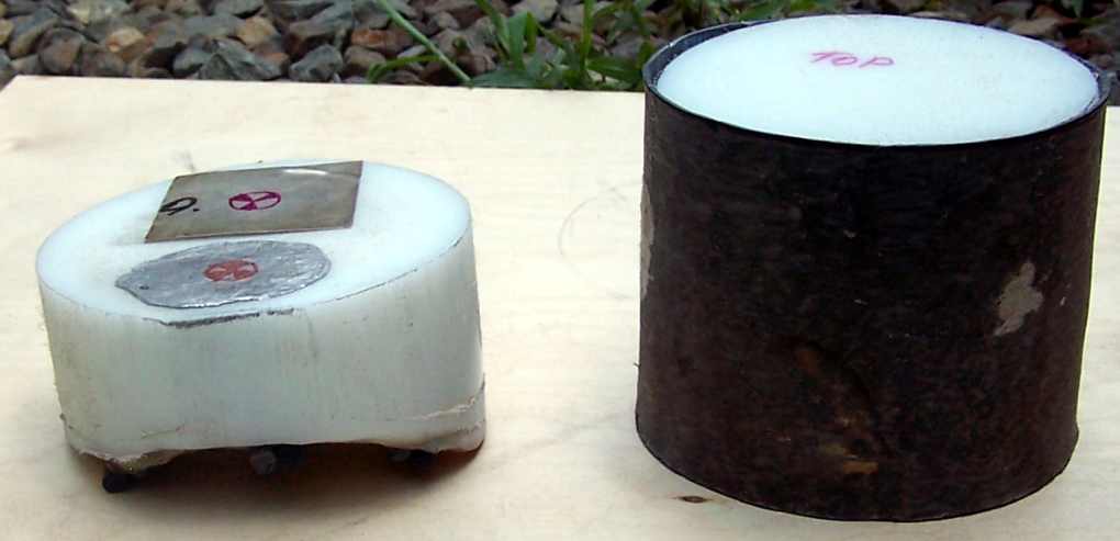

I've not done any hard to do or fancy activations at this point, but we use Silver and Indium in a moderated "neutron oven" here as a backstop for our other neutron detectors. These low hanging fruit have nice, short half lives so they are easy to read out, and large cross sections so they are easy to activate in the first place. The big advantage you get using these is they they have no dead time effects, and no sensitivity to EMI, both of which can easily fool real-time counters and detectors. You simply cannot fake it with silver or indium -- you have to have neutrons or they don't get hot, and they catch them all pretty well. So I consider these the gold standard for neutron measurement in the flux ranges we are getting here. Gold itself works too, but is fairly "numb" due to the longer half life it has. And besides, transmuting gold into mercury is kind of going the wrong way, eh?
Above is our little oven. This is made from 4" UHMW HDPE rod stock, a good moderator, and is sized to allow some neutrons in the resonance energy range to get to the samples, where they tend to have better cross sections. The bottom piece was cut to fit over the cylinder sidearm my fusor runs in. and I had to add some carbon rod spacers under there to keep it from melting. The top is just more of the same stuff, wrapped in lead so not so many X rays get out into the room (normally there's lead over the top, too). The samples shown are a silver sheet that just covers the pancake detector we use for counting, and a pea sized bit of indium I got from RotoMetals and just pounded flat with a hammer. The indium doesn't get as "hot" due to its longer half life, but has only one half life, so it's easier to measure if you get things hot enough. Silver has two possible isotopes that get made, with two different half lives, so it's a bit tougher to get any kind of absolute numbers out of it. But due to that real short one, it's also the one that really makes the counter sing after a run.
