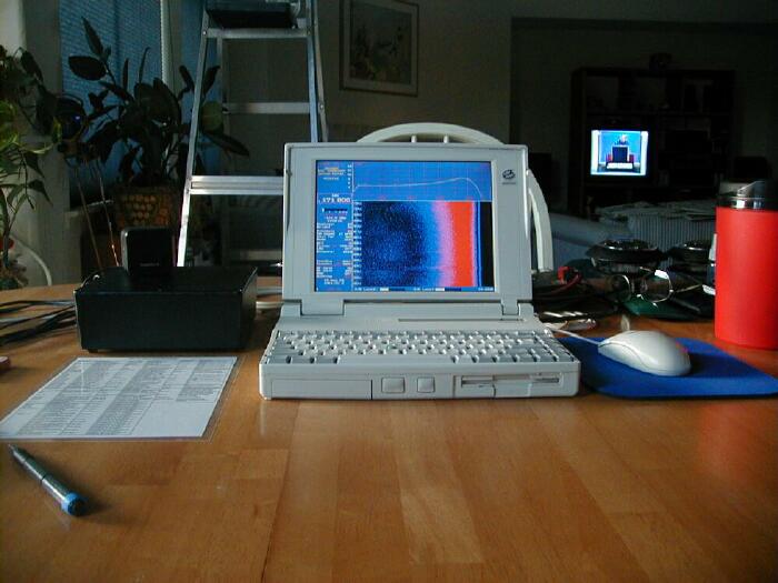

Re: Atomic Clock
I use the QST article based on Brooks Shera's project. At the time Brooks was working
at Los Alamos and still corresponded with me to help on some of the minor points.
I use its output (10Mhz 1 V PP) to drive my DSP-10 (another QST project combination
of computer and computer driven and FFT box) With the Shera standard driving it it is so
tight in frequency I just key in the requested receive frequency and THAT's WHAT I GET.
