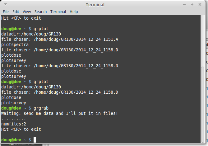

grgrab is a command line program. You just say that to a terminal, and it finds the serial port (reports that) and goes into wait mode for you to tell the unit to dump its data memory. When done, it will ask you to hit <CR> to exit. No harm is done if you download the same things twice, other than to date stamps in the filesystem. It uses the unit time/date as a filename regardless, and always puts them in your "home" directory under a directory it will create called /GR130 if it's not already there.
This of course, makes it really easy for grplot (which does have a minimal gui for file picking) to find them for plotting. The unit can make three types of files, which get one letter extensions depending on what type they are, so the code knows what type of plot to do on them - the rest is completely automatic, autoscaled and so on, and with real units. This code depends on your having set up the unit for 1 second time resolution in survey mode, and 5 seconds and Sievert units in dose mode,

This is what it looks like in use from the terminal.

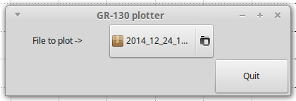

Once you invoke grplot, you get this for a GUI - just enough to leverage the system file chooser button to get to the files. While you can navigate that anywhere, it already knows to look where grbrab puts things.
The plot program interface - all you do is choose a file, gnuplot does the rest (from a translation by perl).

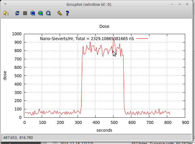

Choosing a file will result in a plot from gnuplot, perhaps like this one, where I started with nothing near the unit, then placed the Cs137 sample on there for a bit, then took it back off. The unit was in "dose" mode, and set up to save that data in its memory for later dumping via grgrab.
background/Cs137/background, in nanoSieverts

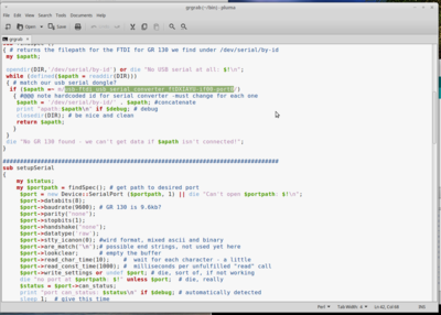

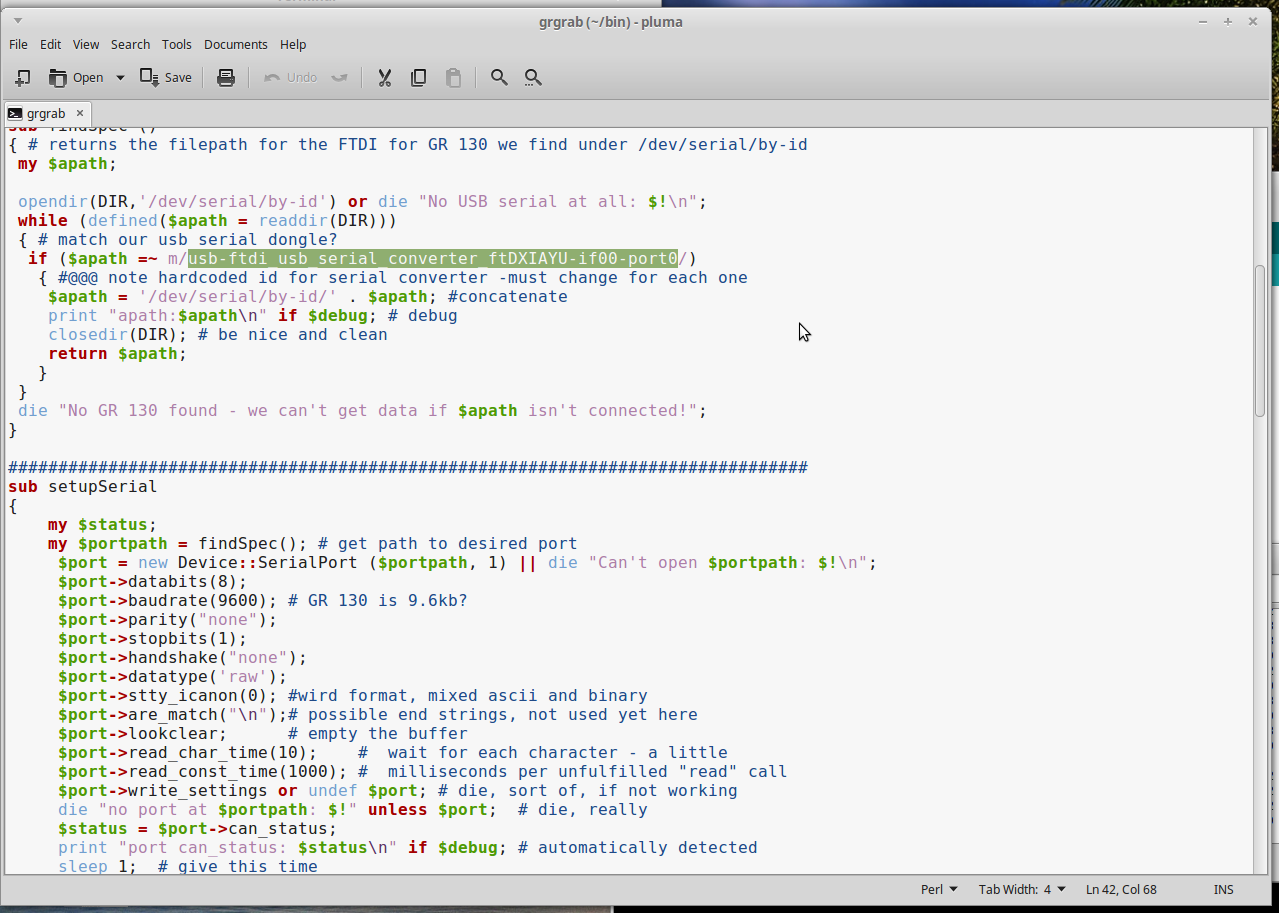

Here is the line you'll have to change in grgrab for linux machines. It's the id of what you see in /dev/serial/by-id/ when you plug in your own serial<>USB converter. I highlighted the virtual file name in the match, it's on line 42 of the code in the .zip above.
What to edit for linux and your own GR130.  Click the pic for a readable version.
Since that is a lot of typing to get right, what I actually do is this - look at the /dev directory with no serial dongles plugged in. When you plug in the one you're going to use for the GR 130, a directory will appear under /dev called /dev/serial (full path) and under that, /by-id. It will now have a virtual file with all the identifying info about your dongle. If you then right-click that file and select properties, you can select and cut-paste the long name into the code instead of the one shown here, which is only right for the one I own (and have taped onto the GR130 cable so I won't get them mixed up later).
