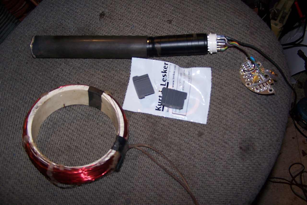

Quite awhile back, we bought some things from Eljen, among them was a "professional" hornyak button for detecting fast neutrons. I had put it on a dual cathode super sensitive phototube from a PET scanner and tried it with marginal results, primarily having trouble with EMI in the setup I had then, along with (then) a poorly performing fusor as a test source. Well, the EMI issues have been fixed at their source, and the fusor is kicking butt and taking names, so I resurrected that project to see how it does now. Being zinc sulfide based, now that I've exposed it to light for these pix, I can't use it for about a day, but that's fine - glue needs to dry anyway. The phototube is an interesting super-linear one I got out of a super research grade mass spectrometer BillF scrounged somewhere that I don't plan to bring back up in its current form anyway. Not a photon counter, this tube, but a decent one I believe. I plan to put it in an old CD ion-chamber detector I tore all the original parts out of, since those are "as deaf as a post" and I don't have any need for it in the original form. But, nice box, nice meter.
Here are the parts:
Parts before assembly

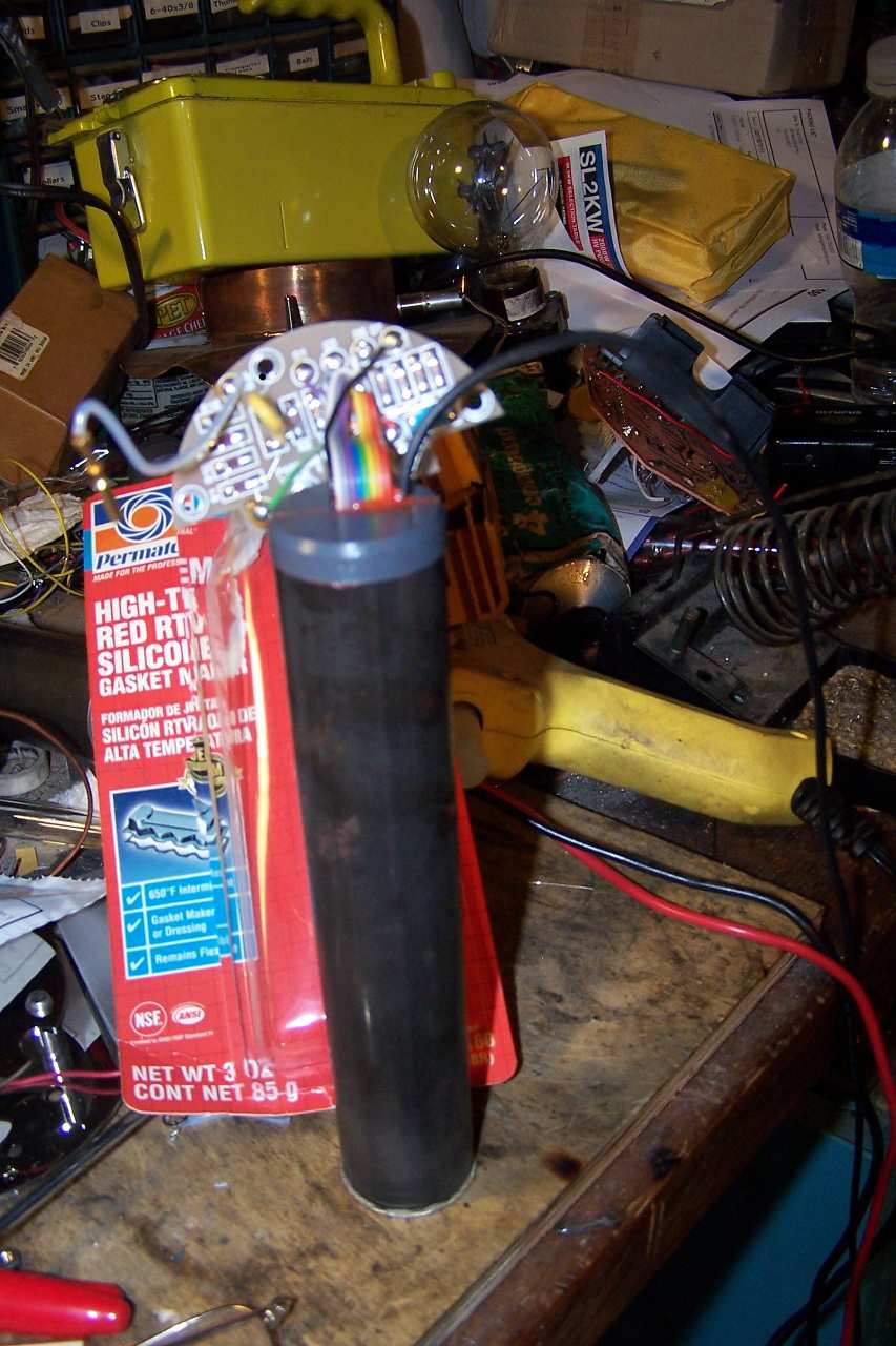

That's a steel tube I welded a thin (.010") steel end onto to let the neutrons in. the tube wrapped with black tape with the Hornyak button on the end, coupled with silicone optical grease. I made a PVC plug for the back end to let the wires out without letting light in. It's glued with Permatex high temperature silicone goop, which I've found is nicely light tight to the wavelengths these tubes are sensitive to. The big coil you see is for degaussing the whole affair -- phototubes don't like even weak magnetic fields. And here it is assembled. I'll get in a test next fusor run.
I plan to make a logarithmic converter to drive the meter, and to add a speaker for any pulses this produces, and have a nice portable neutron detector - probably won't be real super sensitive, but we'll see when I test it.
Assembled and glued, now we wait for the glue, and the long persistence of the ZnS to wear off.

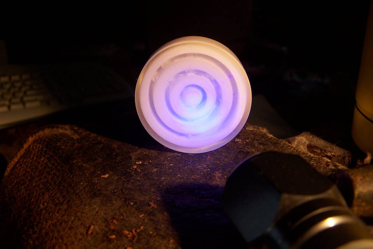

Here's a pic of the phototube facing side of a Hornyak button made I think by Jon Rosenstiel. This isn't the one I used, but mine looks about the same. I'm shining a bit of UV on it to light it up.
Homebrew Hornyak
Homebrew Hornyak
The reason for the rings is ZnS has a terrible index of refraction that isn't matched by anything I know of - so it's white and not very transparent, it tends to trap its own light. So it's cast into the plastic in this pattern so you can get some more of the light out of it and into the phototube. The plastic provides the protons to be knocked out by fast neutrons. I've made these myself. They're not super sensitive, but once a fusor is cranking, you don't need super sensitivity (or fragility, or emi sensitivity) so I thought I'd try this, since I paid pretty high for the button (but nothing for everything else!).

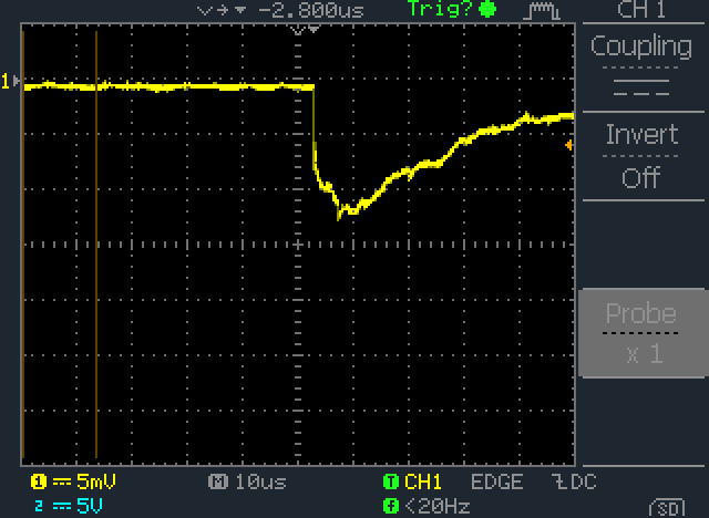

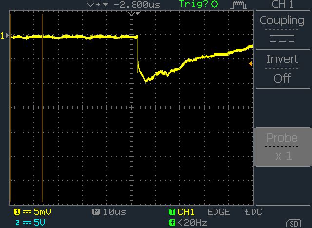

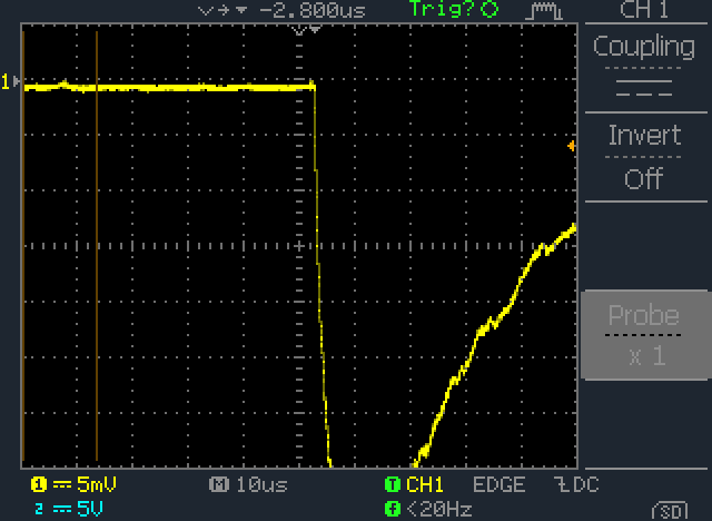

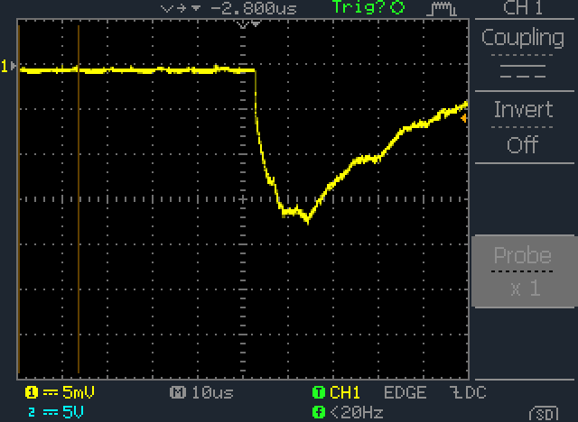

And, tada, here are some neutrons from my static-master/Be sources. As usual, click the pic. Dunno why .gif gets those silly scrollbars.
Neutron pulse from Hornyak/phototube
Big one
Big one
I'm pretty sure all these with the fast initial risetime are real events. It did take "heroic" work to cut radiated noise from the CCFL down to where I can see these this clean (it already had a two stage RC filter on the DC output of .47uf an 100k times two). I put the CCFL/diodes/filter in its own box, grounded. Phototube load is 47k with a x1 scope probe on it. Now and then I see a pulse without that fast initial risetime, and am wondering what happened there. But since the neutron scattering is more or less random, I suppose it could have knocked out a few low energy protons (or they were low energy by the time they got to a ZnS molecule) that then scattered all around in there to make the rest of the pulse. I'd further suppose that the much more rare big guy was perhaps a cosmic event, not a neutron from my little source (which, btw, the other detectors I have can't see above background, hmmm). The jury is still out till I can expose this to some mono-energetic neutrons from a fusor where there's no question about which is the source and which is "random junk from the sky or elsewhere". That's going to take a bit more than the setup I have clip-leaded into existence on the bench just now, though.

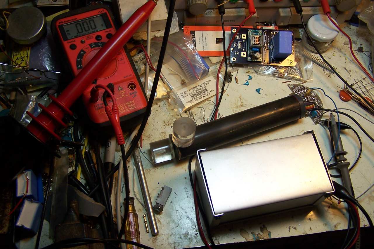

Bench setup, power supply (double RC filter with large C) in the bud box, running off bench supply.
I note that a 10mv pulse on 47k implies ~213 nanoamps. This is going to need some very excellent shielding to be EMI resistant! And the opamp and logger element are going to have to be top rate to show this level on the meter in the old CDV-715 box. Fun! The HV supply (CCFL+doubler) is drawing right around 1 watt, so it's not going to be real easy on batteries, I may do rev 1 with a wall wart as this needs regulated voltages throughout. While I can make the HV a quadruplier and lose some of the power drain (some is just the bias current for the Royer oscillator in the CCFL), the regulator would add it back in spades...Phototubes aren't great on batteries unless one uses a many step multiplier and drives all the dynodes off taps from that, avoiding the drain from the divider resistors which aren't needed in that case. Someday -- that's another project for another day.

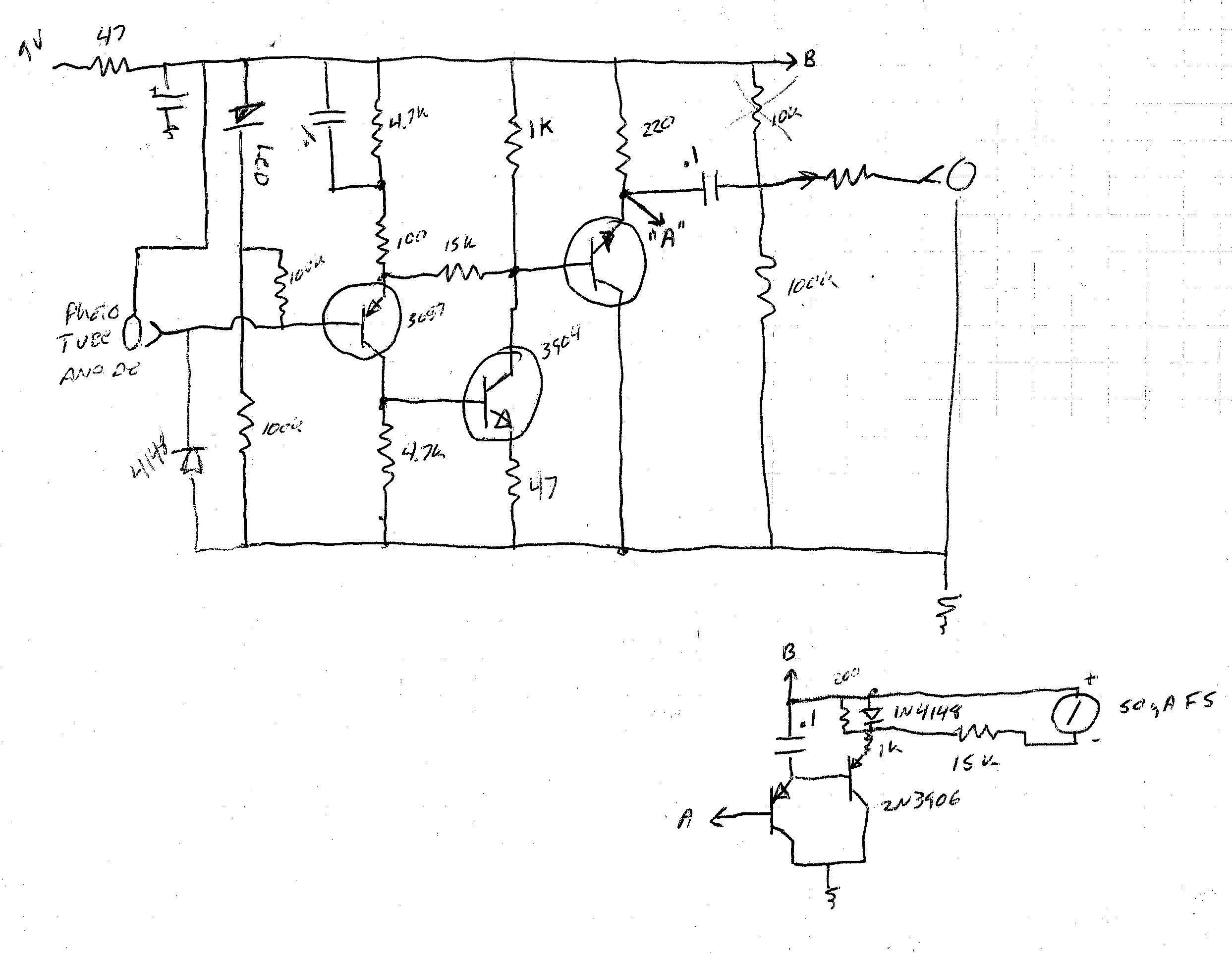

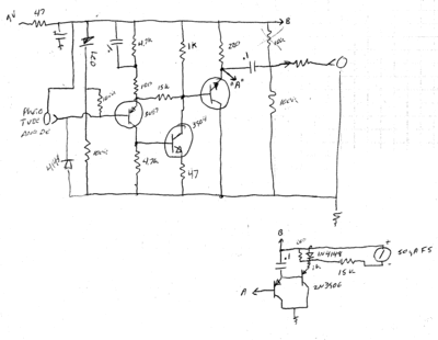

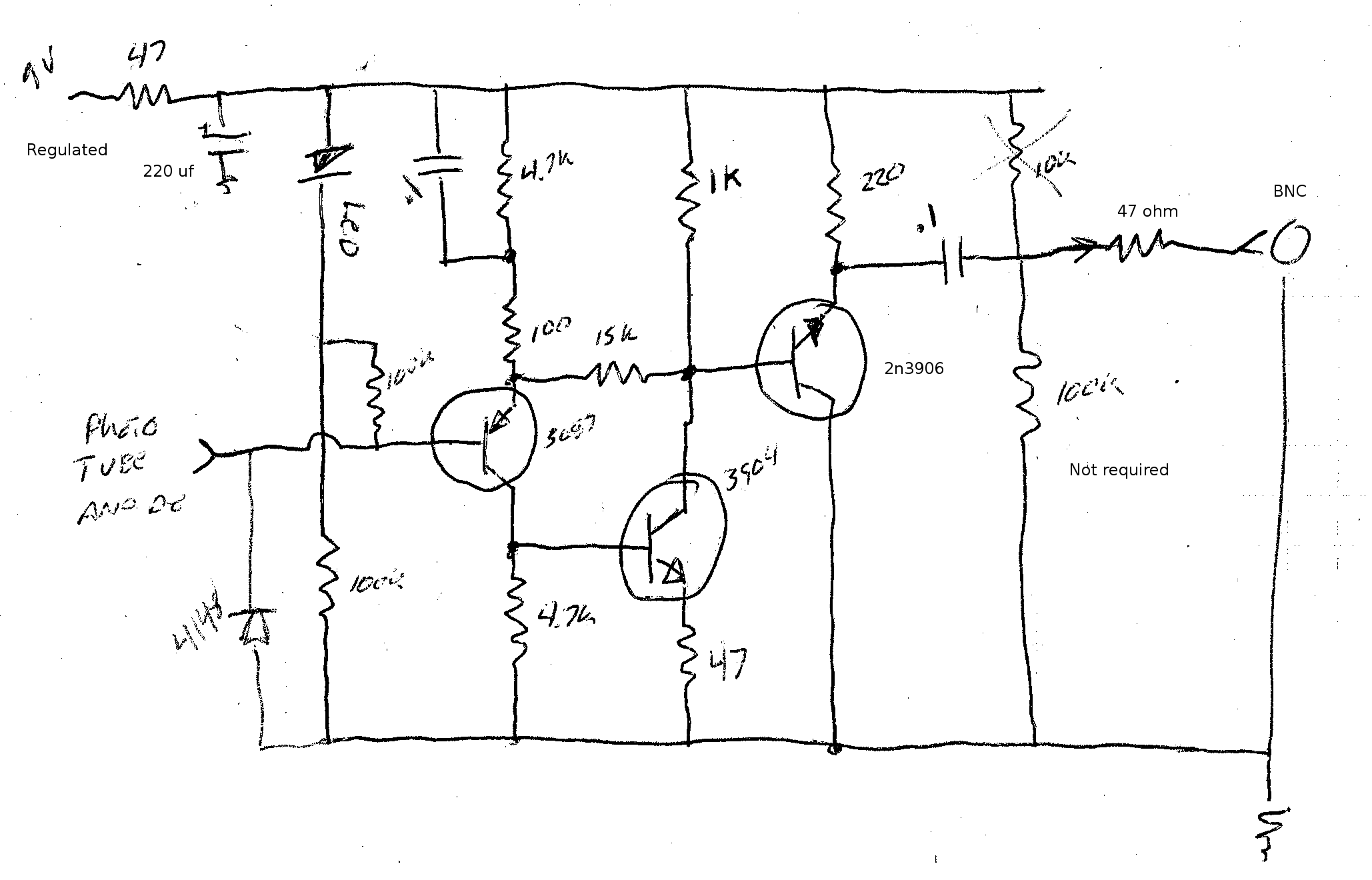

Re: Hornyak -- preamp
I've been fooling with preamp designs lately, and so I made one just for this, as it was desirable to have more gain, along with the ability to drive longer cables. A little more speed is nice, but in this case I actually sort of slowed the preamp down a little to better match the long decay signal from the hornyak phosphor. Here is the schematic.
Phototube preamp for slow phosphors, gain 150
I'm really getting nice results with that LED bias scheme, so I'm using it again. You may need to hunt a bit to find a low enough forward voltage led for this, I found the yellow one we used on the standard counter was just right, so I'm using that (1.641v with the 100k bias resistor, or about 100ua). Note I didn't need a coupling cap on the input - I connected straight to the phototube anode and used the tube with a negative supply. I only needed one protection diode (if I even needed any) as it can only pull negative of ground.
I used our regular CCFL, and no doubling for this, so it would need 9 volts to get to the 8xx volt output voltage, leaving me a nice supply to also run the preamp off. I wanted fairly high preamp volts to be sure to be able to make full 5v CMOS levels (it makes about 8v peak). Due to burning some more current in the input xistor, as well as the cable driver, this isn't a real good one for batteries as is, though it does perform well over wide power supply voltages due to the led trick. Probably 5-6 ma.
I wanted more gain as this isn't a high output thing, and the goal was to direct drive a cmos counter input on the standard counter (which is a schmitt-trigger input, tightly defined levels). Threshold such as it is, is set by the gain. This almost completely ignores some pretty fierce X rays, and also misses marginal neutron collision events, making it kind of numb, but on my fusor at roughly 1 m neuts/second, it counts at right about 1k cpm -- easy conversion to do in your head, so I like it as is, and it's way out of the cosmic background also.

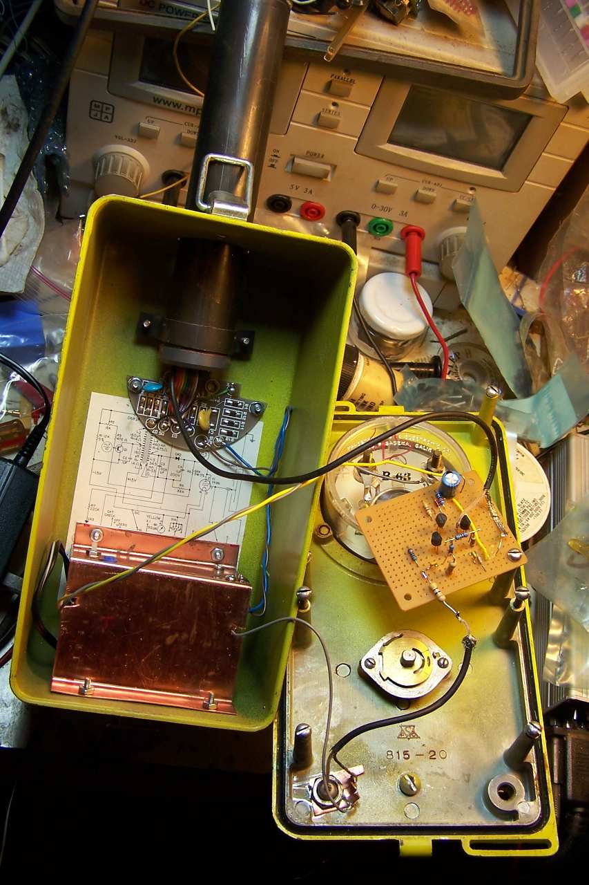

I built this, the detector head, and a regulated 9v supple and 880v HV supply into an old yellow CD-715 box. Now I'll have to come up with a trick to drive the meter -- the plan is to take this setup up to HEAS and put it on Richard's fusor while he runs and kinda get a demo done, and a cross calibration with his lab out of it, if he's willing to let us do that.
I'll get some more pix up of the "finished" thing soon. I applied what I call optimal effort to this. I didn't bother with "pretty" or even "rugged" or "slick" - I didn't know it was going to work for sure, so I did the minimal kludge to prove that first. If I make more (and that's looking likely now) they'll be nicer on the eyes and better other ways. But until you know it's going to be worth the effort, a good engineer won't waste man hours on it.
While not as sensitive as the Russian tubes, this is completely free from spurious counts -- they aren't -- has a super low background - they don't, doesn't temperature drift (they do), and by far the most important - I can get phototubes (ones better than the one I used are cheap) and make hornyak buttons in any quantity at any time, forever, where we are dependent on luck to get those Russian tubes...
Reliable neutron detectors, cheap, for all -- it's finally in reach! This setup is even portable, though I am running it off a wall wart at present.
Re: Hornyak detector build - guts
This is using the preamp shown above, our usual CCFL and lm317 HV power supply, this time not doubled, but filtered with a series 10k and a .47 uf cap (lots of filter), and the Hornyak head. Here's what the guts look like. I'll see if I can figure a trick to make the meter read in the bargain -- it's a nice meter they used (but I haven't found out the full scale current, I'd bet it's pretty low). This is running off a 12v DC wall wart for now. That phototube really eats some power in the resistors -- a 100ma one wasn't quite enough to hold up at full DC HV output.
Guts
Guts
As I said above, this wasn't a high-effort build. It was more like "can this work?". I knew that with the sensitivity of the preamp (a few mv to get a full scale output) I'd have to at least take care of EMI issues -- the fusor makes some, and the CCFL does too. So I folded up some Cu flashing to shield the power supply (and heatsink the regulator) inside the old CD box. I made a clamp for the sensor with another piece of the same steel tubing. As you can see, the preamp is just held in there with one screw for now -- I'll be fooling with that more to get a meter output and so on, so no point in super-mounting it up yet. Obviously, a quality build would use terminals, some more heat shrink tubing etc - but this is just a prototype, not even an "alpha" much less a beta. A real one such as we might make for sale later would of course be a lot nicer (see standard counter for example). By making our own hornyak head, using very thin plexiglass sheets laminated with ZnS:Ag and epoxy, we should be able to about double or triple the sensitivity per square of this, and by making it bigger, get another double or so sensitivity. That would be in a real comfortable range for fusor type things. In a low output, pretty stable run on my fusor at around 1 million neuts per second, this counted about 16.7 cps, or about 1000 cpm -- way way above its cosmic background. But that was with a working fusor (even if not running at its peak), and right up against the tank wall almost. A beginner might want just a little more sensitivity, dunno. This will be just fine for fusor tuning with the standard counter as the data aquisition and logging for me, and that frees up our more sensitive, but also bulkier and more delicate (not to mention expensive) other neutron detectors for other uses -- this is fine for what I need here. Since I'm going for ever higher fusor output, the numbness of this is actually an advantage, along with the log plot feature of the std counter software - I want to see movements on that, not piddly few-percent improvements!
Of course, I kept the goodies out of the original CD box, especially the electrometer tube, high value resistors, and ion chamber. The rest might wind up as junk my wife recycles. Nice box though.

Additional details, pseudo log converter for meter
One thing I forgot to mention (sometimes it's hard to be expert and a good teacher too - you forget everyone doesn't already know stuff that's second nature) is that I used the preamp power rail as the return for the anode coax. This way, and noise on the rail is "common mode" since the pnp input and signal ground reference is actually the supply rail in this circuit. Otherwise, I'd have given up a ton of power supply rejection, which I probably needed here. That short piece of coax doesn't have the shield wired at all at the tube end inside the grounded steel pipe.
Now on to the fun stuff. The output of the preamp is about a volt off the rail, and it's pretty stable due to the nice LED biasing scheme. I needed to get rid of that volt, and to do a peak holder, as well as get something like a log function so the meter would have some usable range. I added two 2n3906's as emitter followers to start. The first one acts as a diode, a diode drop, and a current amplifier to help charge my peak holding capacitor. The second one isolates that cap and adds another Vbe of drop to get me real near zero volts to the rail. A resistor to a diode gives me the log function (sort of, purists will hurl, but it does work). Due to the low current on the transistors, I didn't get rid of quite enough of the DC, so I had to add a 200 ohm resistor load to the final one to get the Vbe to be a little bigger. Since it's a 50 ua meter, and we might get .7v on that diode, we wanted 14k or so for a range resistor. 15k was close enough. This has enough range that put up near a running fusor in the 1e6 neuts/second range reads just half scale, but the sub-threshold phototube and preamp noise keep the meter off the zero, so if nothing else, you know it's working immediately. So, we have a reliable "it's working" indicator, and a reading of half scale when it's time to get away from a too loud radiation source, with room to spare for better output when that happens. Just right!
Now, since I did all this "optimal effort" meaning it's a sloppy kludge, it's not real robust. That really doesn't matter here, it's a prototype to the Nth degree, and can easily be cleaned up and made more physically solid anytime. And we will, unless we think of a better way to detect neutrons from fusors that has all the attractiveness this has, mainly being we can make these all day long and not have to depend on luck in finding some surplus crucial piece -- all the parts here are readily available and cost far less than even a BF3 tube retail. This isn't the only neutron detector project underway at the moment - I'm also looking into H recoil large area counters (also needs no moderator) and possibly manufacturing our own B10 tubes (not BF3 if we can make them work with just boron lining, since BF3 is truly nasty stuff to work with - and is a lousy counter gas, as is 3He).

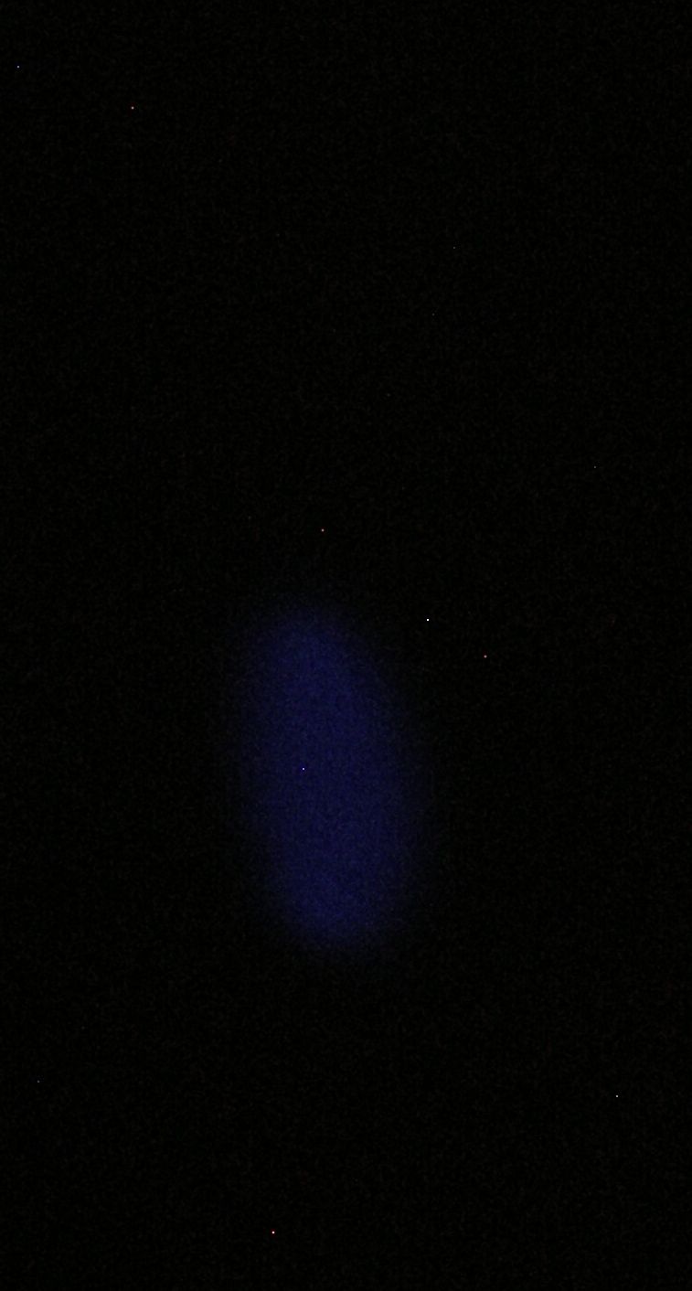

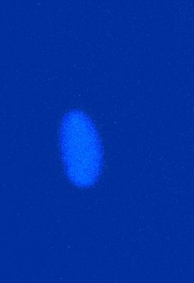

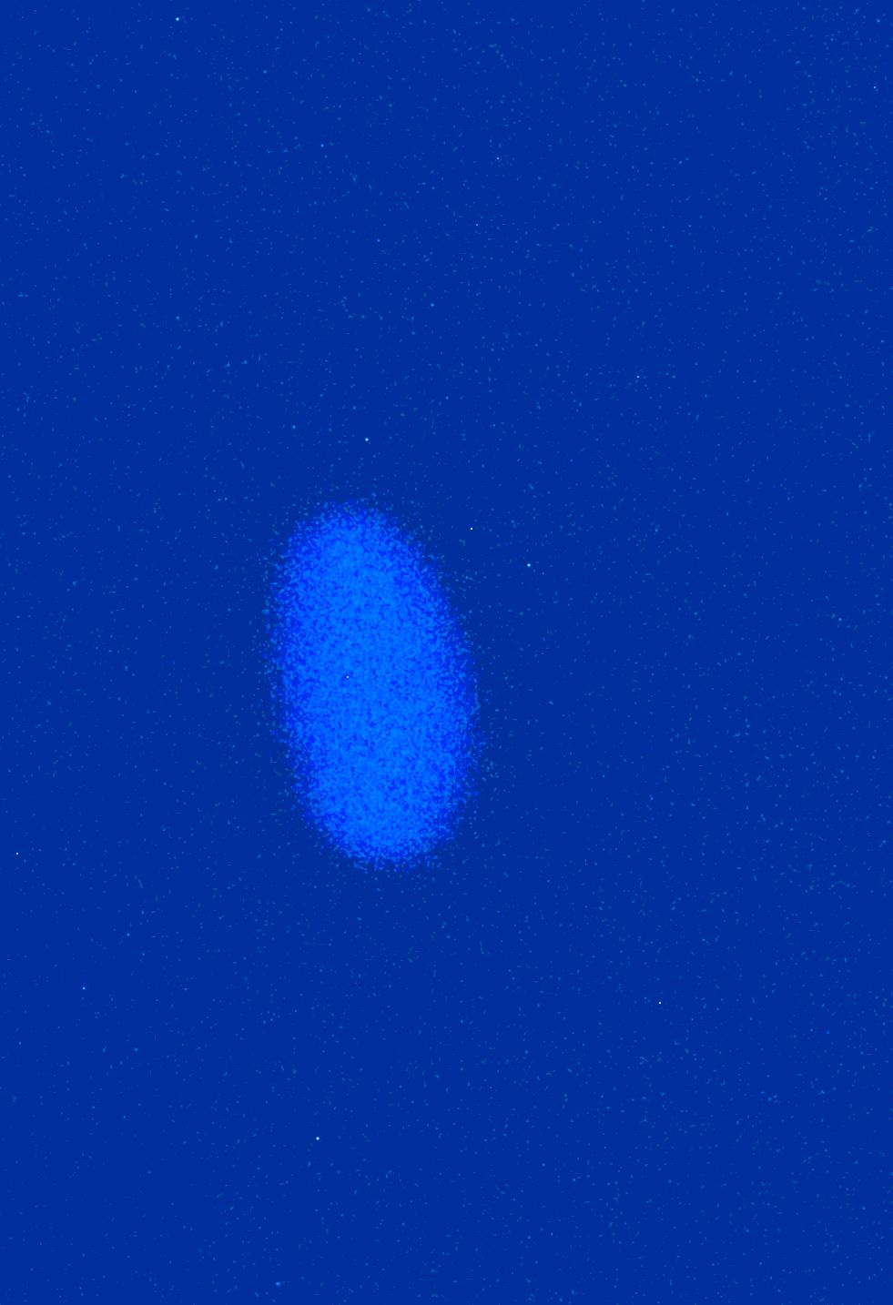

To put an end to it one way or the other, a listmember did an X-Ray analysis of one of our GEOelectronics ZnS(Ag) Alpha Scintillator screens.
The results were astonishing and totally unexpected. Under a weak X-Ray beam ( only 10 microAmps), the ZNS(Ag) lit up with a blue glow, easily seen by the naked eyes. Form 15 to 50 keV,(instrument limit) it just go brighter and brighter. See .jpg's. The black background one is as taken with a not too sensitive Nikon CCD camera, no intensifier at all. The Blue background was digitally enhanced. To the naked eye, the blue glow was very evident.
A microfocus X-Ray beam is used, the actual spot is abiut 3/8".
Test Everything.
Geo
ZnS(Ag) @ 50 keV X-ray digitally contrast enhanced
ZnS(Ag) @ 50 keV X-ray as  taken
