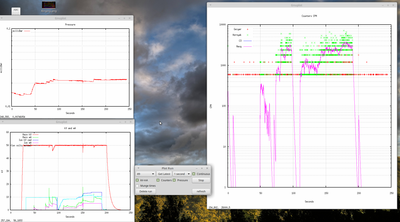

I use a program to plot data more or less in real time as it enters the fusorpi's database. It doesn't impact the bandwidth too much as it only asks for data "newer than I have already" on each request, so rather than have it be dependent on replication, I go right to the source of the info. Fewer things in series...lower failure rate.
This does the unit conversions as the database has just raw data in it, and there are two sources which have different timestamps for the same sample number due to where they were in their own delay loops when the clap happened.
Amazingly, gnuplot, which is what I leverage here, handles that with aplomb, autoscales, does log plots where that's a good idea, and I don't have to re-invent the wheel.
We had some errors earlier with EMI causing the arduinos to reset their timestamps, so I added a "munge time" checkbox here to let us just number them with our best guess about timing. It's not cool, but it's better than just losing the data entirely, and getting that one exactly right, while actually possible due to how they handle their timing, would have taken a heck of a lot more code. This is cowboy land - we just want to get on with the fusion part. Now in real life it should start to be obvious why I wanted a high powered machine here with 4 monitors (Nvidia NVS-510 for the curious). I have 3 vidcams to watch, this, and the fusor master control GUI. I use the Vivaldi browser with tab stacking for two of the cameras, it's a nice feature to get them into one window with one bookmark. I have enough resources here to run separate browser instances for all 3, but why?
