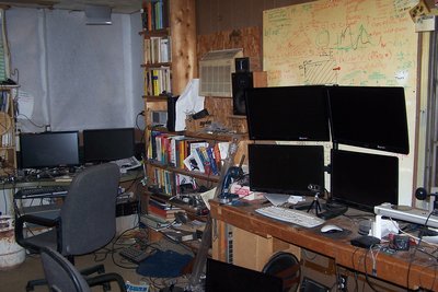

Coming together step by step, inch by inch...
The new control room.
The quad monitor setup is probably going over the other two in the corner, so I can use all of this at a time. And everyone knows, you've got to have a rip-your-face-off stereo and a killer computer setup to have a real control room, right?
Whiteboard optional...

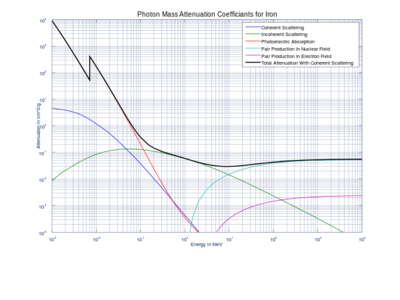

I couldn't easily get my hands back on the mass absorption curve for lead, but it's similar to iron in shape other than the location of the K line glitch (higher energy in lead). Neutrons? Cross section negligible, it's like bouncing BB's off bowling balls, they just find their way on through. Note that for double the energy, you don't need double the thickness - you need far more (orders of magnitude) for the same shielding. And the worst case is right around 2 MeV - which is neutron decay gamma or capture in hydrogen energy. Even boron makes a 571 KeV gamma...this is a hard game to win.
Note log scaling here.  This isn't easy.

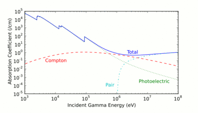

Seems there's always a little more work to do. Here's lead vs gamma energy. Lots of orders magnitude difference between hospital (or our power supply voltage) and the real hot stuff created by neutron capture or decay.
We have plenty for 50kv, but...
