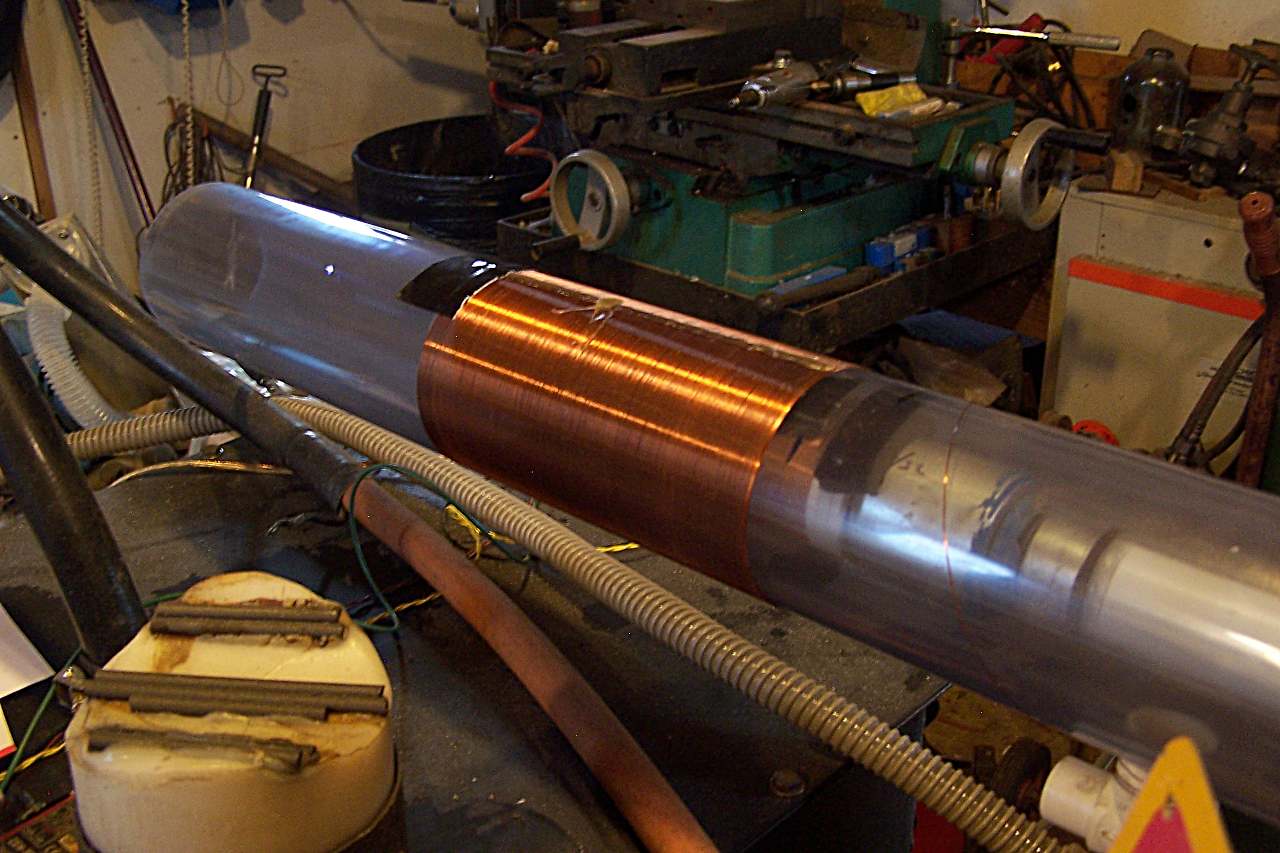

I just finished winding the secondary coil for the transformer. The primary is in series with the DC feed to the main grid. It has about a 3-4::1 stepdown (turns ratio anyway) and even though fine-pitch, may not go low enough in frequency to "go the right speed" - after all, we DO certainly have more than one species here - and we don't even know which one we want to be driving the oscillation! But we'll know...that's what lab time is for.
Since a picture is worth a lot of words and so on...
Mockup - sitting over the huge power supply we might use to drive it (100kv@100 ma, which we'll never use all of)
Obviously I have a little more to do before this sees power. The bigger pipe is sched 80, for insulation. There is an 8" diameter wire-screened outer pipe not shown - this whole mess is more or less the center conductor of a large piece of coax, to keep EMI out of my other stuff - it can get pretty fierce otherwise. The secondary here will be connected in series with the little supply (and ballast) that normally drives the secondary grid. Both supplies have a lot of series R, for safety. We have so much power gain, I'm not going to worry about the losses there for now, it almost oscillates by itself anyway, from coupling inside the tank, but at some wierd, very high frequency (working more like a regular electron tube it seems). This should put it more on a basis of us choosing the frequency and which particles are sloshing back and forth how far and fast.

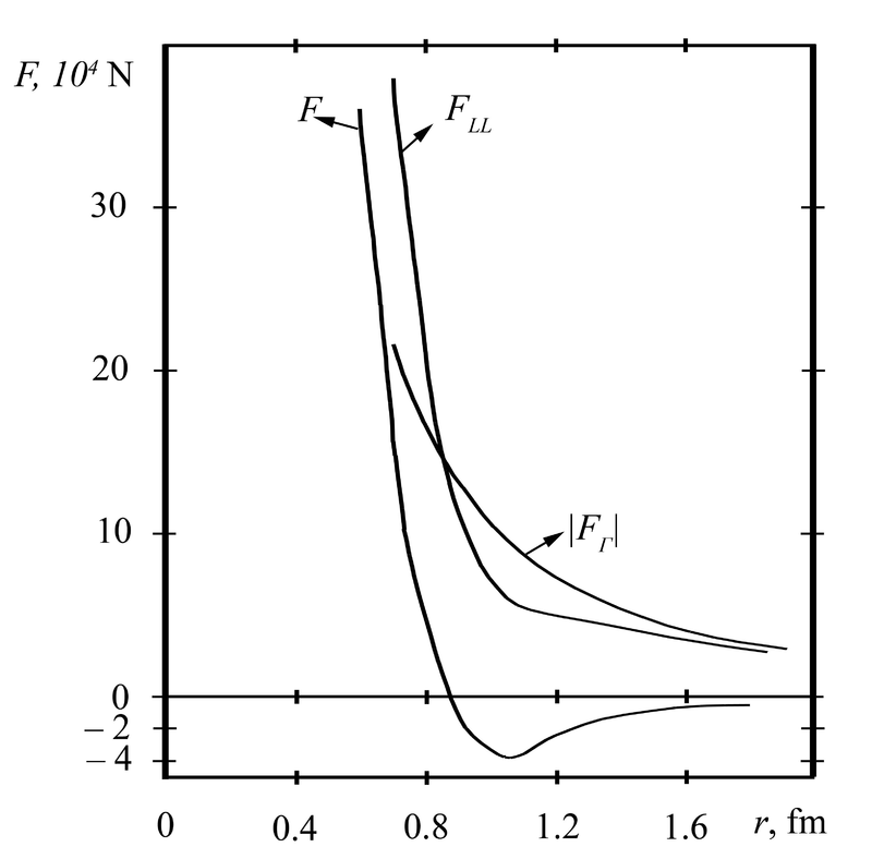

Just to tie up a few "theory" aspects of what we think we've learned lately. Yes, it appears that spin is important, and that DC "dynamic equilibrium" isn't the best - to the extent it has an effect on spins at all, it's a worst case - it lines them all up. Random is better (and right would be 2x better than that - we want anti-parallel). I think I've verified that in a number of tests, the last of which almost killed me - I picked up 100 msv in 30 seconds before I realized why all my sensitive counters and safety monitors went blank and just turned it off. I've since replicated that, and will soon give the details so others can too. We're now concentrating on more shielding so I don't have that happen again. Rad sickness is no joke, I know that first hand now.
I believe I've also learned that something people don't think about much, or perhaps correctly, is important. We always measure an electron excess when we have fusion going on. Always, and it's a lot, though I don't have exact ratios - getting the data on that is a bit difficult. Here's my theory on that. Well, we know we're going to have excess electrons - secondary emission and by golly, we're using a 50kv negative power supply to pump them in there...but there's evidently a huge difference between bound electrons and free ones - in what amounts to a somewhat polarized or charge-separated plasma vs bound ones.
Not so much that you can have this "virtual cathode" thing - I still believe that it's the electrons that will follow the far heavier and slower ions around, it just makes (Newtonian) sense.
While when electrons are bound, they tend to keep nuclei apart - that's why LLNL for example has to try so hard to push or shock them together (or the tokomak boys have to keep things very hot to keep full ionization even if it wastes 5/6 of the input energy into spurious degrees of freedom) - but unbound and with a large energy-speed differential so they can't recombine with ions - they help neutralize the Coloumb force as the ions approach our focus. That's the good side. The bad side is, of course, that due to their own field, they tend to neutralize the field we try to apply across the volume of the tank. There's no free, so to speak, so we don't get our ions up to anywhere near the energy of our 50kv input, not even close. But it doesn't matter as much because we don't need the speed as much, and actually, more speed would limit our time at tunneling range per pass, anyway.
However, since they are light and follow the ions closely, they tend to get between them and prevent them repelling one another as well as they might otherwise. This is an interesting picture:
Nuclear force between two nucleons vs distance.
For once, real numbers! They're a little scary when you talk 10e15 kinds of accuracy, but we now have a lot less to guess at.
Here's the wiki article that's from: http://en.wikipedia.org/wiki/Nuclear_force
According to the wikipedia article (a lot of these have been getting recent edits that make them more useful, the timing is interesting here) - the very right edge, about 1.8fm, is where the nuclear force overcomes the Coloumb force for two protons. Well, our case is a little more complex than that, since we have deuterons (and other stuff I'll ignore for the moment- but be honest about ignoring it).
We have a pair, assuming the correct spin combo (50% chance) so the nuclear force is double what is shown in the graph, though the Coloumb is just what the graph shows, since tne neutrons in the D's don't have any. Outside 1.8 (or a little further due to the more-nucleons, but only a little) fM - we have to hope for quantum tunneling into fusion, which is a probabilstic thing with more probability the closer and longer they are together - and this is where the electrons might be helping us linger longer inside the area where tunneling might be able to happen - the probability goes up with closeness (it's 100% inside 1.8 fm) and time...
There's just about no way we'll ever have a grid that accurate so as to get 100% - it's just not going to happen with stuff we humans can make, out of things we can get, but we can do a lot better than we have (I've proved that many times and it keeps getting better) - but we CAN get good enough to dramatically increase that time-distance product at the "focus" as I call it - that's what it looks like, though it's not looking just like light in a lens, and of course, what we see is the "losers" that recombine and give off light, not the ones "taking care of business" anyway. In essence, we're seeing a map of the lower energy outer edge of where the real action is when we view the poisser. And focus is getting so good it almost takes a magnifiying glass to even see it - that's progress. In fact, my best camera, though the layers of glass, can no longer get a picture of our focus, or sometimes, even the spread out beams, they are that faint and tiny - low losses are good for fusion, not so great if you want to see what's going on.
In our case, each beam is widest where it passes between grid wires, and narrowest at the focus and tank edges. Actually, at present, it's narrowest at the tank edges, the focal length appears a bit "long" for perfect focus at the center, but we're heading in the right direction when an experiment that improves our accuracy from 3-4 mils to 2-3 gives us factor of 10 better performance - that's huge for such a tiny change between horrible and somewhat less horrible - after all, we're talking mils (thousandths of an inch) error here - green light is 530 nm or so - and we want fM - another factor of a million over a nanometer to get to "perfect". (for reference: 1 nm = 3.93700787 × 10-8 inches, 530 is 2.08661417323E-5 in - or 2/100ths of one mil)
We ain't gonna get that down to a fM - the nuclei, much less atoms in our tungsten rods are much larger than that. But what we can do is improve vastly the region where "tunneling" occurs, its density, and time of residence at density (our version of the Lawson criteria, though not thermal, necessarily) to the point of possible gain - we are now getting nearly a milliwatt out of actual fusion, an amount that almost killed me in seconds...and don't need all that much more to start talking about "boiling that cup of tea". I think that's pretty huge, myself, even if I was the one to get there, and first as far as I know, in terms of Q anyway. Other efforts have done more fusion, but with FAR more input power. This is looking more like a compression ratio, or a finesse (in the spectrometer sense - resolution) problem than anything at this point.
We have discovered that grid accuracy in some sense has a very high exponent of "goodness" of fusion result, and have not yet found out how long that trend continues - we haven't found the other side of the evident peak yet. When we do - and we will - then other things come into play.
One is that spin alignment bugaboo. Another is the behavior of those sometimes-pesky, sometimes-useful electrons. Can we manipulate them such that they "get out of the way" at just the right time? An RF field might do that, but the math appears like that of a mass spectrometer - the frequency is dependent on a bunch of other things, it's just one number in the equation. Like a drift-tube accelerator, or a mass spectrometer, a number of things all have to be "right" at once or it doesn't work at all. So for now, more-better grid accuracy for a stable base, then the other stuff. though I must say, any sort of pulsing at all - almost anything that perturbs stable operation, has always shown us far more fusion per watt. I just think that's the spin alignment, and there's another effect to be had on top of that one that will, in the end, be larger and more important. I envision that it's going to look a bit like the Mathieu equation, but with at least one more variable, and that one (which is what makes quadrupole mass specs work) is already pretty hairy - so it's not going to be really easy to find that magic combo. This means our research goes first for the basic stuff, and repeatability, before we can even begin to work that search space, or so I believe at present.
I believe a further thing that is helping us is that most probably we're going in "neutrons first" when we start to get close. If I got the math right, the deuteron's natural frequency (quantum wavefunction stuff) is in the range of 10e22 or thereabouts, but when they start to feel that huge repulsive force, I'd have to bet that something so light would tend to line up so as to minimize tons of force. Again, plain old Newton here. There might be a further mumble-de-pegging going on as the electrons get squished out of the way, but...that's for the future to learn and hopefully control.
