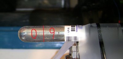

We have noticed, while trying to get a good calibration on our big neutron detectors (moderated 3He and BF3 tubes in 6" dia HDPE) that we are not seeing uniform isotropic neutron output from our cylindrical fusor.
We placed two BTI detectors at the same distance from grid center-axis, but at different spots along the cylindrical grid's length, and got very different, but repeatable results in back to back runs from the two detector locations.
In all cases here, there is a hot spot near the open end of the cylinder grid, well away from the middle of its length where the visible rays appear to emit from (even with our cylinder grid, the rays appear circular in cross section and emit from the center of the length). We placed two BTI's side by side, vertical, at the same distance from grid axis (cylinder is horizontal), one about even with the end, and one a BTI diameter (about 3/4") closer to the middle of the grid length, and the one nearer the grid end consistently counts 3-5 times the millirems, and it doesn't matter if we switch which BTI is where -- we get the same output ratio from the same locations either way -- the indication stays in the same place re the fusor and doesn't move with the switched BTI detectors. Which convinces me at least that it's not a problem with the BTI's -- they are consistent.
This calls into question the widely held idea that neutron output is isotropic from a fusor, and the ratio we see here seems too high to be accounted for by square law effects alone (assuming even that most of the neutrons are made right at the tank wall, rather than elsewhere as seems more reasonable). It also makes the idea that you can calibrate a large, comparatively farther away moderated detector with a BTI reading alone seem very iffy.
In our case, the moderated detectors subtend a much larger angle than the BTI's do, even though they are closer in, and would tend to average or smear out any spatial non uniformities so they are reading some kind of average, while the BTI's seem to be telling us that the output isn't uniform over all angles, and that it is very variable over rather small angles.
