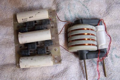

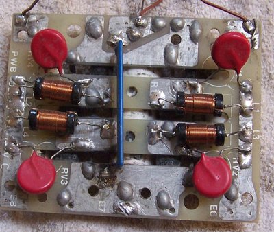

To get a little closer to your actual question -- here's how Spellman does things. We bought some parts from a fellow HV experimenter, and he'd de-potted a Spellman stack. These stages are rated 10kv each, but only usable to about 5-6 kv outside the potting.
Backside view
Backside view
The blue thing is a resistor across the stage output. The inductors separately decouple two sets of rectifiers that are otherwise in parallel. The red things are surge absorbers, presumably standard units. Here's the other side of the board.
Frontside view
Frontside view
This one shows a homebrew transformer, good for roughly a kilowatt, and the caps and diodes. Note how large the diodes are...over-design for safety in impulse (arc) conditions. The caps are .022 at 10kv here, polypropylene types with good pulse characteristics.
