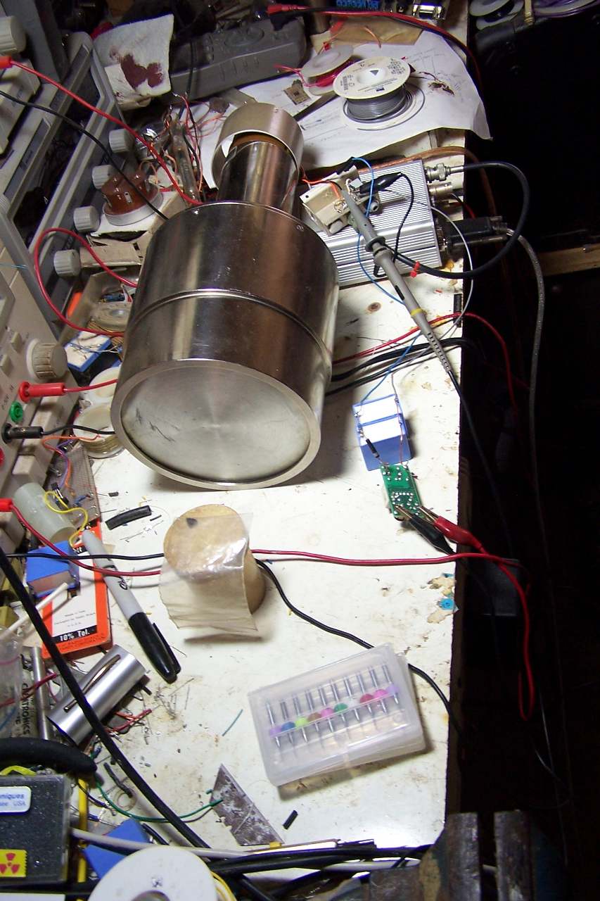

The URSA is a nice thing, compact, possible of battery operation, and pretty versatile. The unit I have was modded for someone who then returned it, and doesn't have full functionality, but what it has is pretty darn nice. Around here, that tiny size is pretty important too. Here it is on my tinker bench with a nice NaI head Bill found on ebay. The URSA is the aluminum box under the scope probe -- nicely portable, even with built in batteries. It will provide +/- 12v to a preamp, and has it's own programmable HV supply as well.

I'm just learning how to get the most out of something like this at present, twiddling the many adjustments and seeing how they interact and things like that. As I get a little smarter, I'll add on to this thread. At the moment, I'm running the phototube off a separate CCFL based supply which in turn is running off a bench supply, which isn't as stable as a closed loop system, but stays pretty good (inside a volt) according to my HV probe. If I rewired the tube socket, I could run it off the URSA built in supply, which is probably a better one than this currently is.
I am having some drift issues with temperature or time of power on, and not sure where they are coming from just yet -- I only know it's not my cheesy HV supply as I checked for that right off.

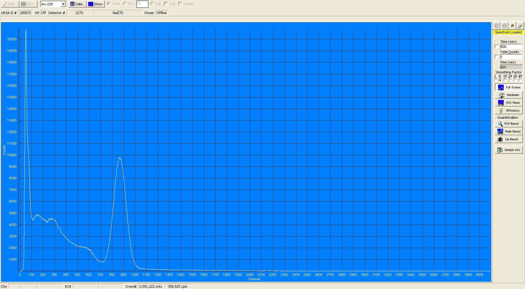

Detectors matter. Here's about the same thing but from a smaller, thinner NaI head (STOE)
Same source, different head
Just a note of intrest. The lower peak on the STOE head IS the right peak for the low energy Cs-137 line. On the upper one, that lower peak is just noise. The STOE is super quiet, but can't handle the high energy 662 kv peak -- it's the most far right one, and that larger one below it is from photons that had some energy scatter out of the thinner crystal. In the first picture, from the Harshaw (5" diameter by 3" or so deep) that high energy peak is correct.

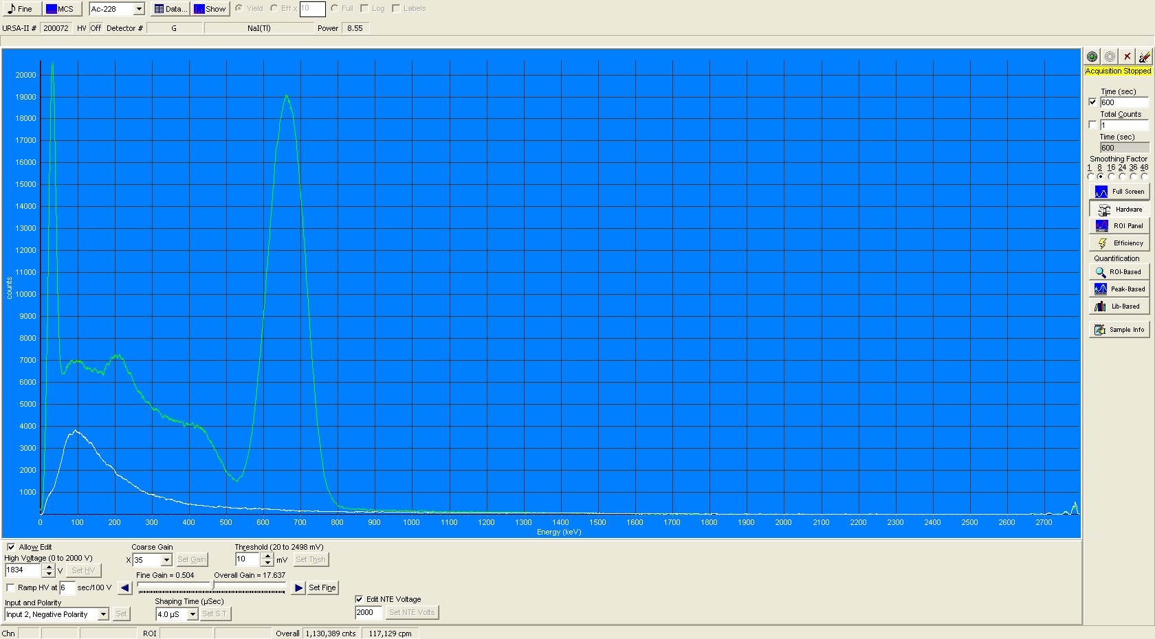

One of the advantages of this site is that we can use it to store a little information where it's hard to lose (or at least, it's in another place to look in). I just completed a rebuild of the phototube chain for the new Harshaw big NaI:Tl, and took a background and a Cs-137 spectra, overlaid, with all the setup numbers written down, so here it is:
New recalibration with new socket parts and reduced noise setup.
These numbers might not mean much to everyone, but if I ever need to get back to my baseline with this, well, I have them stored here too.
Conditions:
Benchtop, no castle.
Room temp 85 deg F
CCFL input 9.4v, 130 ma, output 1834v DC-
Anode load 10k ohm
Gain 17.637 (FS is 5v on this URSA II unit)
Shaping 4 us
threshold 10 mv
ch numbers for Cs-137 lines 76,991
Detector - Harshaw, our #2, socket rewired for focus electrode 2r and bypass caps

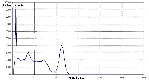

NaI spectra from HPaul on Wikipedia
The reason I have a bigger high energy peak is that with this huge thing I have a lot less loss to Compton scattering, not that I 'm not seeing the smaller peak as well, as the comparison with my background on the upper one should show. These things are really outstanding as NaI detector go (eg, hard to lift). In this case, size matters, and these are big.
So, nothing really special to see here, just a "note to myself" for the next time I need to make sure I'm set up the same for repeatable results. Putting that shield can on there, and the extra supply filtering let me set the threshold a lot lower but still out of the noise, and run lower HV so I could see higher energy without clipping on the URSA. Those peaks way up high are cosmics, which I assume are not resolved -- just stuff that clipped at the limit of the A/D -- because they look about the same no matter where the other parameters are set.
And now I can go have some fun with this, and know it's telling me the truth for sure.
