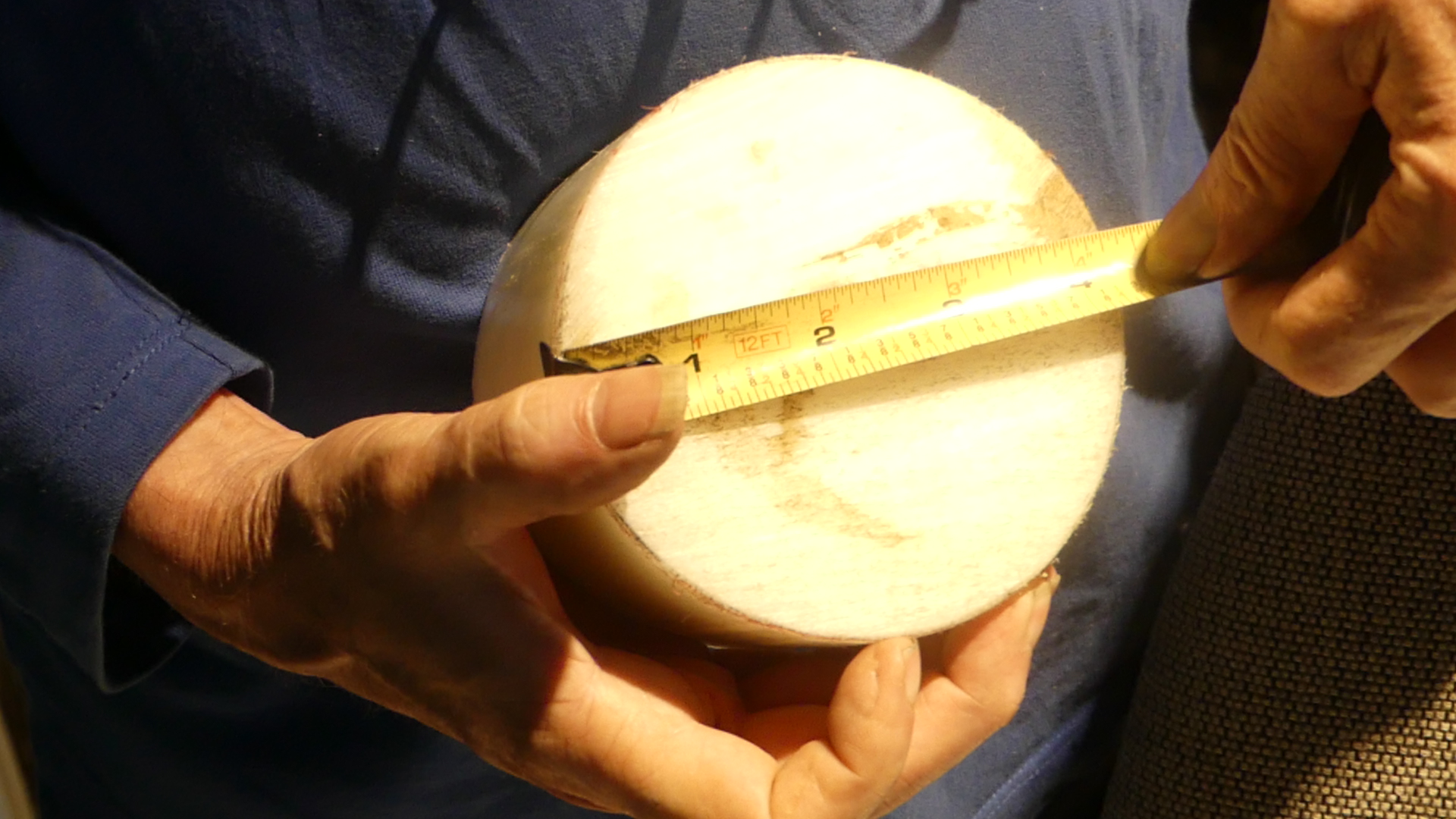

We then inserted various things that are supposed to moderate or stop fast neutrons to see what "contrast ratio" we could get, and got an unpleasant surprise (most moderators let quite the bulk of fast neutrons through till they get really dense and thick, and LiCO3+ wax has no noticeable effect on neutron count when interspersed at 1.5" thick - someone is making a lot of money selling that stuff...and the performance numbers...are horrible (No measurable effect at all!) - but being honest and all, here's that data. We are trying to build a directional neutron "telescope" or at least "pinhole camera" that will let us aim the detector and get some information about where the neutrons are actually being produced. Yes, there is some data out there, kind of, from one source that's not very helpful yet - or replicated - and I have a couple things I want to learn here that this will help with.
Here's a pic of the piece of HDPE that did give us some contrast...not great but it takes at least this much to be "worth it".
The big piece of HDPE that did give a 4::1 reduction

This set of tests showed that with minimal additional effort we can make a sort of directional neutron detector with about 4::1 contrast ratio between where it's pointed and neutrons coming from the sides. So, next is to make a mount that can rotate it around a fusor (there are about to be two here) in operation and see what we see - when pointed at where a beam hits the wall, do we get more?
I'd like to have gotten a better contrast ratio with reasonable size stuff, but we have what we have. Still to finish is the "lens" or in this case "aperture" of our neutron pinhole camera, and the mount, as well as the other fusor (the new system in the upstairs lab) that has a lot more freedom to move such a thing around it's circumference, as it hasn't grown a lot of warts and appendages around where the beams hit. Also, that one is only a 6 way lens, vs an 8 way lens in the big guy (neglecting the beam on the end)

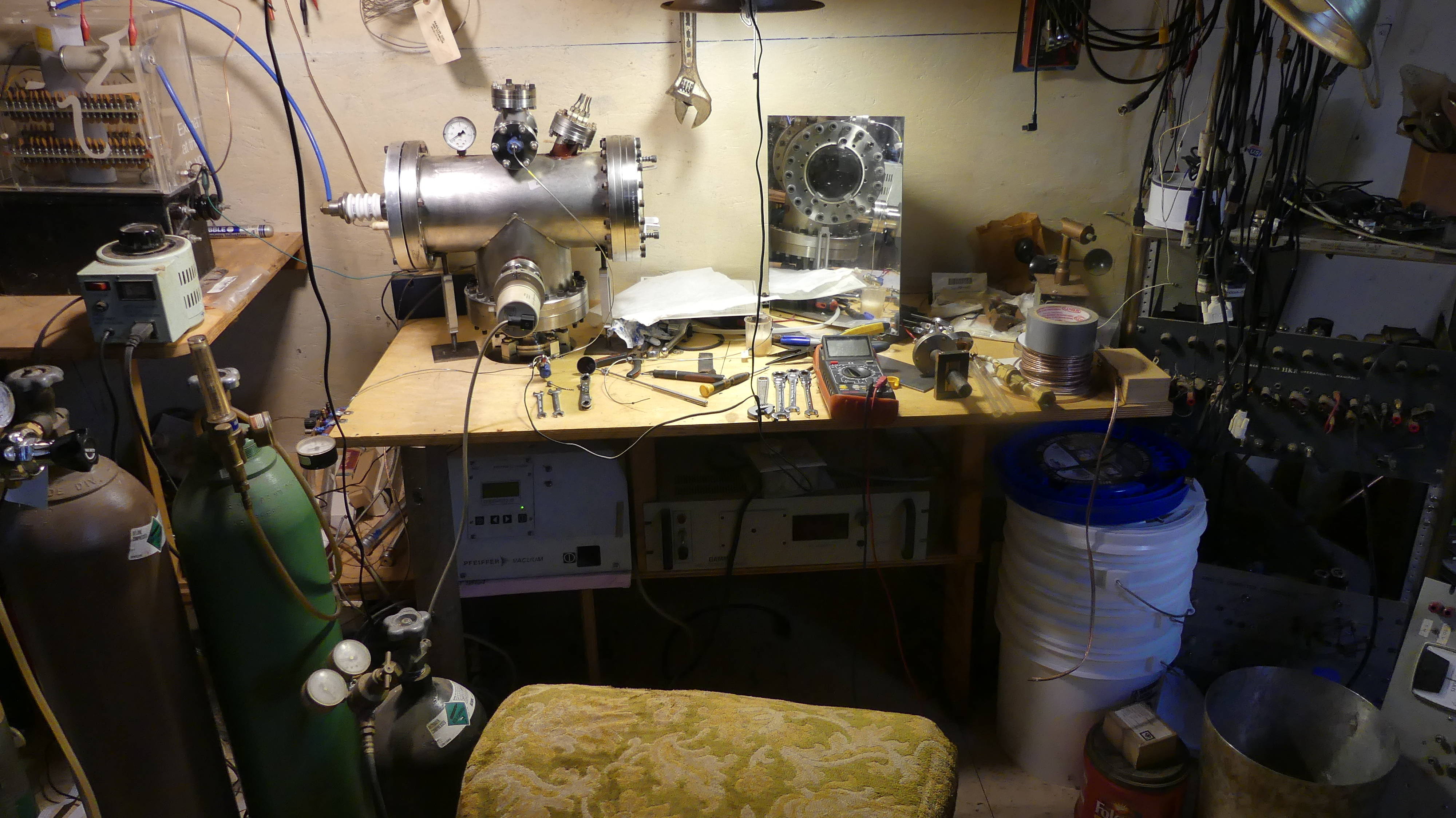

Here are some pix of the new system I'm planning to use for this. Right now I'm fighting a bit with what appears to be a really slow leak on the supply manifold side of this little solenoid valve I've modified for this use. I've never seen a faster acting (< 20ms) or smaller wasted volume (about .1 cc) solenoid valve...but it was originally intended to control an air cylinder at high pressure, and let it leak down when commanded - I had to plug the deliberate leak, reverse the direction of flow etc. This setup works fine on the big system; when I found these surplus I bought a bag full of them.
But here, leaks, even a slow one, on the supply side, which wasn't all that well sealed in the original design, is a disaster. I want to put only a few millibars of deuterium into that manifold so one minimal pulse to the valve won't let in too much gas - so air leaking in will destroy purity pretty quickly. This AM I fabricated a teflon washer to back up the evidentlyl inadequate loose O ring it already had between the magnet part and the valve part. I may need to also get a little bit fatter O ring and polish some metal. It's under testing right now.
I used to use that manifold when making glow and gas tubes - you let in X pressure of gas A, B, C while watching the gage, and have a nice supply of mixed gasses (like helium-neon) to fill things from.
Here I just want the one gas, but starting at low pressure because even the "dead" volume in that valve is WAY bigger than desired here, and it's at the point where it's hard to reduce due to tight clearances - I can't really shove in more epoxy or whatever now.

The system close in.  The grid can be adjusted for whatever depth from the left end, and I have room there to put the new detector.
From a distance.  Yes, that rack has tube type opamps in it (Philbrick).  I might even use them, they are very hard to hurt with EMI.  The gas cylinders shown are just shop gasses - He, Ne, N2 - what I had on hand for other games.
