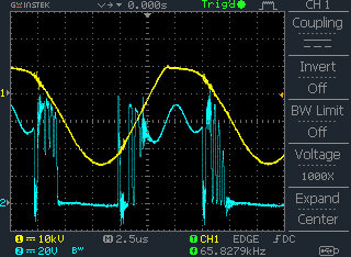

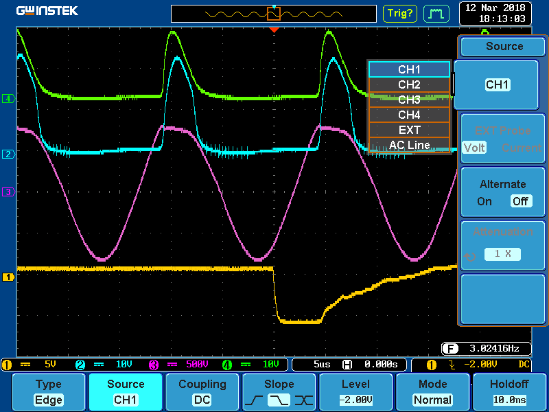

To the pictures: Green is the furthest faraday, which has a semi loaded ion grid "in the way" - the DC ion supply is wired up, but not on, shielding this one a little bit I'd guess.
Blue is the near faraday probe - the one that looks like a 2.4 ghz antenna (it is that too).
Violet is an ac coupled pickup a few inches from the end of the HV feedthrough (near the tank end).
Yellow is neutron (hornyak). When this is clipped, like here, it seems to mean a neutron burst. I was running 60 to 65 khz in this (before the DC PS fried). It looked to me like about 1/3 of the grid volts were positive, and 2/3 negative, corresponding very roughly to +10 kv and -20 kv here.
