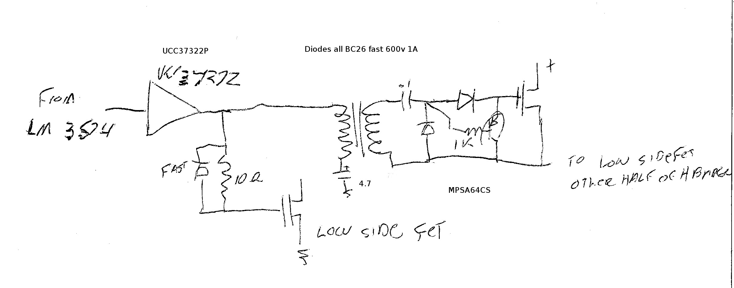

The final drive for the high side:
Cute driver circuit for fast turnoff
I have a parallel project going with an ESP8266 and an MCP4631 dual i2c potentiometer to control this remotely. More on that when there's more. For now, knobs.
