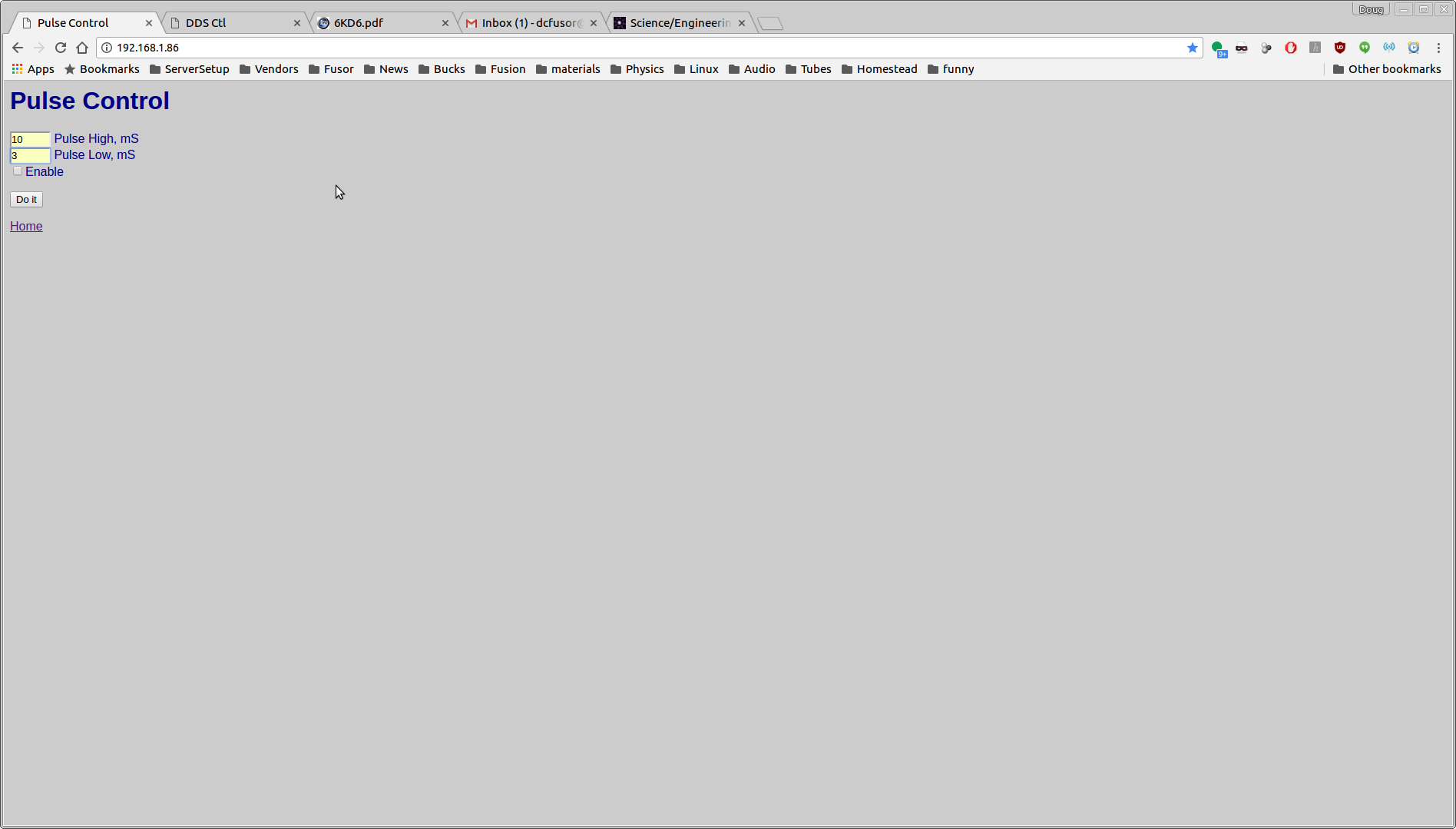

Turns out the ESP-8266 code is pretty simple too. We're just using one output pin...generating a web page CGI in C++ is a pain, but it works...
It's mostly the stock type stuff. I let you choose a high time (in milliseconds) a low time (same) which between them set the repetition rate, and have an enable checkbox and a "do it" button.
