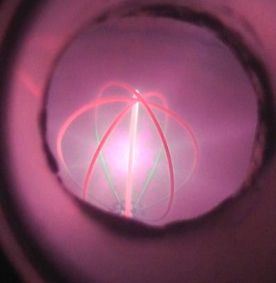

Running a test tomorrow at 2 pm with the grid shown below. It's made with 0.041" Tungsten wire, so we shouldn't have the deformation problems we had with the Ti spiral. Prior to putting this in the fusor last weekend, I made some adjustments to the orientation of the loops that are not shown in the picture. I was attempting to get them more symmetrical.

Certainly is prettier than the picture I just took of first light on the new upstairs fusor just now. This looks like it should work for you once you get closer to the right gas conditions, and boy is that ever a trick, as you now know from trying. All the best, you're on the road now -- you'll be getting some good results real soon I betcha.

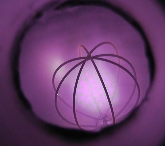

We had another test today. First off, I'll come back with more numbers later once we wade through all of the data collected, but I have some of the major results. We have most definitely achieved fusion here at Virginia Tech. Our highest neutron count over a three minute period today was 12,308. We were consistently getting around 1000 and our next highest count was around 2,600. Shown below is a screen shot of how it looked just before we got the large spike from the He-3 detector. Right after we had the current rise to 16 or 17 mA, it started to decrease slowly and that's when we got the spike. This picture was taken at that high current. More data to follow later...

A very nice picture! I knew you guys would do it, and congrats from all of us (the rest of you, feel free to add yours in person).
If that's a rod I see right at grid center, you're going to do a little better without it -- too many ions will hit it and therefore not each other...Edit: oh, that's just another ring seen edge on, isn't it?
I see that it's getting uniformly hot, which is a good sign, though not getting hot is even better.
With the temperature excursions, you're going to have more rather than less, trouble with controlling the gas pressure, FYI.
Those "rays" are something we all see when there's fusion. No particular explanation (or, what's worse, everyone has a theory and no one has proof or good data yet), but they are always there when things are right.
I'm planning on putting a Faraday/Langmuir probe on my wiggle stick and try to get some data on those "rays". Not sure when it will happen, but frankly, I'm amazed it seems no one else ever has and reported it. I'd guess the field in a ray would be different than between them, and that the radial distribution would be different in or out of a ray as well....but that's a guess.
I too have noticed that fusors take a better picture with "too much gas" under conditions where there isn't that much fusion. Kind of misleads the people trying to learn. When mine are at their hottest -- not much to see unless you're really well dark adapted. After all, the light is a loss....

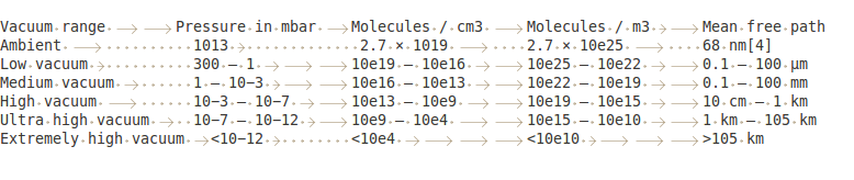

The output seems to be very much a function of how fast the ions hit. More gas (as needed for lower voltages) means they collide too much with neutrals on the way in to ever get up to a good speed, and the low energy collisions don't make fusion. Lower voltages mean they don't get to good speeds even if they get lucky and miss the other junk before getting to the interaction zone.
As you can see, even at the lower pressures I'm telling you to try, there are plenty of atoms in the about 1cc interaction zone (and there's more there than elsewhere anyway).
But if an ion makes just one collision on the way in (or out) -- you lose half the input energy to a useless collision. See the numbers above.
