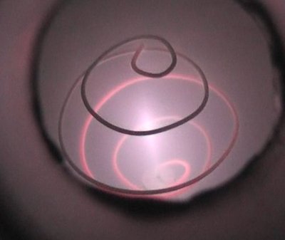

A picture of the cathode during the test.  Bright red wire.

Great! You're on the road now :D
Here's what most people don't understand. You're not in a pure-plasma environment, and the fusor isn't a resistive load that follows ohm's law with a fixed resistance. In general you have a lot of neutral gas atoms/molecules in there, up to any current you could actually run with materials that exist (even if you could get them).
So, at some gas pressure, you try run in say 20kv. It draws a lot of current. You try adding more current to get the voltage to come up. When you do that, more of the neutrals are ionized, so you have a better "conductor" in there -- the effective resistance goes down! And trying to pour the coals to it just makes it worse, and at some power level in put, things melt.
You've now experienced that first hand. My latest runs show the exact same thing.
This is good -- replication is the basis of all progress in science. It validates the idea that neither of our measurements are flukes.
Further, getting things in there really hot has a way of making them release any little pockets of trapped gas (inter crystal boundary, any other little places that can trap gas, like under a screw thread, and so on). So now you've seen that too. Various things can trap a little gas, any void in any material in there. The good news is that, unless that gas is being created due to reactions with the deuterium, or something decomposing due to heat, once you get it out, it's out (until the next time you let it up to atmosphere). This is part of what I've been calling the "conditioning" process.
So, what you need to do is run with higher starting volts and less gas. The thing has less "negative resistance" at that point, and as we've all found out, it's the voltage that makes the neutrons -- high current can come later on when everything else is right -- you need to go "smart" before you go "big".
This is a fairly complex cause-effect relationship. At longer mean free paths (less gas), you can, and must run higher voltages to make it draw current at all. But with less gas, you also have a lot fewer energy-wasting low speed collisions with neutrals before the ions get up to full speed. This might explain the more or less exponential nature of increased fusion with higher voltages.
EG, with the higher voltages, the ions would be going faster due to the bigger field you apply, and ALSO more of them get to full speed without hitting trash on the way into focus. Further, at lower currents, you have more of the field you think you applied -- less cancellation of it due to space charge implied by the higher currents.
As far as grid heating goes, that's very dependent on grid design details. To the extent there is "recirculation" of ions, or (more likely) more ions are being created by collisions with other ones, the ideal grid design has those happening in places where on the next pass they don't hit the grid wires. When you accomplish that, the grid doesn't heat so much anymore. I ran a kilowatt input this weekend without anything more than the middles of the rods getting to dull red heat. No other part of the grid assembly got visibly hot at all. FWIW, I never got my spiral to work all that well, and the grid design I now use makes a lot more neutrons per watt input, due to this effect -- for whatever reason, it intercepts fewer incoming ions in my particular overall geometry.
In your geometry, you'll have to fool with what works there, it probably won't be the same as what works in my tank shape. The other main players in IEC who are doing well are using the 3 ring geometry for their grids, last I heard. If I were doing that, and seeing how theirs all get hot and fail at the place where those wires all intesect at the end, I'd make them come to a circle there (a hole in the end) rather than all intersect at that point, but that's just a guess on my part. Obviously, when the wires get real close together at the end, the incoming ions there have no way to miss them, so opening up a hole at that spot (with a ring to tie the wire ends together) should help a lot with heating -- if there's nothing there, it can't heat up.
Some spitting and sparking is normal, especially at first. With a proper ballast to limit peak currents, as I think you now have, the result is that the high spots and loose dust particles just get blown off, and things just get better with run time. Too much peak current blows little pits at those points and makes things worse (as opposed to average current -- important).
In my experience, the best operation comes right at the gas pressure level where the thing will barely keep itself lit at all. This means there are less neutrals (less of everything) floating around to create that divergent current draw - as current goes up, current goes up more, out of control.
Your reported numbers are "in range" for the speeds and feeds you're reporting, this is very good news, actually. As you improve things (mostly vacuum stuff) you'll be able to run higher voltages, and as I've reported, each increased KV makes the neutron output go up faster than the previous one did, it's at least exponential after the threshold. Once you do that -- then and only then, worry about getting more current going through there.
Higher current has some negative effects other than melting things. Remember, you're applying a field, but that's not the sole determinant of the actual field gradient -- the ions themselves are charged and create a field that tries to cancel the one you've applied. The result is that with say 20kv applied, the ions don't actually reach a 20k electron volt energy/speed, because they see a somewhat canceled out applied field, due to the other charges in there. Further, since like charged ions repel one another, they become harder to get focused on a tight interaction zone, the beam "blows up" just like an old time CRT does when you try to increase the brightness too far.
When there is too much gas (and too many neutrals) another bad thing happens -- ions hit neutrals on the way in to the reaction zone, and lose energy doing that. So when they arrive, they might not still have enough energy to fuse. So a very big key issue is having the correct "mean free path" so that the energy you invest in each ion makes it to the reaction zone, rather than being thermalized in low speed collisions with neutrals on the way in.
