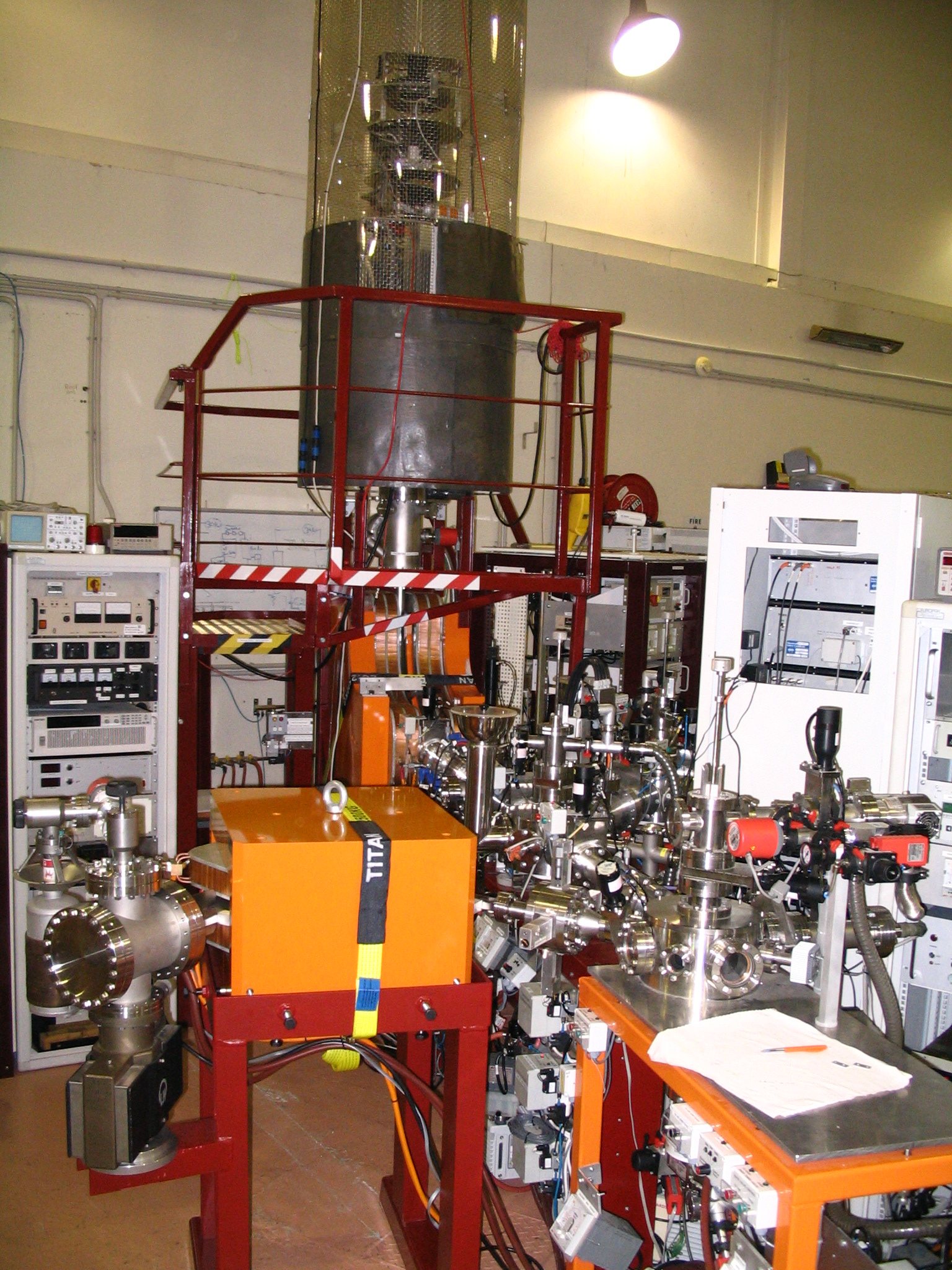

Okay the lab upgrade continues with an RBS spectrometer now being added behind the target chamber on the vertical implanter.
RBS uses helium nuclei (alphas) to probe the surface layers of a sample with the bounced off alphas energy proportional to Z of the sample material. More reading on this to be found on the web.
The detector for this I am about to construct out of a 4" x 2" MCP plate that will attach to the large CF blank flange directly above the ion pump. I still have to make the resistive anode for the MCP to work against that provides position information.
So far we just got the system assembled and under vacuum a couple of days before the xmas break.

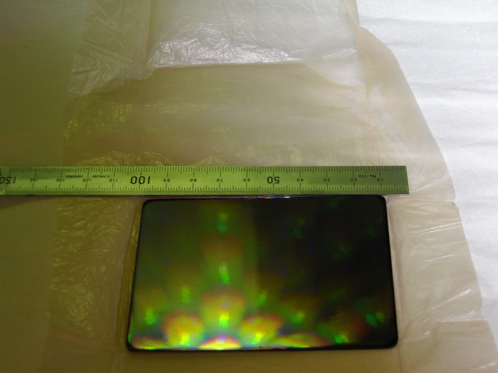

Okay a few pics of the RBS detector MCP and the resistive anode I'm starting to make
First pic the MCP itself interesting interference pattern from all the holes in the 10um grid

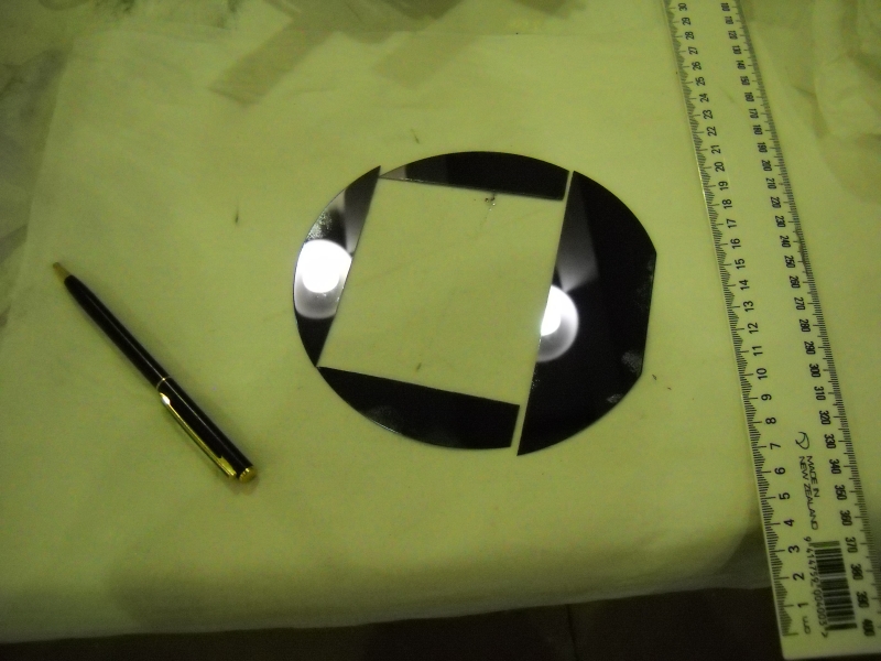

third pic the centre out of the sio2 on Si wafer that I'll build the resistive anode on ( the bit i'm using is missing --in the sputter chamber getting gold contacts

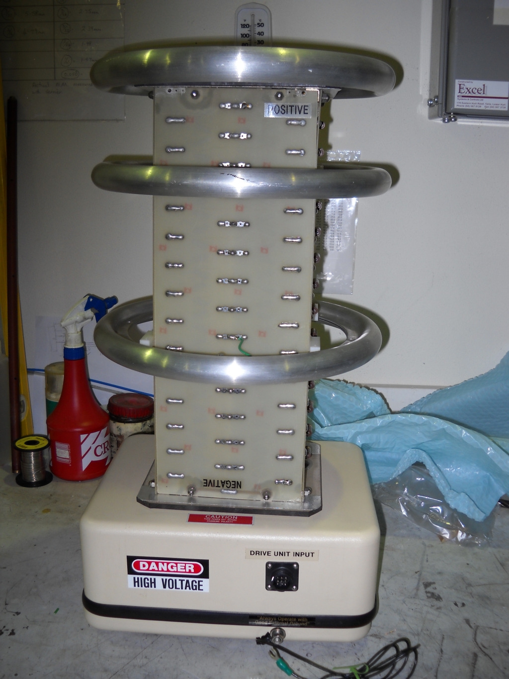

Father Christmas (AKA EPay) just delivered a 125kV supply

This rates at least a yum, and perhaps a YAHOO! What's the polarity and current? I see they only used a coupla corona rings to keep arcs down, but one question I've got for these (since I have a similar disk stack to put together) is how then do you move the power to your application? I can get wire good enough, have some X ray stuff, fat shielded coax - but do you just trim back the ground shield on the power HV coax about a foot to connect to the top of this, or what? Do we put the whole shebang in a cage to keep emi and hazards down? I'd like to fire mine up at some point, but I'm wondering if the first go shouldn't be outdoors away from all the computers and so on.

here's the kicker on this one---its reversible just turn the stack over to change polarity
125kV max @ 1.5 mA will add a pic of the driver soon
I'll be looking at the current limit as the drive electronics has 6 TO3 devices on a heatsink-- I think I should be able to double that figure which will suit us fine.
The cable is a problem but I do have a 100m reel of 60kV neon sign transformer wire here @ home so some extra dressing should get it to 125kV--- OK will post pics when I do it
otherwise pvc pipe (3") with spacers will be the next try
