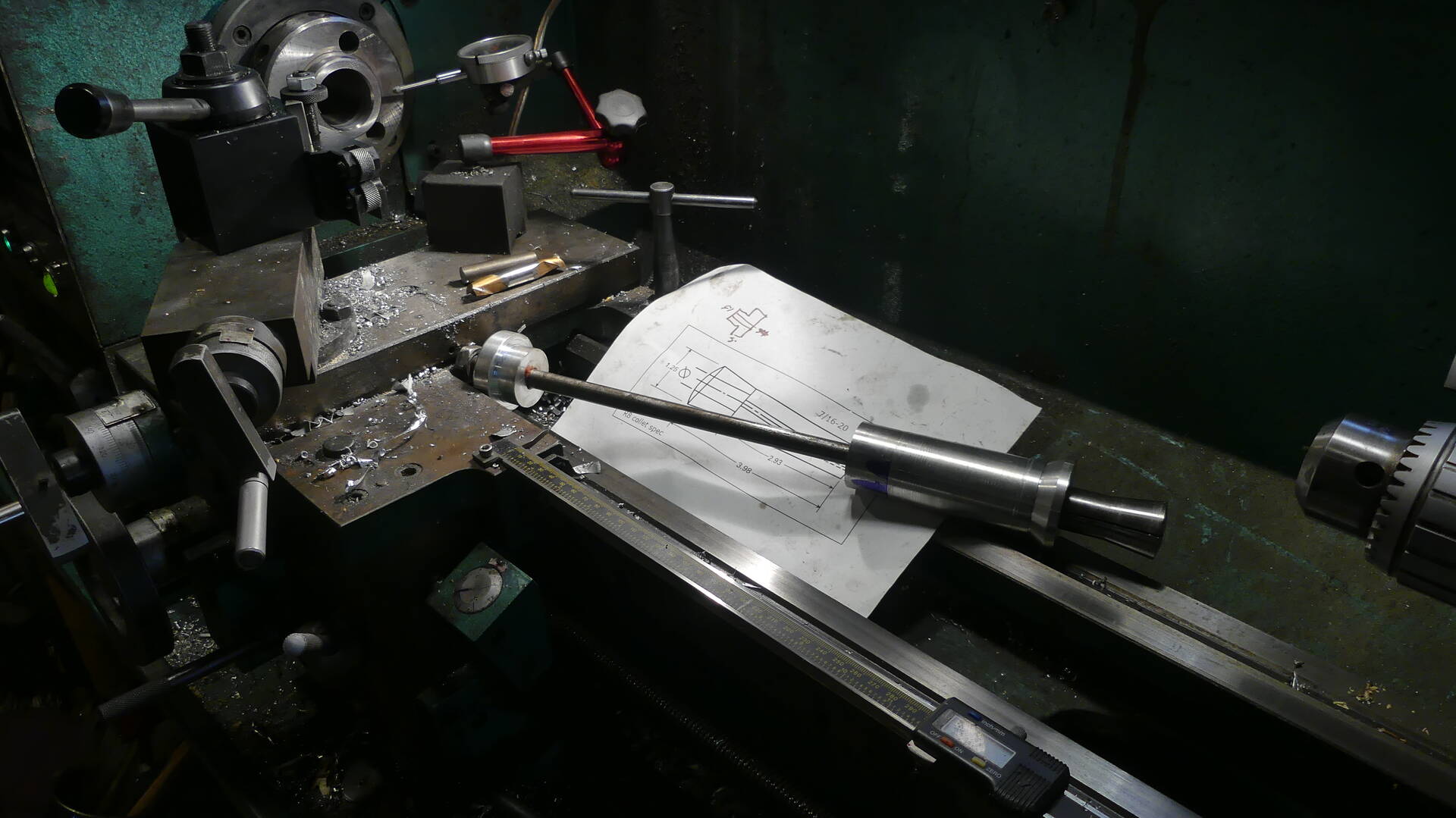

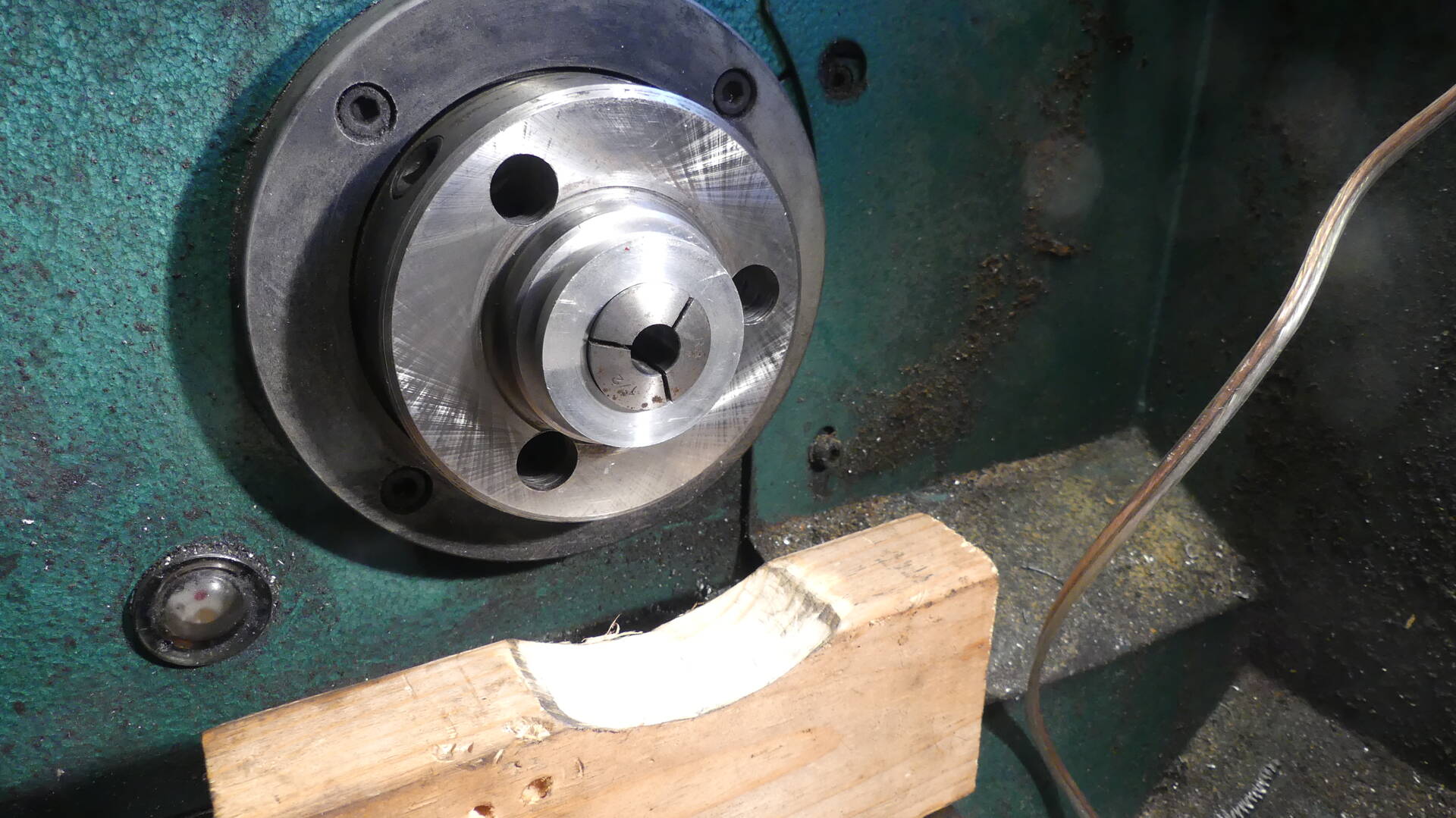

Now, would anyone in their right mind build an adapter so they could replace a camlock chuck with an R8 collet? Maybe I'm not the sharpest fork in the toaster, but I did, because I have them and it'd be a mere few hundred extra bucks to get some other type (C or ER) collets and ??? mounting system for this machine. The inside of the spindle starts at 1.725 and tapers. I cut the taper on the adapter a little faster so it can swivel ever so slightly, though it centers on a fast 60 deg taper at the front. This way, by moving the back end of the draw bolt (Which I'm still putting together, it's nicely threaded and I used thread wires for the first time) if I want, or centering it with a bushing on the back if I want. Because I can, I don't have an obvious use for that, but was off about a degree on that taper that I had no way to measure internally back in that deep. Bug == feature?
Haven't made the nut-bushing end yet.
Yes, I know the oil level is low - it leaks, slowly, and I put really thick stuff in there so the gears stay wet even so. It's a pain, I haven't found the leak yet, but the stuff does show up on the floor, eventually.
All done. Indicates around .0003" off center. Probably about the thickness of that spot of corrosion on the collet...perhaps just a kiss with steel wool in the right spot. It was all done in one chucking, so I know my adapter is concentric...maybe the spindle itself? I'll have to test!
Done for now.
Done for now.
I had to use a 1/2" milling bit to indicate, because no 1/2" steel stock I have is all that round. I could have (and eventually will) try with a 3/8", as I have a project involving that size of centerless ground O1 tool steel - that broach to make holes for screw-in panel mount BNC connectors. The one I made from hardware store steel worked fine for a few holes (my case harden was both thin and sloppy), but...I'm going to make a good one and by golly, solve that issue for good and all. The female BNC's I have in bulk are a not-quite 3/8" hole but with two flats ~ 5/16" apart to keep them from turning. Of course, they aren't exact size, so I'll mic 10 or so before finalizing the broach dimensions...

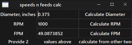

I did this on a lousy day after a tough last night - on a raspberry pi running "twister" which is a fancy respin of debian to support retro pi, dosbox and old time gaming kinds of stuff - which I have yet to use for that, but it looks cool and is generally smooth. I overclocked it to 2 ghz (with a cooling tower) and use it on low energy days...a lot of things don't need the monster I recently built, like developing this toy for machine shop use.
This just calculates speeds for me. Give it any two of diameter, feet/min, rpm, and it'll give you the third one.
http://www.coultersmithing.com/forums/v ... 7027#p7027
Looks like this:
I'm using a dark theme in twister, this just picks up the defaults.
