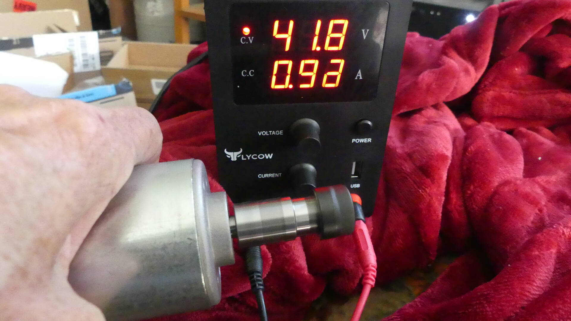

I got this instead, and yes, I looked inside. This time they got the heatsink grease right, or close enough. They still haven't learned to grease or silicone that temp sensing diode, but at least this one has fairly long leads isolating it from the PCB, unlike the other version (every time I get one of these, it's the same guts with a different brand on the outside).
"Flycow" is from http://www.nicepower.com Shenzhen Kuaiqu Electronic company. Nice build quality.
The spindle motor draws around one amp no load depending on volts. So the current limit might be handy now and then, though there's enough inertia to explode most carbide tools anyway.

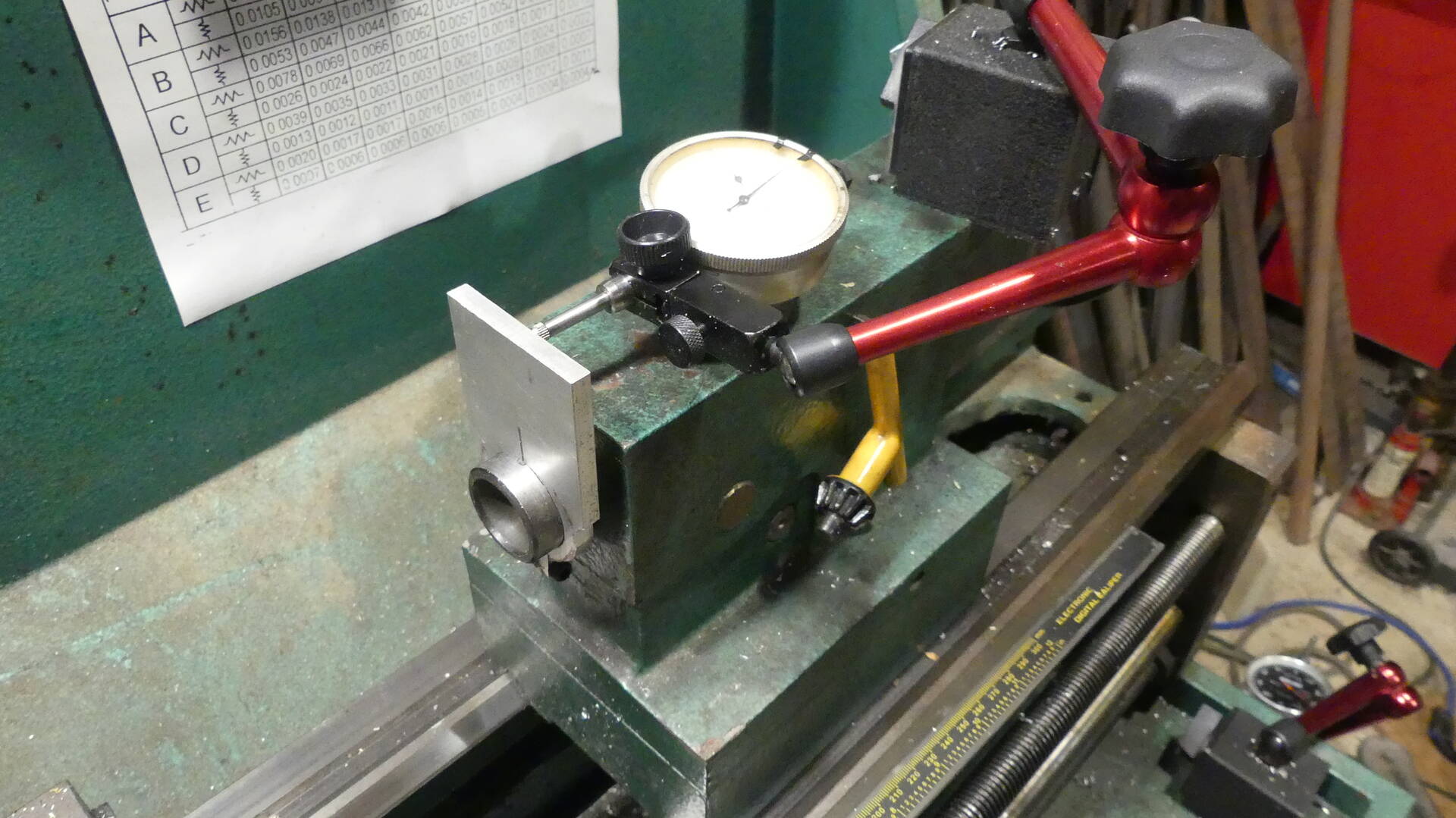

Speaking of readouts...I made a thing, most will know what the thing is from the pic. The pitch of my tail-stock is off by 1 mil or so per turn, and a couple mils to the wind drunk as well. Of course, there's the usual 10+ mil backlash, but we all know how to handle that by feel and forethought.
