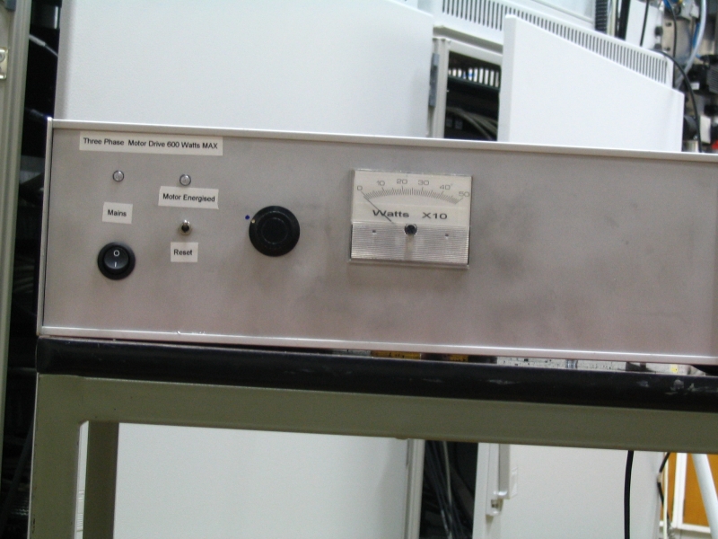

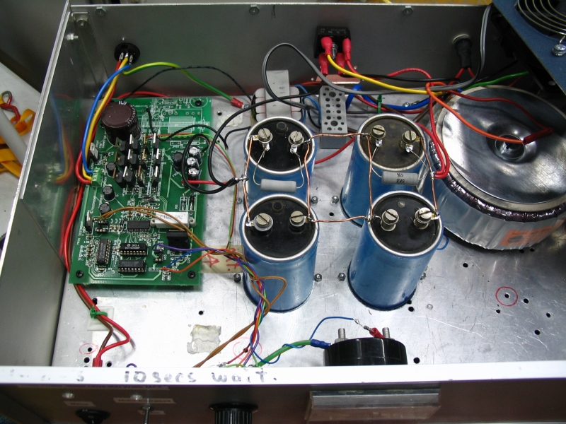

To save having to have a 1:1 isolation transformer made with 200kV plus isolation (read very very expensive) I decided to make an isolated motor alternator system out of two Fisher and Pykel washing machine motors. These units are direct drive in these washing machines and are good to about a kilowatt, unfortunately they are three phase so the motor is driven in Delta and the alternator is wired Star. We are only using one phase of the three for terminal power. We need a power supply at the terminal of 400 watts max. The workshop here beat me to finishing, they got the two motors mounted up coupled with a meter of polycarbonate tubeing for the isolation long before I finished the motor drive electronics.
And yes that is one of my turbo controller boards in there doing the business. Just bigger IGBTS in this case 15amp units @ 1200 volts. DC bus increased to 160volts, current trip set to 5 amps per phase
The electronics was run for a few days with the alternator loaded to 300watts. the motor alternator setup looks like this

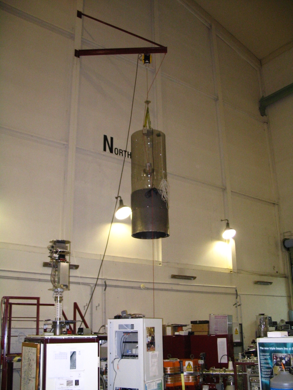

Now to get this arrangement on to the terminal we needed a crane to hoist the parrot cage off the terminal for service so a cherry picker was squeezed into the lab
so that a simple outrigger type crane could be installed

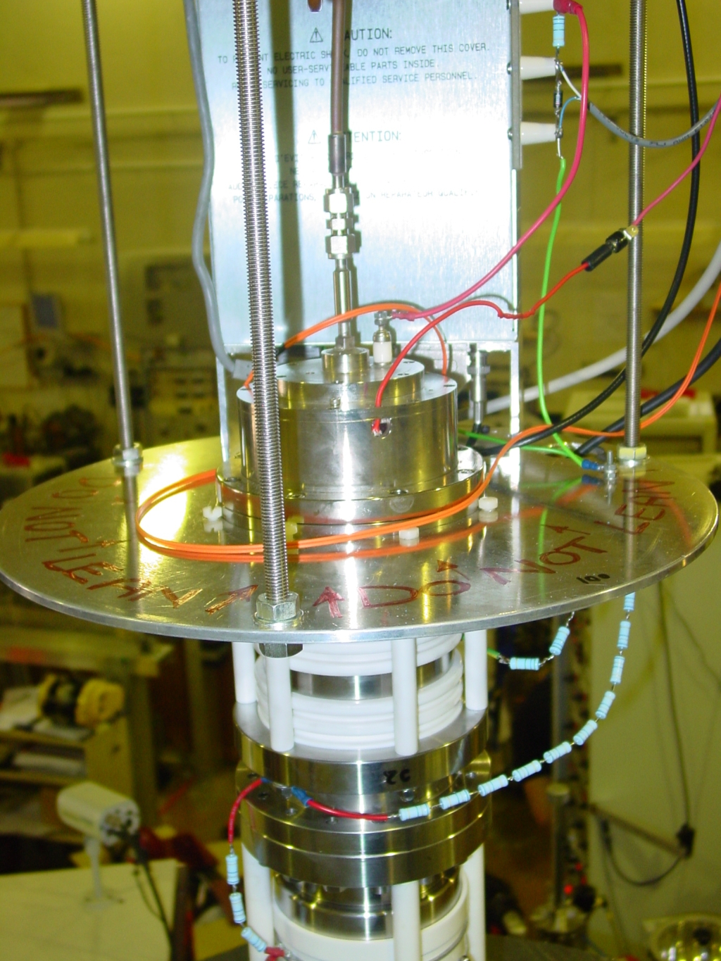

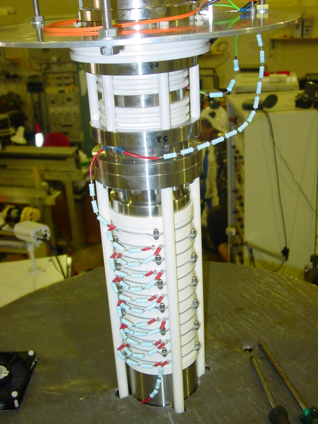

I then had to complete the terminal wiring by putting in all the resistors across the accelleration tube segments
Now moving up from the acelleration section

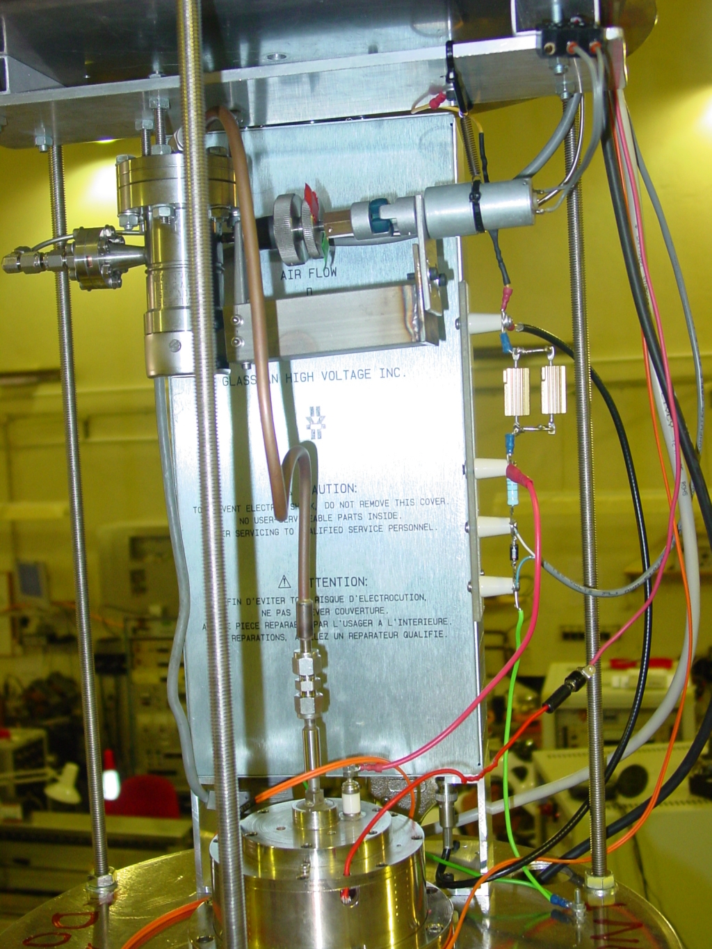

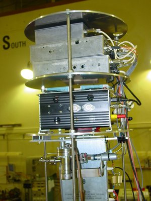

Heres a couple more pics working our way up the terminal this next one shows the ionsource and motorised leak valve

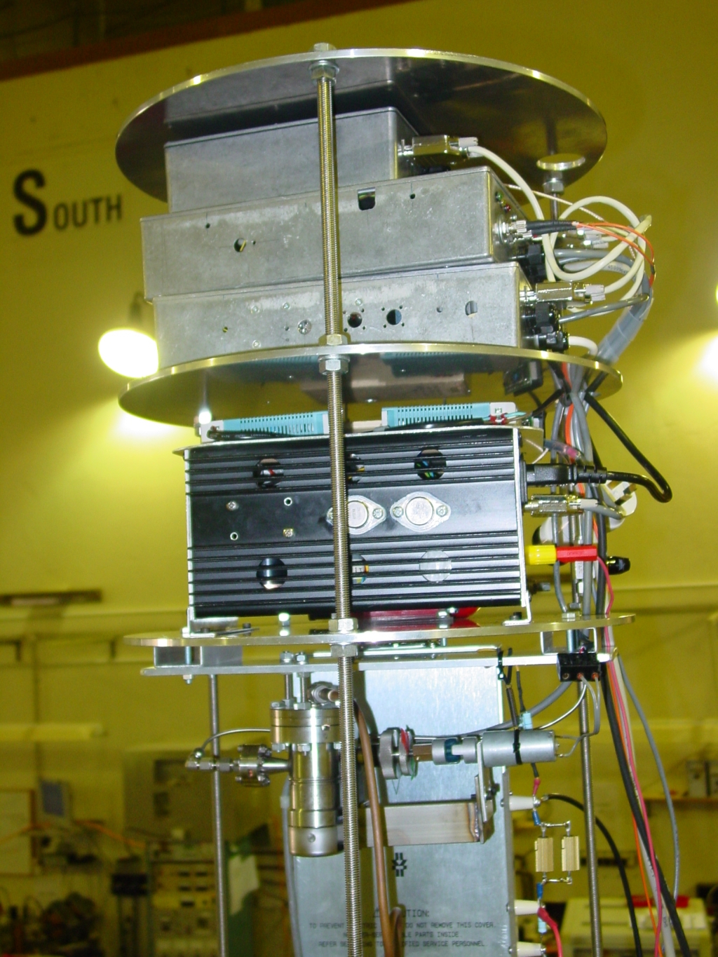

The next photo shows the electronics at the top of the terminal. Constant current supply for thr ionsource electromagnet, Glassman 0-5kV 0-100mA supply for the ion source and the einzel supply and montitoring electronics that is interfaced to fibreoptics to the control rack below.

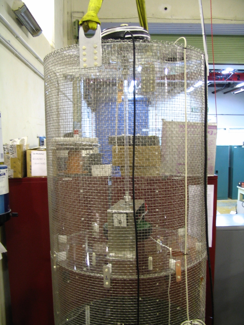

Now to use the new Crane to lift and place the parrotcage on the terminal. Note that the bottom section of the cage is covered in 0.125"thick lead so we dont x-ray ourselves while operating

By an overview perspective I take it you are refering to the motor alternator setup??
OK the Washing machine motors are from the top loader Fisher and Pykel smart drive type.
They use a direct drive permanent magnet motor to drive the agitator so in wash it goes one about a turn and a half before reversing direction. When in spin its winds up in one direction only to about a 1000rpm. The bowl is coupled by a sort of torque convertor so in spin the bowl spins as fast as the agitator. Neat motors about 14 poles.
Because they are permanent magnet they also make good alternators. Normally the motor is wired 3 phase Star to suit a DC bus voltage of rectified 230 volts ie 300 odd volts on the DC bus. As you have access to the motor windings its easy to disconnect the star connection and bring out all 6 wires so you can wire it anyway you like.
These washers are sold in big numbers in the USA not sure of the brand name --could be Whirlpool. They last about 8 years before the shaft seal lets water into the two shaft ball races which fail in short order after the greas is washed out so there should be dozens of these at the local scrap yard or appliance repair outfit.
lots of info here http://www.ecoinnovation.co.nz/ they also have an outlet in the USA
This is where I bought the two motors from for this project NZ$500
