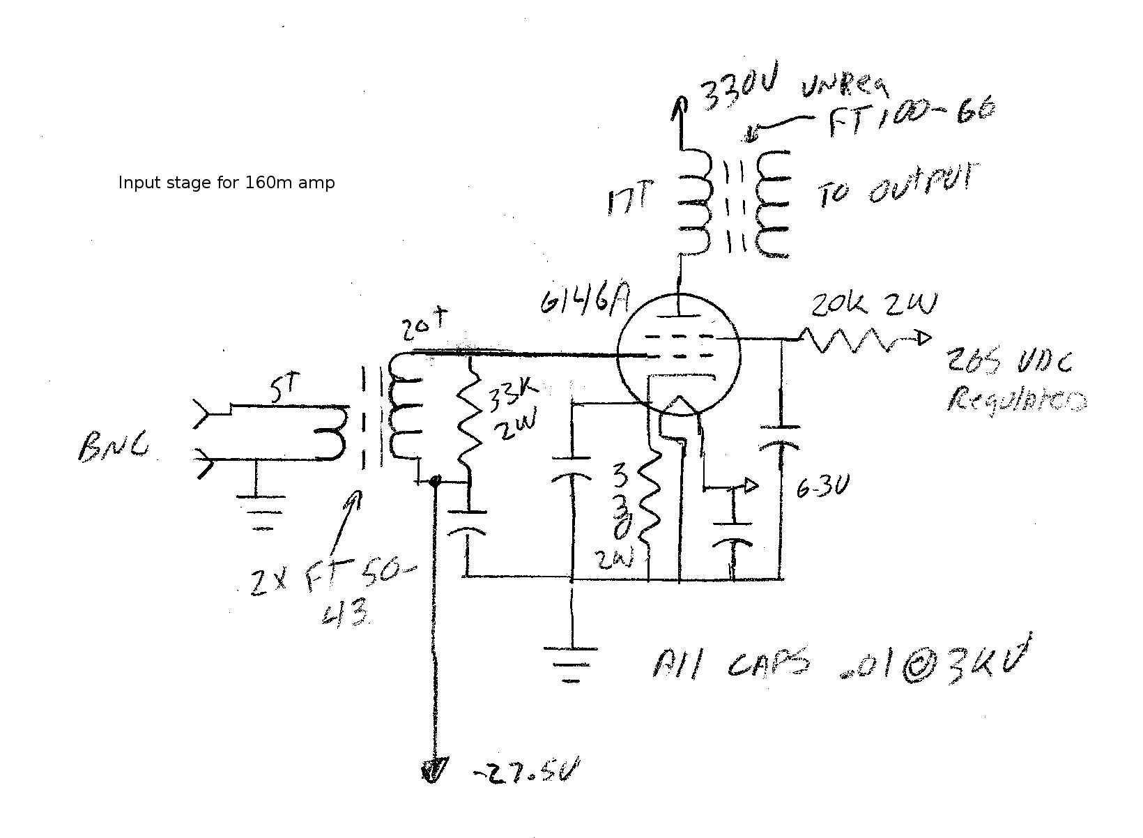

Here's the schiz for the driver stage. Those resistors were "there" and I left them since they seem to "do no evil". I added all those bypass caps. This is all under-chassis, to which I've added a 33 cfm fan, so that the air blows over the big filament transformers first, then exits past the 6146, where an above chassis fan takes over the cools the big tubes. I hope, anyway. Its big enough to move stuff around on my bench if placed so it blows downwards while I work on the chassis.
Hopefully close to final design
Sorry this is taking so long, I'm trying to be sure things are nearly nailed down first, and other things have been eating into my fun time. This seems pretty resilient, handles no-drive gracefully (around 30 ma plate current in that case), and well, the transformers I built do seem to do the right thing for the frequency range of interest. Nothing appears unstable at this point. The extra resistors seem to make it all a little bit "squishy" so it has kind of a sloppy form of ALC if you think of it that way. I'm trying to make it as idiot (me) resistant as I can here....and flipping the wrong switch or turning some control out of range is not too uncommon in the lab.

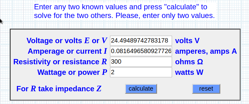

Very much a case of crossed fingers, yup. I based it on this handy webpage to avoid pencil-os or calculatoros. Shows 2w at around 40ma/grid, with more voltage drop than you'd get with 240 ohm per tube (which would effectively be 120 for two).
Web calculator for this junk
Yet another online calculator: http://www.sengpielaudio.com/calculator-ohm.htm
I might make a linux program to do this locally, it's kind of cool. Type in any two knowns and it figures out the rest.
It's in some nasty javascript, but I think I can figure out ohms law and P=IE in perl and GTK.

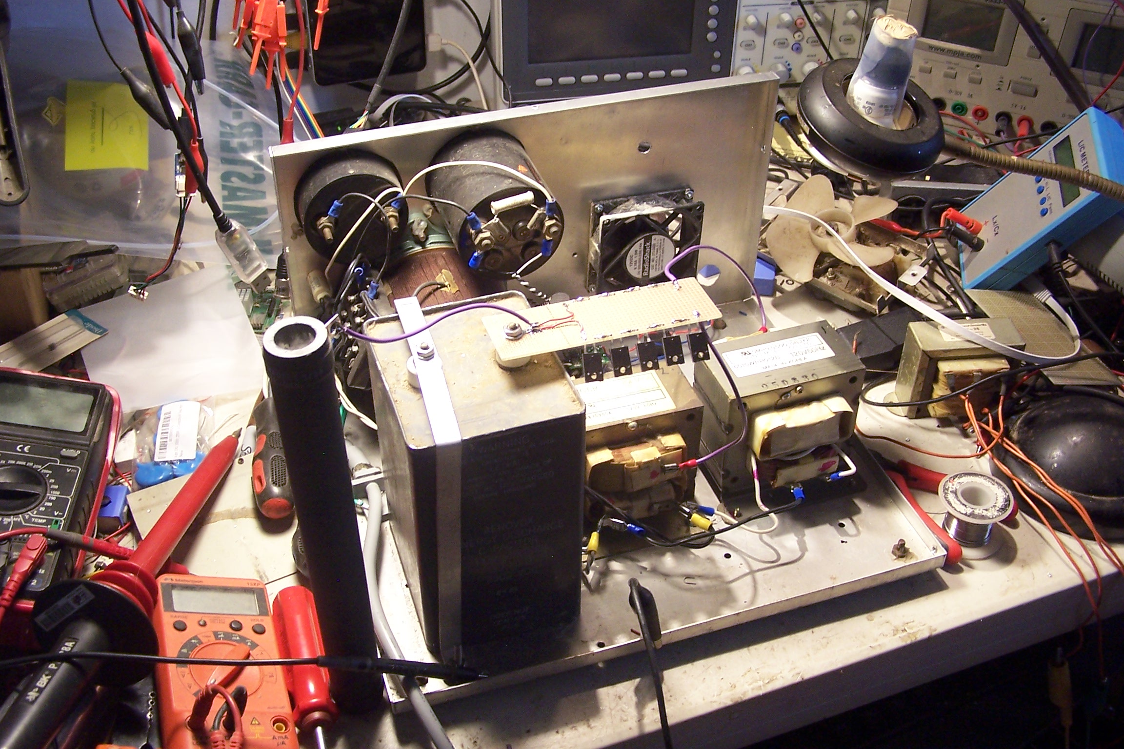

I just finished getting two MOT's to match to simulate a center tapped plate transformer. Not ideal, but...you work with what you have. Took 4 extra turns on the primary of one of them, now both will get me to 2300vdc under light load at 105v AC input before the core losses go up too badly. I also have a fat 28v center-tapped transformer I plan to use to buck the line down to 120-14 or 120-28, with a switch on that box's front panel. Right now all that is just a pile of not completely tested parts on the bench....I'm looking for a chassis to re purpose in my junkpile. I have some old 2500v, 20uf caps I got from Richard Hull, I think they were originally used for very large xenon tubes at airports...they make quite a bang when shorted out at full charge...One should be too much for this.
I do have meters on all this - they were in the original attempt at a 6 meter thing, and no way I'd remove them. They're recessed from the front panel as they float up at high voltages - it looks cool.
The plate supply will be where I can hit switches easily. The RF amp itself will be on the other side of the setup, so you'd have to reach over the ?? kv DC part to get to it...I plan to drive the thing from that old GR sig gen, which has way more output than needed, or the Feeltech generator, which does 25v peak to peak into 50 ohms (or nearly). With the transformer input I dodge the fact that the Chinese thingie puts out 15v DC at full snot while it boots internally...since the other amp was DC coupled that was a disaster in the making. The Chinese thing is USB programmable, clunky but it might come in handy.

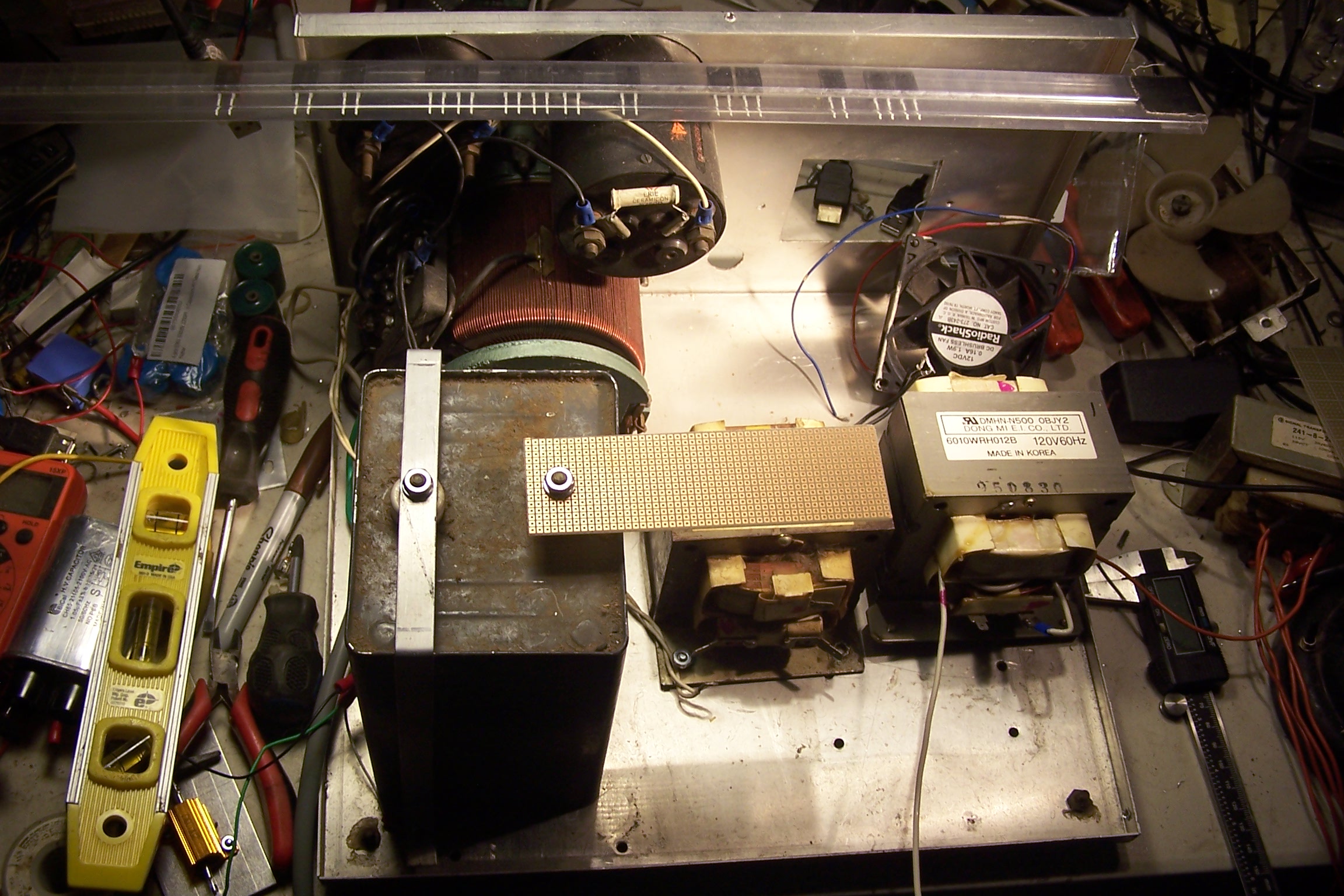

It's always slower than you wish it was. Are we there yet? BillF found us a power supply chassis from I'm guessing a hamfest. It appears to be a power conditioning unit (part of one) for gasoline generators - which is why the variac is there and one of those meters is for frequency. I may swap in a voltmeter there for output volts.
Mechanical mockup
Mechanical mockup
I've matched two 800w MOTs for effective turns ratio and will use them to simulate a center-tapped plate transformer with the CT grounded. Not idea, but I don't think I'll need anything like their full ratings. I've driven the magnetic shunts out. They "like" about 105v rms, past that they're in saturation at least at no load, and they make right around 2500v no load there. I figure it'll drop down somewhat with loading...there will be enough meters to see what's going on.
That big cap is an oil cap once used, I'm told, for huge xenon strobe lamps at airport runways. 30 uF at 2500v. A little scary. The perf board there will hold two 5 diode strings of 1.5kv 6 amp TV flyback diodes in TO-220 cases (shown in a tube balanced on the meters - I bought several tubes of things like this when it became evident there would be no more CRTs or support parts for them).
Not shown is a thumb sized little 12v switcher to run that fan, which will use an existing hole in the case, and a relay that will actuate the interlock on the amp chassis so that when this is off, that supply is also off other than filaments and fans.
I didn't really plan to need a variac, but since it's there, it should make testing at reduced power levels a lot easier, and maybe running that way. My guess is that this will all be more than enough, RF wise, and as I learn more, the most I might have to do is swap the various impedance matching and isolation transformers in the amplifier itself. Gee, maybe I should have built that for plug in coils like the old days!

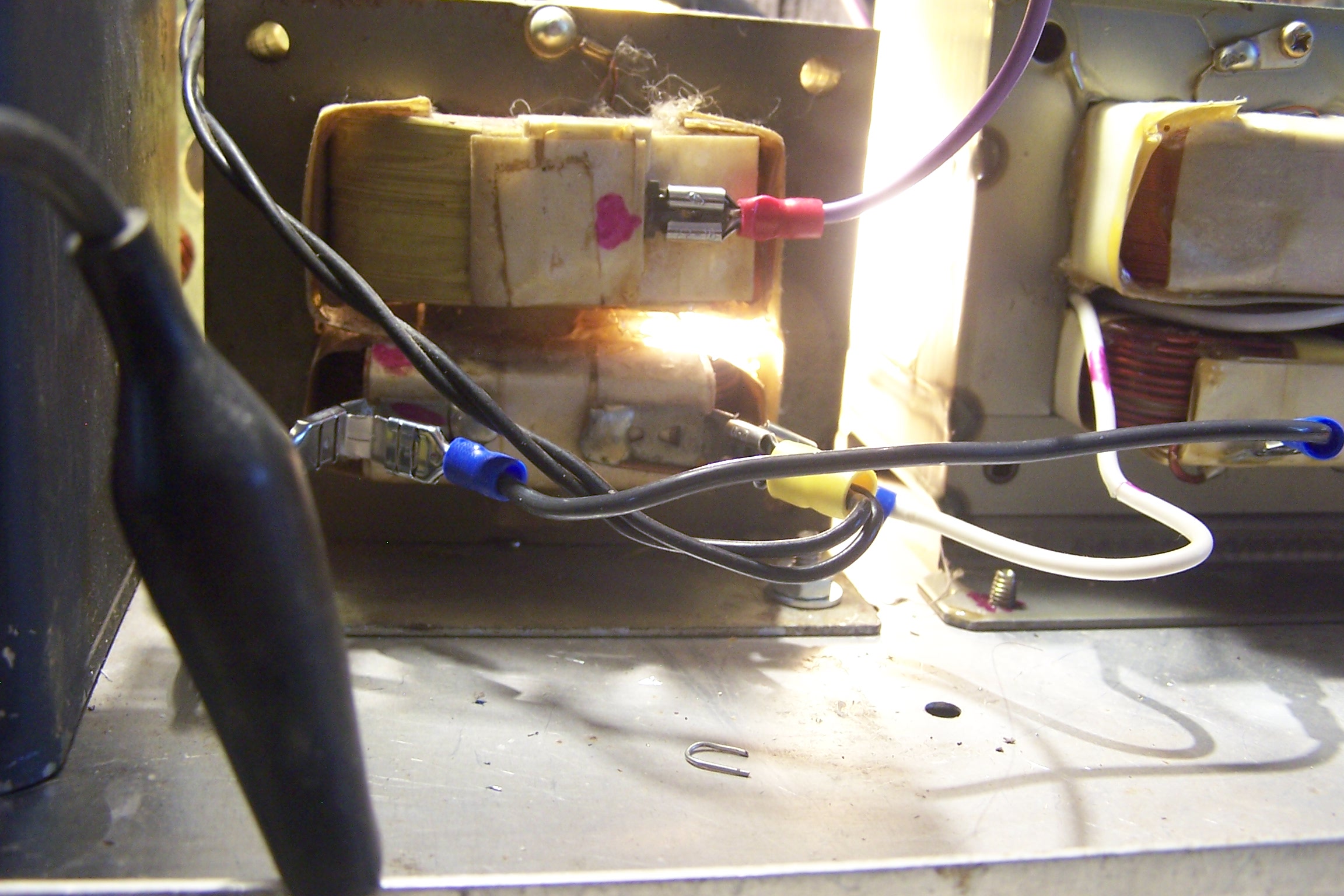

Here's a couple pix. the first one is just after the first smoke test - 2100vdc at 95v on the primaries. Had to quit because that dummy load R on the left there was getting toasty - it would have lived but the thing had proved its point. FWIW, I can't turn it on with the variac turned up. The peak current trips that weird switch+builtin breaker the original builder of this put in. Never seen one quite like that - it was some military special, but responds really fast (it's rated 12 amps!). No problem if I turn it on, then turn up the variac.
Smoke testing.  Looks like I hit 2200+v at top snot, more tests to come (where is the power going now?  I know the 50k load gets hot quick!) 2100 at 95v ac rms input
Light showing through where a shunt used to be.  The transormer on the right needed 3 more turns on the primary to have the same effective turns ratio under load.
These transformers were Korean, for what it's worth. I didn't pick them for country, I picked them as a nearly matching pair. Both pretty old (microwave ovens tend to be old when someone throws them away).

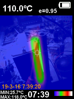

More to come of course, as I've not really beat on this enough, and haven't buttoned it up and arranged for connection to the amp, but here it is cooking the dummy load = a 50k ohm big power resistor. The light and IR images are offset in this inexpensive new IR cam, I'll live. (you can have pure one or the other as well).
Nothing gets hot but the load...At least not quickly.
In about 10 minutes one of the transformers had gained around 6 C, the core in this case - all windings, the diodes and capacitor stayed cool. \
This was at 2.2 kv output, roughly. Not sure I trust that HV probe to be on the button. At one point I had 3 different meters hooked up at the same time, and all diverged differently near the desired operating point of around 2.2kv (well, I think that's where this will be happiest, can't speak to the actual amplifier yet).
