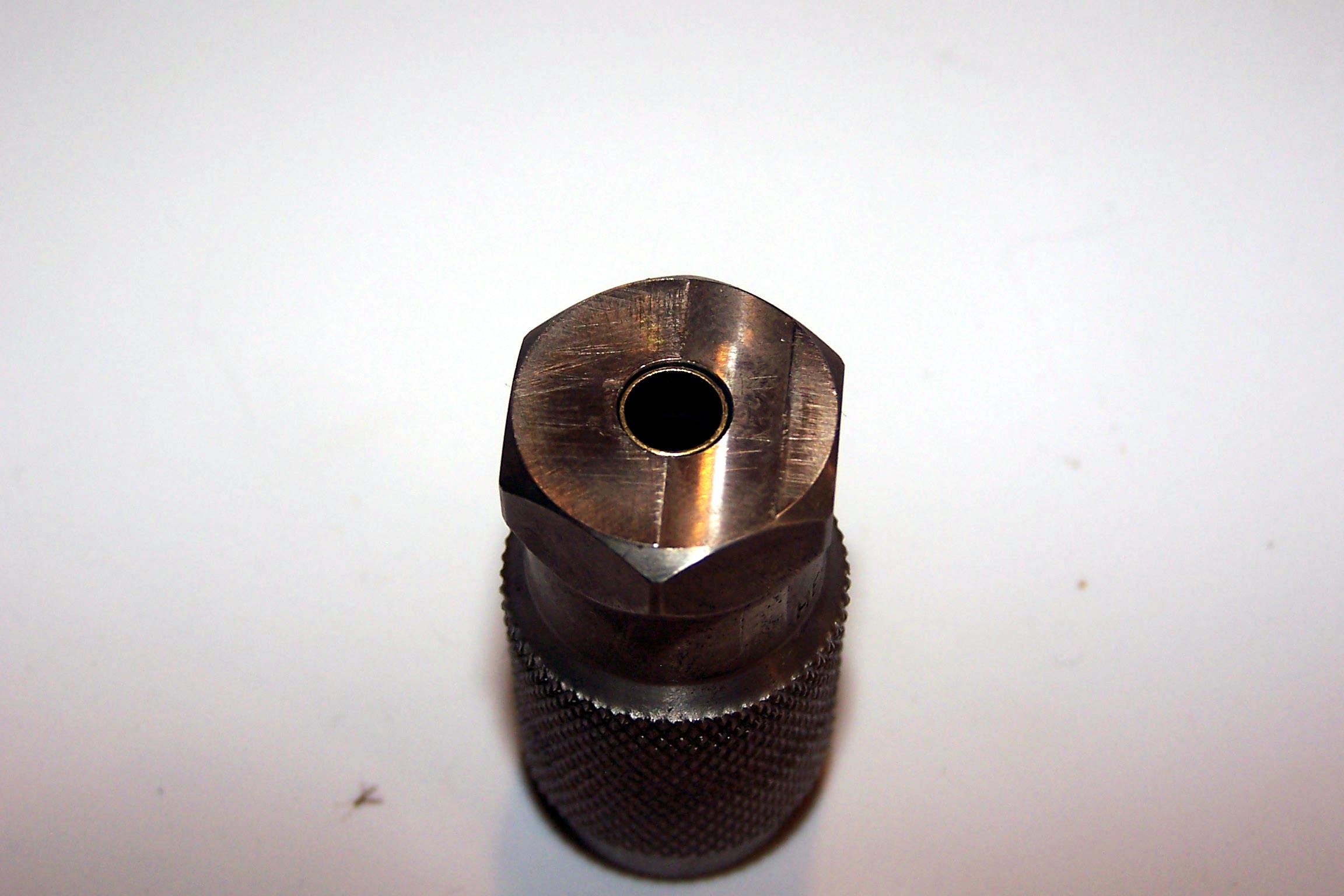

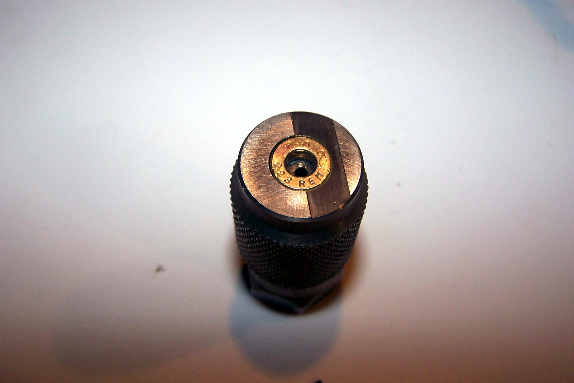

Here's another thing that is crucial to safe ammo reloading - neck length. Many just measure the overall case length, but that's the wrong way, as it's not really what matters. Rifle chambers are cut to accomdate a certain length neck, after which there's a sudden reduction in diameter to about the bullet size - usually 30 or more mils smaller. If you jam a case neck into this smaller diameter, the bullet will be pinched, hard. Sure, it'll come out of the rifle - maybe with part of the neck, but pressure will be high, accuracy totally shot, it might leave a piece of the neck in your gun for the next shot, which will either blow up or damage the barrel - it's not worth it to ever skip this step. Even though it's yet another tool, my preferred way is to use a case gauge.
A pro ammo maker I know, using all new components, does this as well - and she's had a block set up as a way to test multiple rounds at a time to save labor. I can settle for just doing one at a time. The case gauge also checks that you sized the case right from either end - so it's also a check on how well you set up your sizing die. Everything in a bottleneck rifle should be gauged off the shoulder of the case, since that's the reference point where the round seats in there. We'll talk more about headspace in a more specialized thread of course, but this is the safety part of it. Short version - too long, very bad - dangerous. Too short, bad because the brass WILL then stretch to the chamber/bolt length, and due to excess working and sizing, fail young.

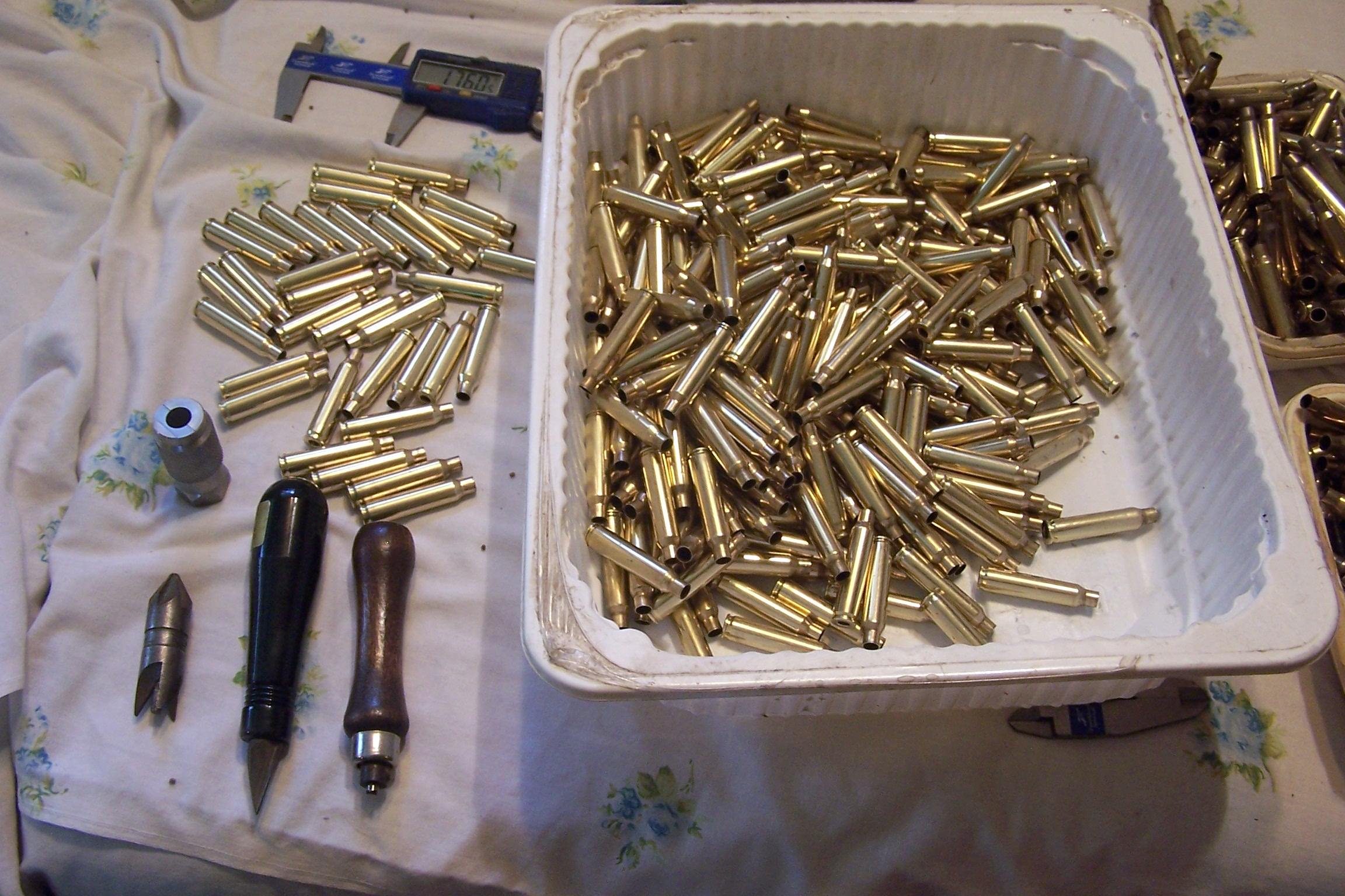

Showing the base of the case in the gauge. Showing a correct length neck. Showing a too-long neck. You'd normally trim this down, but for this, I just won't use these this time. Normally if I trim, I trim the entire lot for uniformity. But this is not for competition, this is just plain, reliable, safe ammo, and I don't need as much brass as I have for the weekend anyway. Note, out of all the culls, only one was truly a cull - it didn't fit the gauge easily - it had been bent, and had sprung back bent somewhat after sizing - those you just ditch. So, out of a couple hundred rounds (I wasn't anal enough to count them precisely) we've culled a few, and most of this last culling wasn't really required - we could have simply trimmed the too-long ones. And here's how the checking looks in action:
