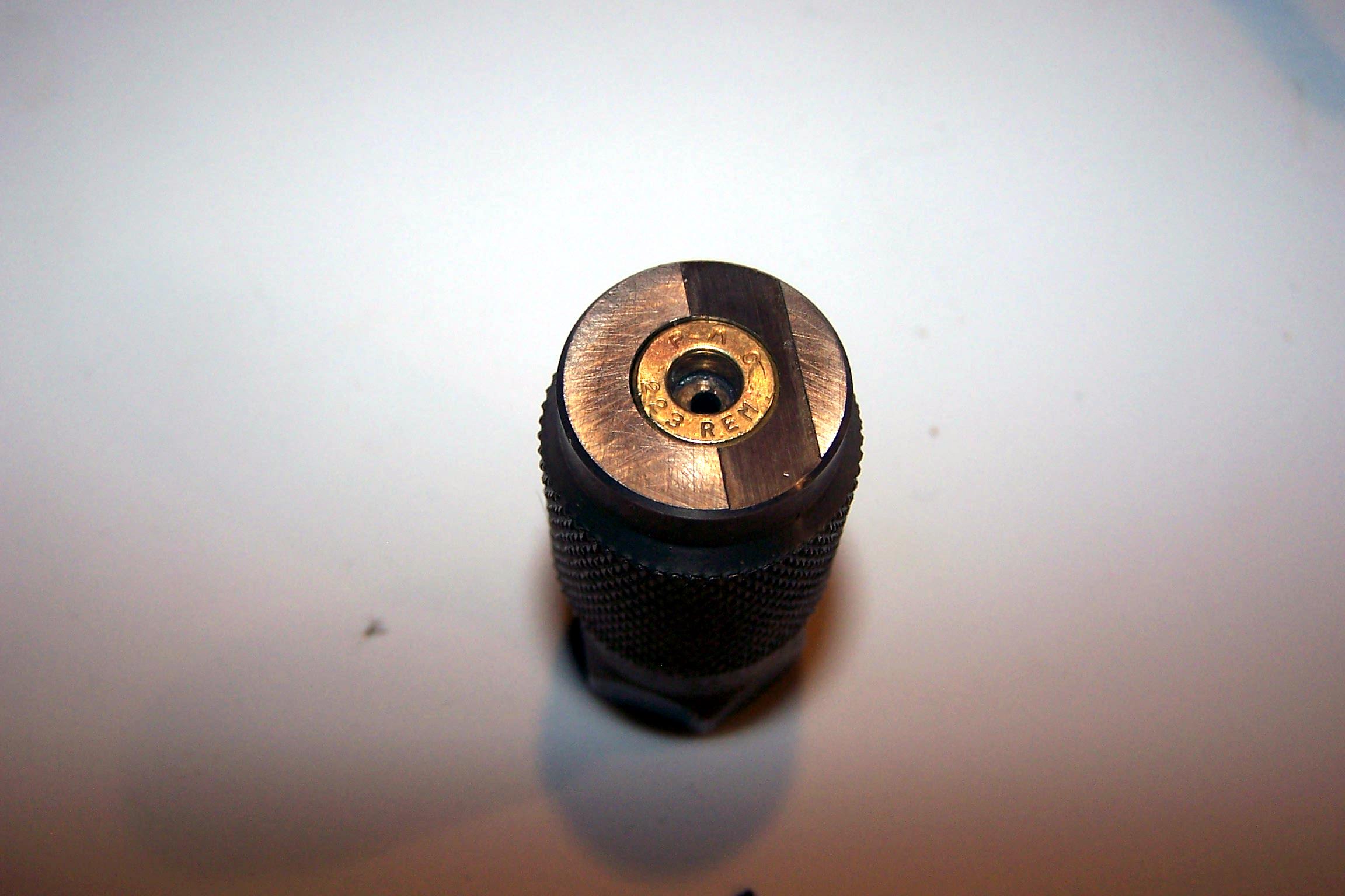

Showing the base of the case in the gauge.
Showing that I set up the die pretty well for overall length.

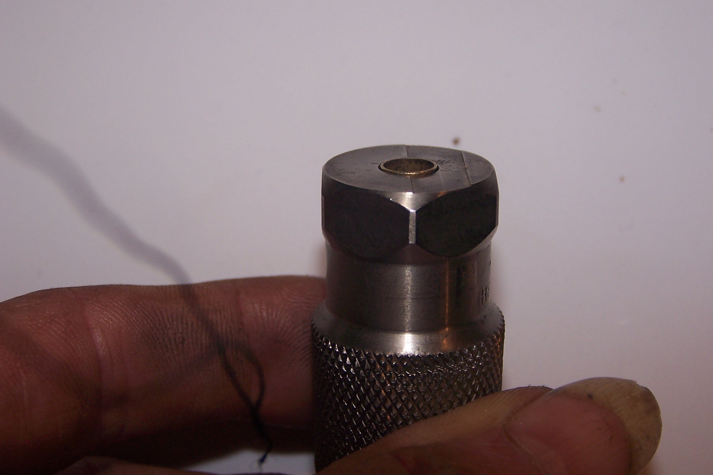

Showing a correct length neck.
Neck the right length, or a little short - OK.

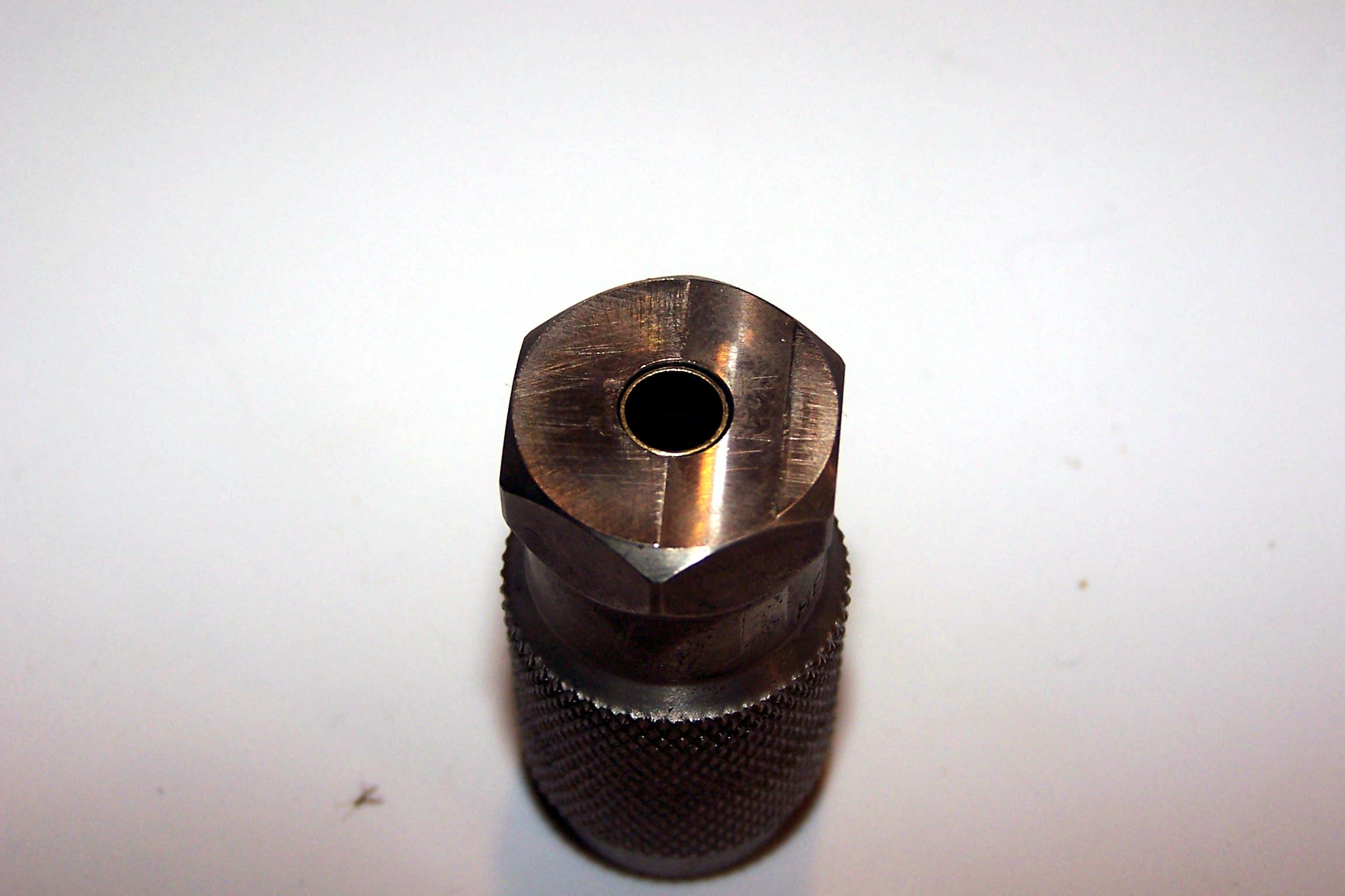

Showing a too-long neck. You'd normally trim this down, but for this, I just won't use these this time. Normally if I trim, I trim the entire lot for uniformity. But this is not for competition, this is just plain, reliable, safe ammo, and I don't need as much brass as I have for the weekend anyway. Note, out of all the culls, only one was truly a cull - it didn't fit the gauge easily - it had been bent, and had sprung back bent somewhat after sizing - those you just ditch.
Neck too long - don't use without trimming!

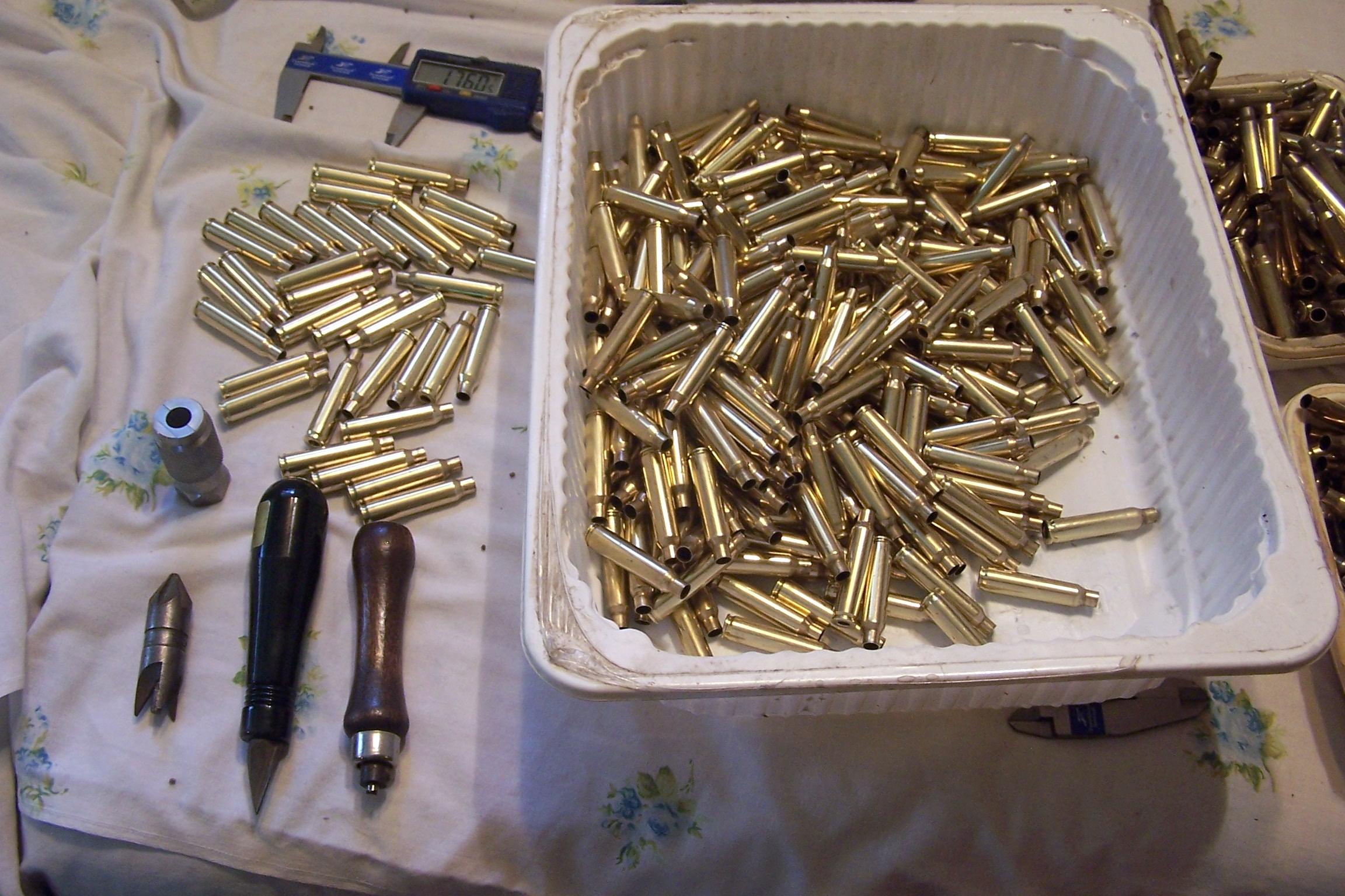

So, out of a couple hundred rounds (I wasn't anal enough to count them precisely) we've culled a few, and most of this last culling wasn't really required - we could have simply trimmed the too-long ones.
Final result of all this checking, along with a couple special tools just for fun (we'll show them later as well, in use)

You will need a set of good calipers for other things whether you have this case gauge or not. Pro Tip - get them at midway, since they are less expensive and just as good there. We've seen harbor freight ones not be accurate, and the super good ones from the machine shop supply are just too darned expensive. In fact, the same model midway sells goes for about twice as much at a machine supply place, and the really good ones are astronomically priced. Another Pro Tip - take out the batteries when not in use. These darn things have a "soft on" and they have a nasty tendency to turn themselves on in the middle of the night and eat batteries. Yet another pro tip, buy your batteries, in particular the L-44's these use, and the Cr2032 types the red-dot sights use, in bulk at either DigiKey, or McMaster car and save way over half the money over the retail stores. They really get ya on onesies prices retail.
