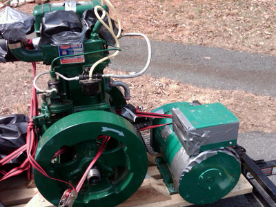

by Bill Fain
Hi, Found the elusive 8-1 Listeroid (GM-90) and matching Indian 7.5kw synchronous generator. These are new old stock, never been run. I am now looking for baseplate metal and accessories (Radiator, pulley, belts etc.). May add a 24v alternator or generator (maybe for electric start); in case I want to be ready for a partial solar setup. -bill
