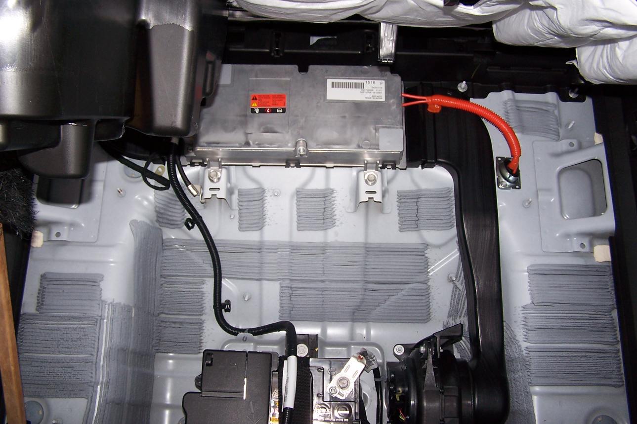

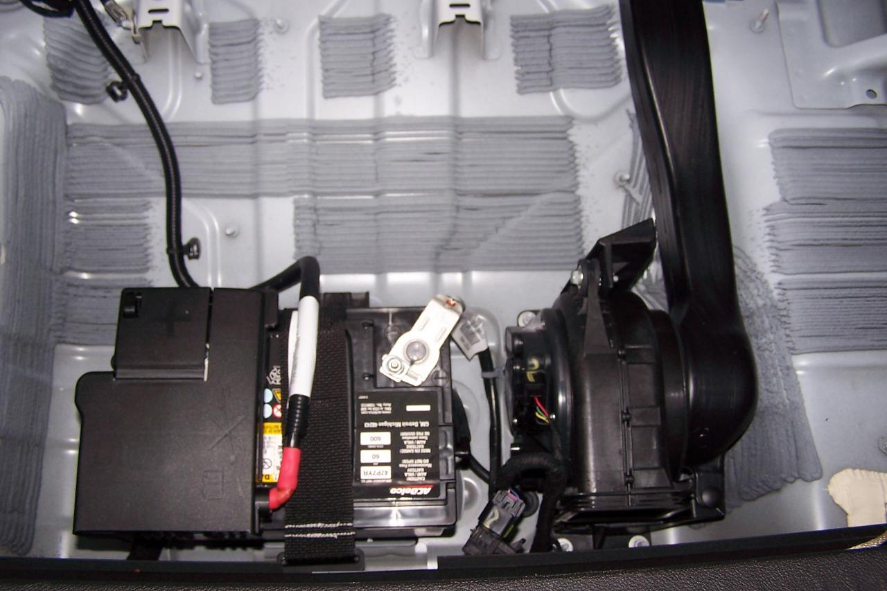

Re: GM's new Volt - the hidey hole
Ah, thanks to youtube and instructional videos for first responders, I've learned a few new things. You can get to the main 360v raw from the center console - the tray lifts out (no tools) and there it is if you're feeling suicidal. But the real key to hacking this thing is in the pix below of what's under the deck in the back (4 nuts to remove).
Took two pix, the one above holding the camera over my head didn't get the battery all the way, here's another:
According to the GM volt forums, this 12v battery and charger are the keys to the kingdom - all the control stuff runs off this. At the top is the huge switching supply that keeps it charged off the main traction 360v battery. It's rated at 175 amps output at 14.4 volts. So the 12v battery pictured is just a bypass capacitor for peak loads larger than that. If the car is "on" the IC engine will fire up if the main traction battery gets too low, and thus keep this charged forever. So, the upshot (according to GM) is that you can eat all the power you want off this 12v battery and not screw up the main monitoring systems and so forth - they had kilowatt stereos in mind, but...that's not the only possibility. I see Harbor Freight has a 1.2kw inverter for $109 that will fit nicely in there in front of the battery, nice short wires to it if I can figure out how to remote the power switch and outlets (oh wow, how will I ever manage that?
Since mountain mode will run the IC engine to keep that main battery at no less than half charge, we now have a way for this to backup my solar system for the house - just plug a plain jane charger in to an inverter here, which of course would not be the only possible use of such a thing. Now that's cool.
I see a rather large centrifugal fan there, pulling air through the switcher and then out over the battery - they thought ahead here, but not too much - else there wouldn't be as much spare space as there is, and there's plenty even when avoiding the dimples in the charger and tire compressor holder above this. The door over those is magnetically latched, shades of Apple (or my own house kitchen cabinets, years before Apple "thought of" that one). Obviously it will be pretty straight forward to install an inverter here and do a nice clean job. There are openable side panels in the fascia just above this I can install outlets from the inverter in as well, so as not to have to move any cargo and lift the door to use it for a real clean, useful installation here.
So, looks like what could have been a major hassle, isn't. I can tap this real easily, and I just happen to have a current-limited 800w ferroresonant battery charger I built for that little Honda generator that can work with this. It's wimpy, but enough in a pinch, which is the use case here. The Volt battery has about 16khw in it when full, about 8 when at "moutain mode engine cuton" level, and will discharge down to 3.2 kwh before the engine comes on again for a useful amount of power of 4.8 kwh - that'll be fine, that's more than I use normally in a day in the house anyway (unless long fusor runs are going on).
