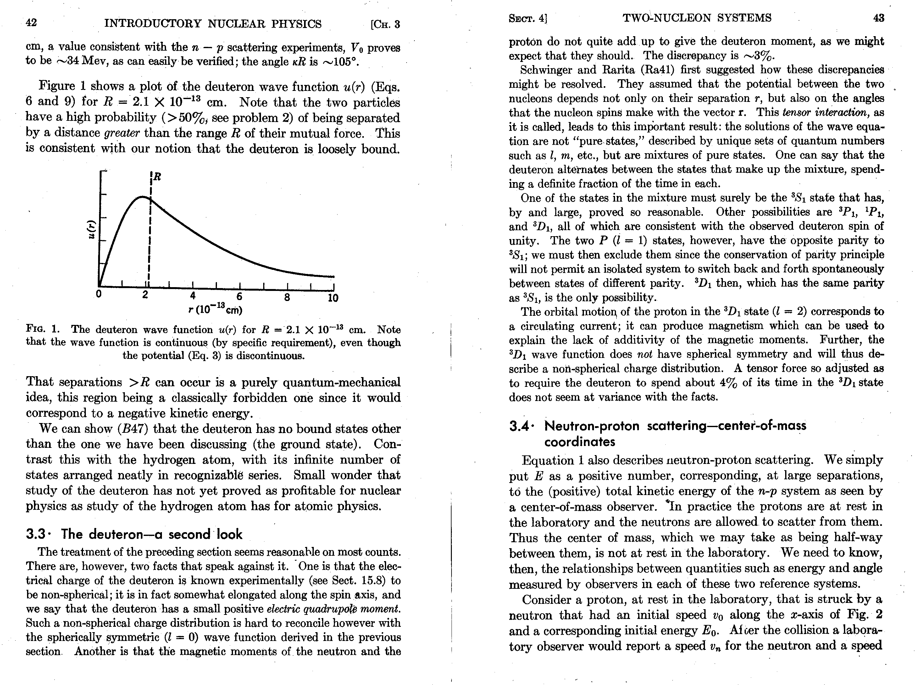

Re: Animations - a little backing from theory
Posted: Thu Apr 28, 2011 7:51 pm
by Doug Coulter
These scans more or less sum up most of what I know here (and some I have to admit I don't -- I'd mainly read the text and pix, and skimmed the math -- like playboy for physics). Somebody had to get us going with 42, and it shows up here more than once. As usual, click to expand so you can read these.
Note footnote under eq 42 - simplifying assumption that may not be realized in all cases (but assumed without saying elsewhere)
The previous page has "derived" the single body wave equation and "explained it". Well, for some people...By equation 42 we've got a simplified two body version that will be used to discuss the deuteron. He's assuming no rotation about the center of mass to simplify this -- it doesn't mean you can't have it, just makes the math messier.
Introducing parity and the deuteron -- makes the no CM rotation assumption
He brings up parity, which is conserved within a system. In other words, the parity of everything going in has to match the parity of everything going out. in the deuteron intro, the l=0 assumption is still there, and will remain through his treatment - almost.
Spin of a D, more math
He mentions that the spin of a D is 1, meaning that both the proton and neutron are polarized the same way. Now we're on to something, as the He we want to wind up with can't have two identical particles with all the same quantum numbers -- one of the entering D's would have to be polarized the opposite way or Pauli's exclusion principle makes this not possible.
Yes, page 42 alright. Shows that maybe a D looks a little more like a barbell with some bar between the nucleons -- they spend some time fairly far apart on the scale of strong force (whatever that is). Then he mentions that you can't really assume fully spin about CM is zero, as that doesn't agree with experiment, and says it's a mixture of states, at least some.
So, I didn't pull this out of my undies, quite. Without saying anything about the implications for our reaction, Halliday seems to be saying the same thing I've been saying (not a coincidence).
Now, an He has spin 0, I'd suppose (the type we're talking about here, that word is all too much overloaded in different contexts), and i don't have a clue about parity for He -- but to get from DD to He, we'd have to conserve that obviously. As well as any other selection type laws.
Wavefunction of a deuteron and removal of some simplifications
And that's what I'm getting at here. There would be slightly different sets of selection rules for the other two pathways, that would have to be satisfied for them as well.
Now, whether it gets us to gain > 1 fusion or not -- the ability to control which of several pathways a nuclear reaction takes is something quite unheard of - and very much not covered in the original work of decades past (or now that I know of), but here's how you'd do it -- by controlling the states of the inputs. Probably not quite Nobel prize turf - but on the same planet for sure.
I can think of a few places this might be handy to be able to do in other fields.
And it's all 42!
There's more stuff like this in the book, but it's a long book to scan in here (and probably not quite legal to do so). But in general this isn't a book much about either specifics, or particular reactions. He's giving the ground work, and the rest is "up to the student" -- which is us at this point. Not really bleeding edge at all, just something we need to work out with all the rules known pretty well (by someone, not me yet), for the case at hand. Or so I think at the moment.
Although I've not yet done back of envelope math on the actual spin rates (for the spin around CM, not the quantum type of an individual hadron) -- it's darn fast even at l=1, in the 1020 kinds of speeds I think. That's one heck of a lot of rotations of a thrown knife between the hand and the target to have it land point first....if indeed that's what you'd want.
Wiki stinks just like all the textbooks on this. You go to standard model, and immediately the math is super hard. So you go to say, SU groups, which again introduces super hard math that assumes you are already a god-like mathematician, and down you recurse, seemingly forever -- and by the time you pop the stack, you've forgotten what it is you were trying to understand. It's as though someone was being deliberately obtuse - I've seen plenty of math explanations of stuff this hard that weren't so poorly done. Just not for this particular stuff. And all the books I have are just a copy-paste, as if their authors couldn't explain it themselves and were simply repeating a prior text. Which does make one wonder....or give one hope that no one really gets this anymore -- just the originator -- and we've got a shot at something no one else has even looked at with understanding or a goal in mind.
